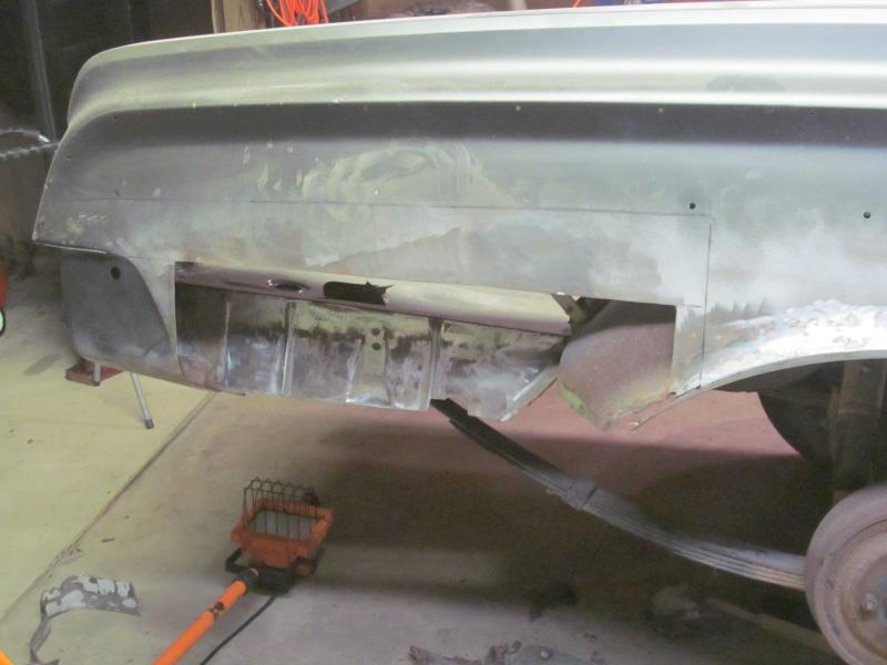

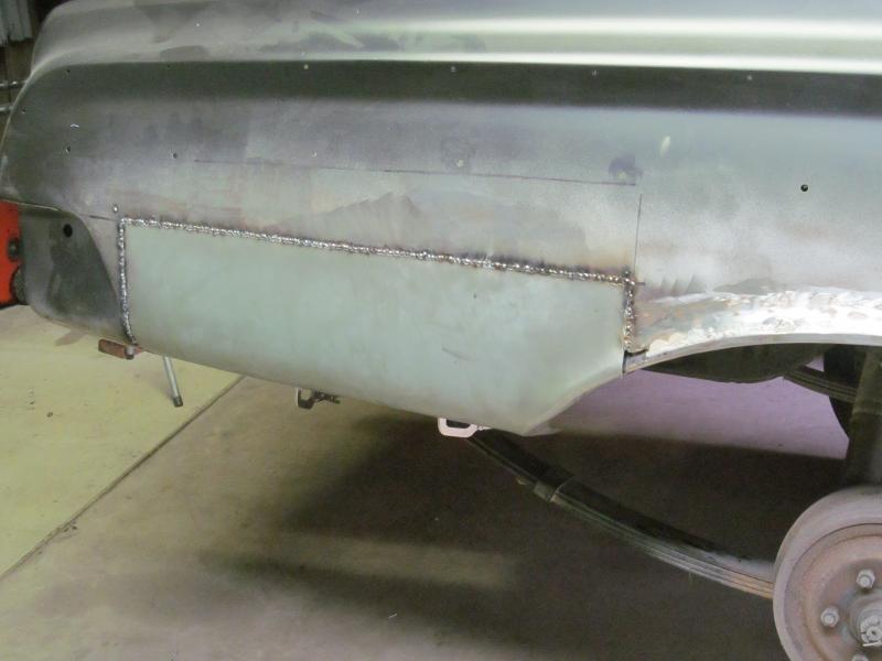

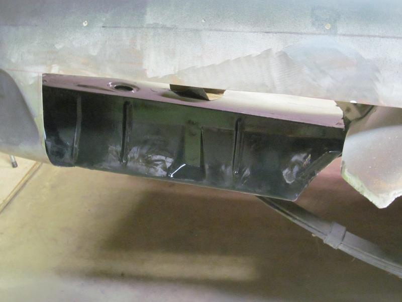

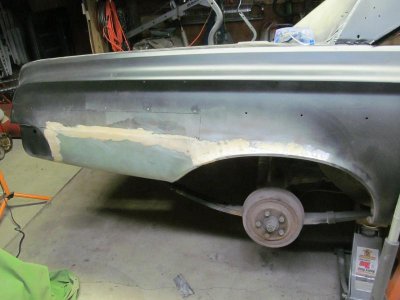

Just a little update about my car work. I had the body blasted and now the entire car is in DPLF90 primer. I bought lower quarter panel sections and have the passenger side already replaced and ready for primer. I had to recreate the vertical wall of the trunk that the quarter rolls under to meet. This was tricky since there were some structural features in it that I wanted to keep (for some crazy reason, since no one will ever see them again). So it took a while to make all those little bends in the sheet metal. But for not doing this kind of work before it looks pretty good. Once the filler is added and blocked it will be invisible. I will do the drivers side this week. Then the car goes to sleep for the winter since I have not heated my car barn yet. I go south in the winter now to enjoy some golf, fishing, and sunshine. I will post some photos a little later.

Photos as requested
Passenger side lower quarter repair

something tells me you've done this before......:icon_pray:
Actually I did...in 1967. I really have little to no body work experience, but some things seem to make sense and I seem to be able to do this fairly well. Thanks for the compliment.
