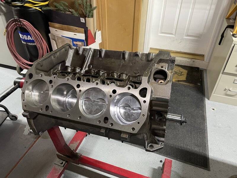

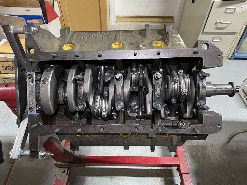

Wow, it’s been ages since I last posted but there’s been a lot of life changes in the past couple years. Regardless, there has been some progress on the Fury and I’ll start posting details again so here are a couple shots to show what I’ve been up to lately:
Yep, that’s a 440Source 512” rotating assembly in place!
Las Vegas Machine did the boring, honing (bores and crank), rebalanced the entire assembly, installed the expansion plugs, and verified all the clearances, then I put it all together this past weekend. Pargs include a 440Source Lightweight forged crank, 440Source forged H-Beam rods, Icon Pistons, Total Seal rings, and Clevite 77 bearings.

Nice to see you back at it. That 512 will work well, what heads are going on to it?
Nice to have you back at it Bob. Where do you have the car now?

I picked up a set of Edelbrock Victor Max Wedge heads and will be using them with a .0039-.0045 head gasket for around an 11:1 cr.
The ports are sizeable but with the cubic inch I’m running I think they’re a pretty good match (along with a stout set of gears out back, 3.90 or deeper).

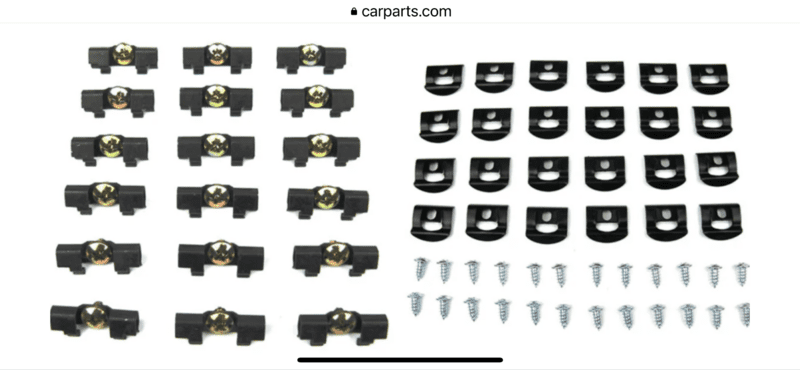

I’m getting ready to buy new front and rear glass, along with all new trim clios for both windows, but I’m seeing 2 kinds of clips, 1 is about 1”x1/2” and the other is about 1” square, so I’m wondering what the correct placement for each type is? I’ll grab a picture of what I’m talking about and post it shortly.
Any/all help appreciated!
Here’s a pix of the clips I’m talking about; I think the long/narrow are for the base and top of the window and the “square” are for the A-pillars, but I’m just not sure:

I run the same heads on my 505. My compression is 12.8 though. Have you got rockers yet? I did have to clearance the push rods along the intake port so you’ll likely run into that. The Super Victor intake works well with those heads, I’m running a 1050 Dominator with mine.

Since the Fury is destined to be a street car I just couldn’t see pushing the CR any higher than 11:1, which is right on the edge of compatible with the gas we have around here, but I got away with it on my Vette and figure I can pull it off here too.
No, I haven’t bought the rockers yet but I’d love to know what you’re running, and what offset they are.
Yea, I figured on having to clearance the pushrod holes but how much may depend on which rockers and offset.
As for an intake, I’m running the Edelbrock Pro-Flo 4 EFI setup (purchased a couple years ago); I had EFI on my Vette and loved it so having a self-learning EFI on the Fury is something I was really pushing for.
