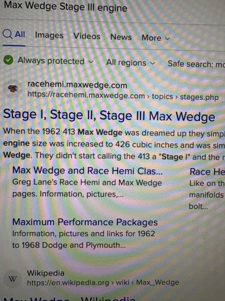

Well yeah,
I'm pretty certain these Wedge engines existed.

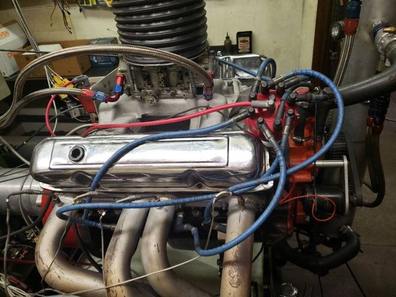

There were most certainly single four intakes with max wedge sized ports, designed for oval track (nascar) use. I have one....they were never on a production engine. They were sold over the counter at your chrysler dealership, as well as all others in the special parts program, at least until the gen2 hemi came out. I dont have a link, but i do remember seeing info regarding king richard and others running that intake in '64.

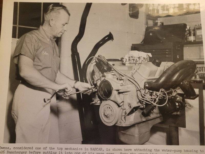

I'm sure there were 426 wedges in Nascar in 64, (and maybe USAC), probably run by privateers, low-buck teams, and short tracks. Probably leftover 63 engines
