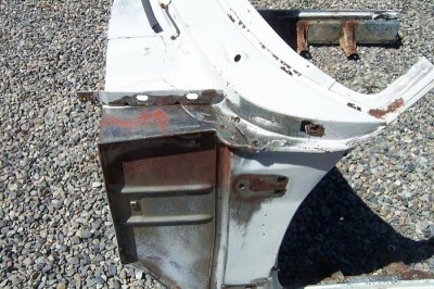

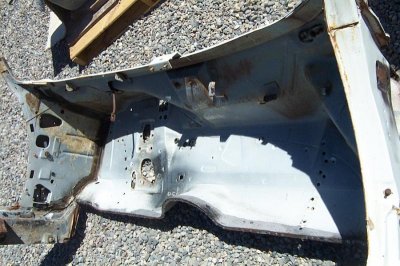

Mopar Mark,the 65 Belvedere must be a little different ,i wasnt sure, but this maybe info for anyone reading this thread and has a 1965
Nope, atleast not from the factory. Here is a 65 Belvedere. I've taken a few of these apart and all 62-5B are the same as far as design.

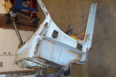

Do you see the dome to the left ,it has a little raised metal ,that is the drain.the 64 cowl dosent have it
Still don't see it. I sold this 65 unit last year and the white 64 this year so I can't just run out for a looksee. Also just sold my 65 Satellite. Do you have a pic of yours?
Ok I see now. That little knotch in the top plate. Very good to know. Many thanks. I never had these side by side.
So what did you learn today Mark? 64 and 65 cowl plates are different.
Glad you saw it Mark,i would like to own that 65 cowl.to bad you werent closer
