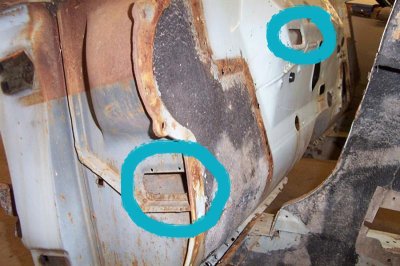

Cowl/firewall is a common rust problem on these. I'd atleast pull the pass fender and check the well drain behind it. If yours is a SW car then your probably good but a looksee can't hurt.
Heres a shot of the area in which I speak of.
Thanks guys ... interesting to see it with the inners removed. If I draw a straight line between the 2 clean outs it coincides with the visible rust area.
I've decided to attempt to tackle the repair myself. I have a cut off wheel, grinder and a welder ... what's the point of having them if they don't get used once in a while.

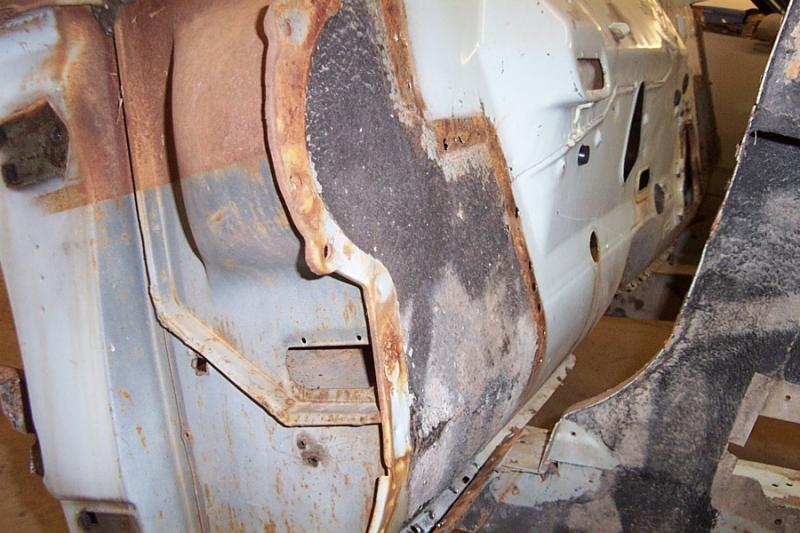

What rust are ya talking about? I dont see anything other than surface rust, got a better pic?
The picture was supplied by moparmark for reference. The area is not real big but it needs to be fixed.

Hopefully once I get in there the problem is not too serious.
