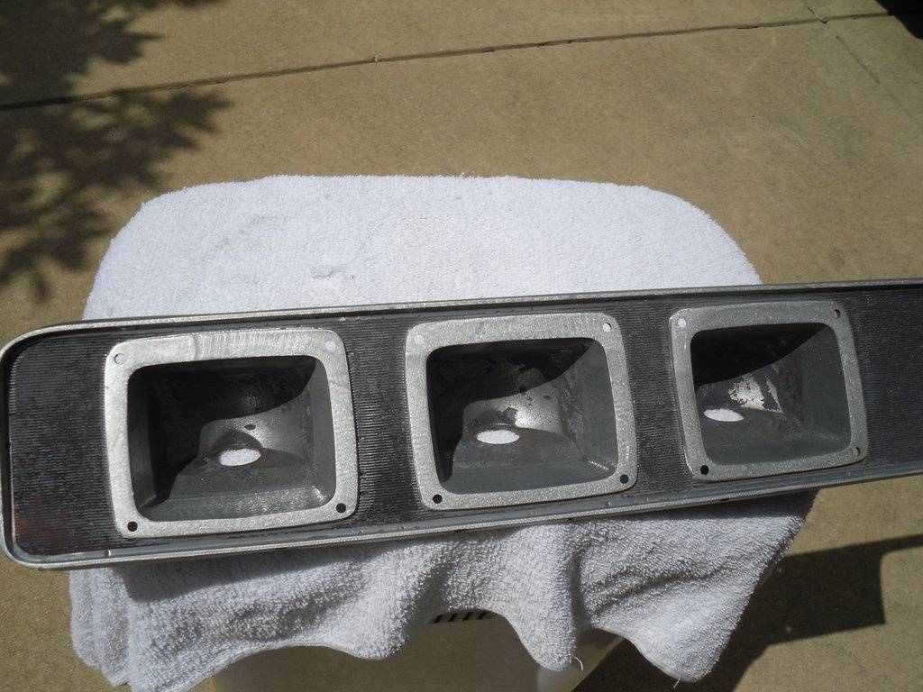

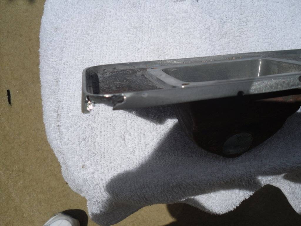

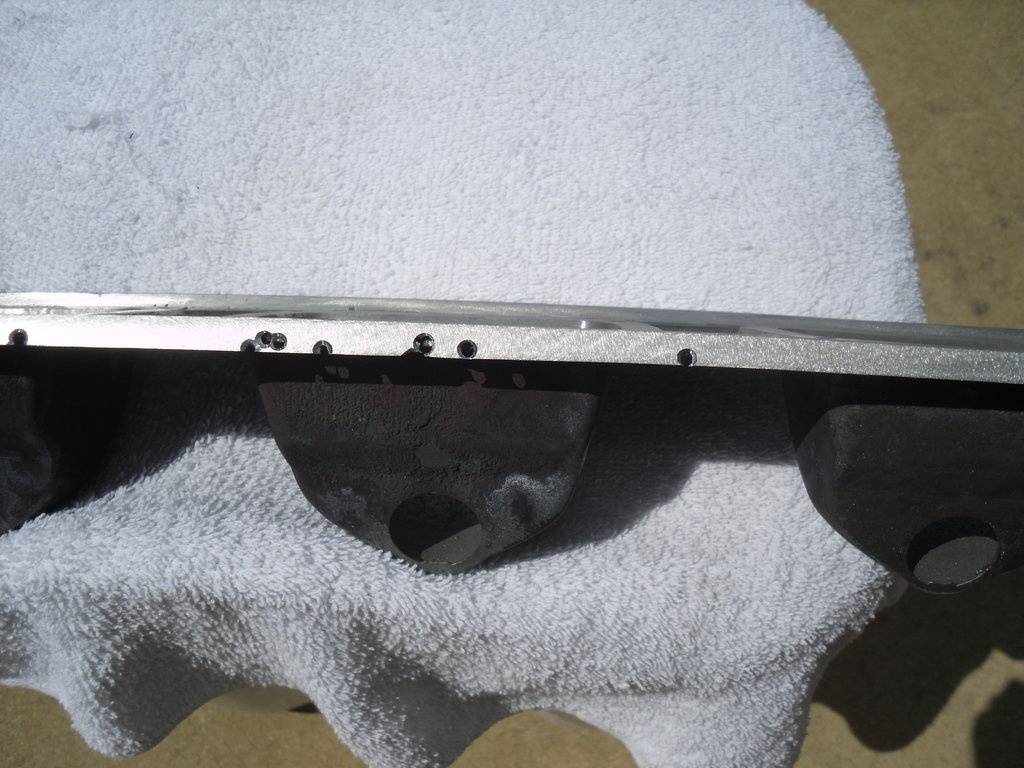

HELP ... Local Hillbilly Plater burned up my 64 Polara Tailite Cast Bases
NEED A GOOD Pair of Bases
Car is done Resto and ready to DRIVE !
Pretty common with Pot metal. get them copper dipped, solder up the missing areas. Re copper dip, sfile to shapee, dip, shape. That's why pot metal is so expensive to get done. A little pit always ends up as a hole.
