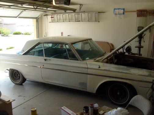

Project Polly has officially begun. She is a bone stock completely original 1964 Polara 2dr hdtp w/383, 727 pushbutton, factory A/C car that I picked up in Ca. last year. She even has 14" steel wheels, hubcaps and bias ply tires. Owned by the preverbial "little old lady" just north of Pasadena ...
My plans are to keep her as original as possible with white paint and the turquoise/blue interior. No performance engine work ... just a complete refresh of the internal components.
She is scheduled for a trip to the body doctor in 3 weeks to deal with some rust & dent issues and to get a fresh coat of paint.
Here she is ... more pictures to follow as progress is made!
Wish me luck!

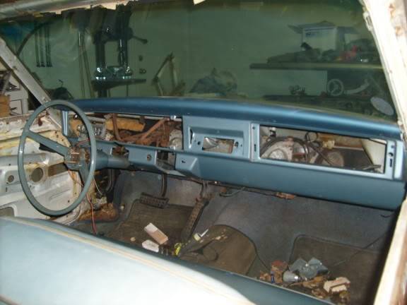

Got all the fluids drained, de-chromed her inside and out, tore apart most of the dash (thank goodness for zip lock bags) and now begins the greasy stuff.

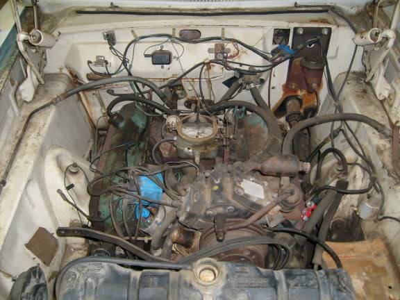

Admittedly it's been a long time since I was under a 64 B Body doing work. Either the components have gotten harder to get to or perhaps I got older and less flexible.

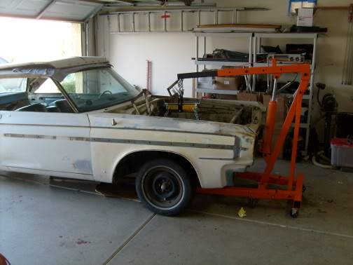

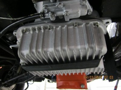

The engine/tranny are supposed to come out tomorrow if all goes well. While I was under the car I was looking at the trans cross member and it is bolted to the torsion bar member ... can I just unbolt it with out causing any issues?
P.S. After wresting with the shift and park cables in the push button tranny I will be switching to the Imperial Services conversion setup.

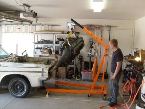

Undo the 4 bolts holding the crossmember and the trans will drop to the rear. I would only unbolt the crossmember when your ready to pull the eng/trans.
You need to support the trans before removing those 4 bolts.Are you taking the engine & trans together?
Yes ... I was primarily worried about any structural compromise of the torsion bar mounts while the center section of the cross member is removed.
Take a good look at the crossmember that holds the torsion bars to make certain there is no RUST! Which conversion are you thinking about?

Amazing how you can blow apart a car in a day or two and then take a year or longer to put it back together!
I took a good look at the crossmember and could see no obvious signs of rust. I also plan on putting the trans support back in once I get the engine and tranny is removed.

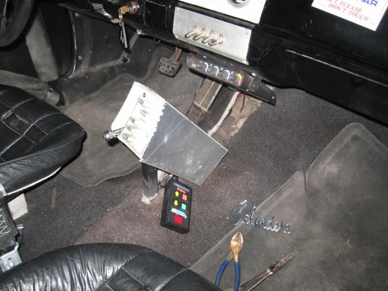

I am considering converting to a non-push button transmission but still keeping the push button shifter in the dash. Imperial has a setup that should work perfectly. I need to have a conversation with them first before I pull the trigger on this.

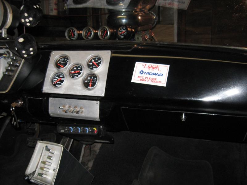

Jim,when you see the price of the conversion you just might change your mind on that one.I will never give up my pushbuttons!!!I've been told a 727 won't stand up to my HP levels,I betting it can:hello2:!!:hello2:

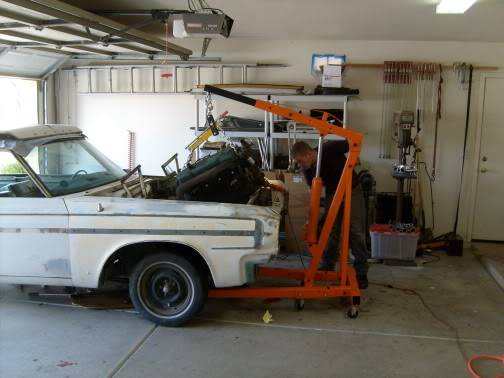

Saturday was a fun day!!!
Shade Tree mechanic safety first ...
Getting Closer !!!!
Future son-in-law (I hope) hard at work

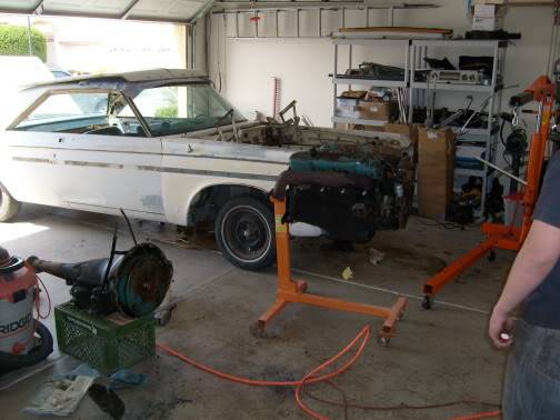

She's OUT!!!
Safely stored and ready for a tear down ...
