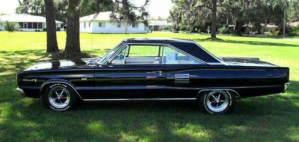

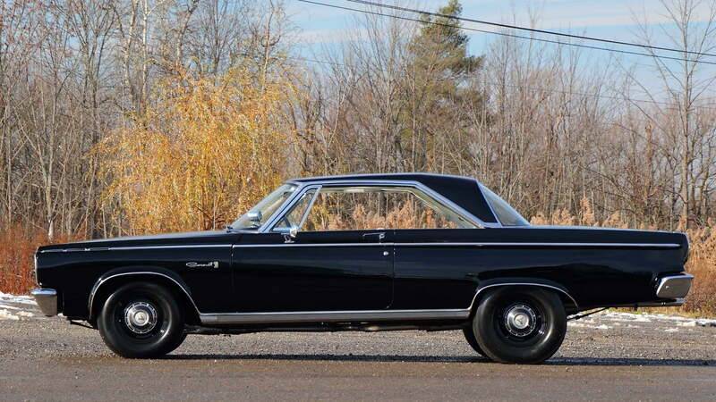

What's the big difference between a 65 b body and a 66 and up b body? I own a 65 coronet and everything I want to buy is always for 66 and up but never for 65 so what's the big difference and can I make most of the stuff fit and work properly?

The 66 cars had the motor moved back 2 inches with a different k member . In my 65 Coronet I wanted to use a 4 speed with my crate Hemi . Lakewood scatter shield shows one from 66 up so I got one and moved the motor back until the Z bar was level . Also used TTI headers that cleared everything .
The '65 & '66 have many differences and many common components. The '65 was a transition year, it has some parts that unique to '65 only.
Aside from the obvious sheet metal restyle, the biggest difference is in the engine compartment. The K frame was moved back and the engine compartment was widened to accept the street Hemi.
IIRC the '65 B leaf springs were unique. The '65 spring used a 21" front segment. I think the '64 & earlier used the 20" front segment and the '66 & later used a 22" front segment. I think the K member may also have been different than the earlier models and sure different than the '66 & later.

Difference is in the rockers, quarter glass section, roof and rear footwell pan.
