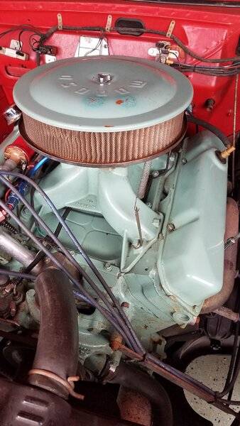

While I cant add any valuable input to this thread, I can say and show a pic of my 69 440 HP2 engine that was already installed in my '65 Coronet. Let me know if there are any pics you need to see to help you in your conversion. :thumbsup:

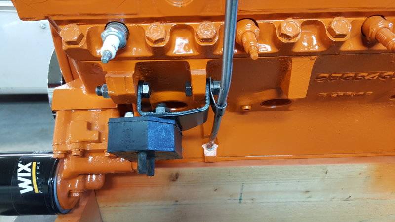

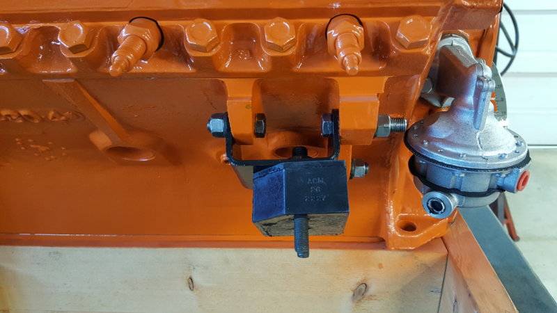

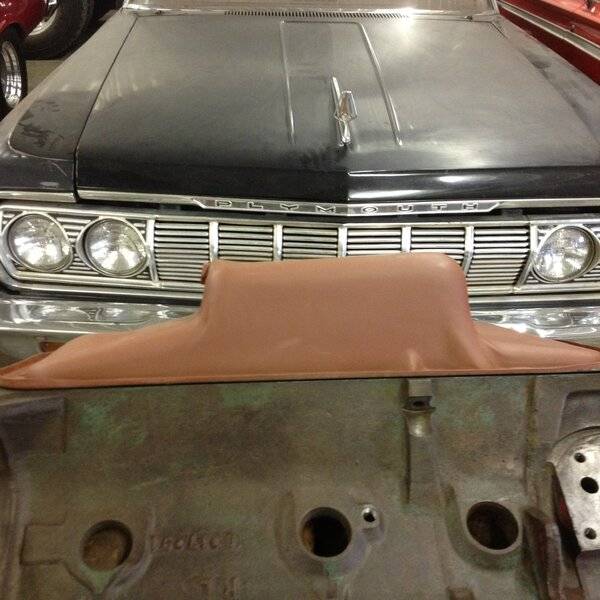

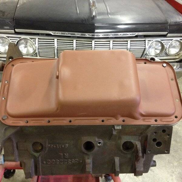

Pictures of the brackets and insulators that you need. Also pictures of an early B body oil pan.
GO69 spells it out pretty well. Mount pictures aren’t mine.

The engine oil pan is limited in style due to k member, so you'll need a 971 pan n pick up. I think mancini or 440 source has those.

The block casting is not a huge deal. You can make a later oil pan fit, you'd have to notch the K member for clearance. I'm not a fan of notching things, hence the oil pan info. The 971 pan fits perfect enough room all the way around, of course max wedge pan is better yet due to extra capacity.

Pictures of the brackets and insulators that you need. Also pictures of an early B body oil pan. View attachment 1000115 View attachment 1000116 View attachment 1000117 View attachment 1000118 GO69 spells it out pretty well. Mount pictures aren’t mine.
