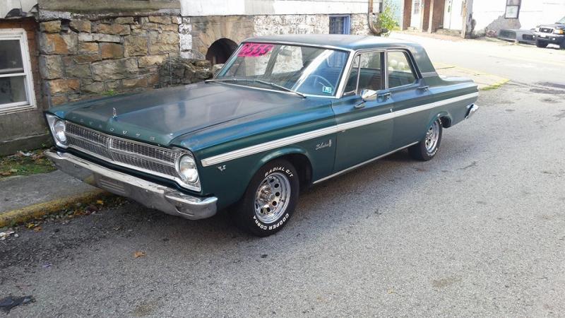

I am the proud owner of a 1965 Belvedere II which has been my daily driver for the last 6 months.
The car has been very reliable, but recently my 225 Slant 6 (automatic, not manual) died. 2 of the cylinders have almost no compression, but the rest of the engine should be pretty solid according to my very trusty mechanic. The engine still starts and runs, but stalls when the car is idling in drive, and it goes without saying that it really isn't running well.

My Plymouth: 10482326_10152572374093589_5647207464131571987_n.jpg

Is it just me, but do I see a V8 emblem, on your first picture of the 65' you posted ?
Yeah, I've been told that Ma Mopar put those on all the Belvedere II's that year as part of the fancy trim package, regardless of what was under the hood. Hard to find info to back that up though, idk.

...and no, they didn't put v8 emblems on slant six cars. pretty specific about emblem use.
In later years (67) Six got nothing, 273 2 barrel got v8, and the rest got the displacement.
On the hood ornament anyway.

The V8 badge in question is on the fender, not the hood, and it was there when I bought the car, I guess in the last 50 years someone swapped the fender. Car is a 65, btw.
