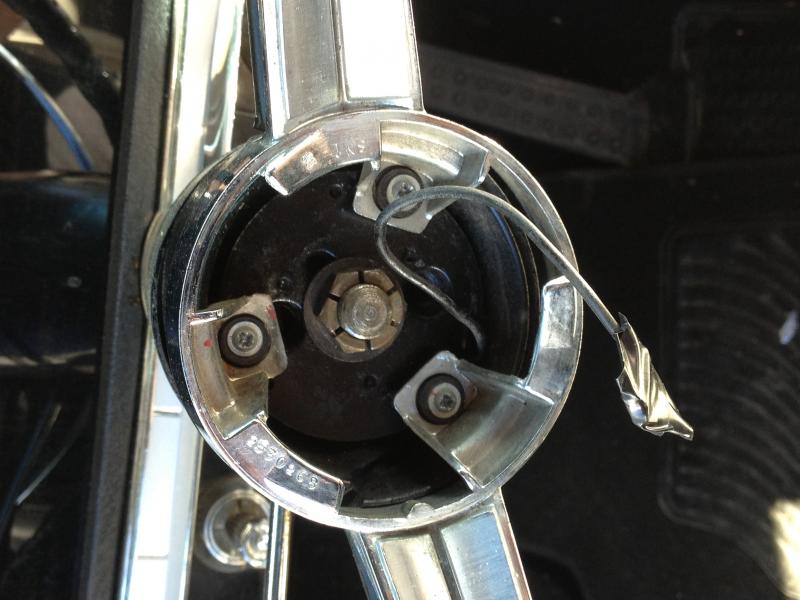

I've figured out that I do not have a standard '65 Coronet steering wheel. Or maybe just the horn ring.
The ring is stamped #2530268 and the centre button is #2513138. Internet search revealed that the ring is 65/66 Belvedere/Satellite/Polara and the button is 61-68 Dodge Truck.
It looks ok though, so I'd like to retain.
I have the wire hanging out the top of the column, the horn ring fixed with three insulators and the centre button which twists on. Nothing else.
Does anyone have a diagram of the horn parts on the steering wheel please? I know I need a contact ring (just got one on ebay which I hope will fit #2497588) but is there anything else I need?
I'm not sure how the contact ring fits either.
Advice much appreciated.

I haven't pulled the wheel but I can see that there's nothing under the horn ring.
The horn ring is fixed with three screws directly onto the column.
Any help with what I'm missing would be appreciated.

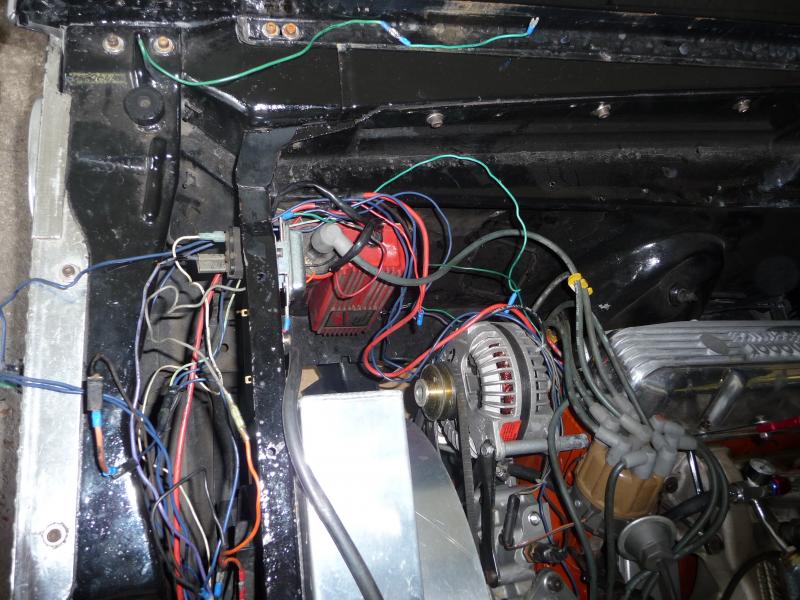

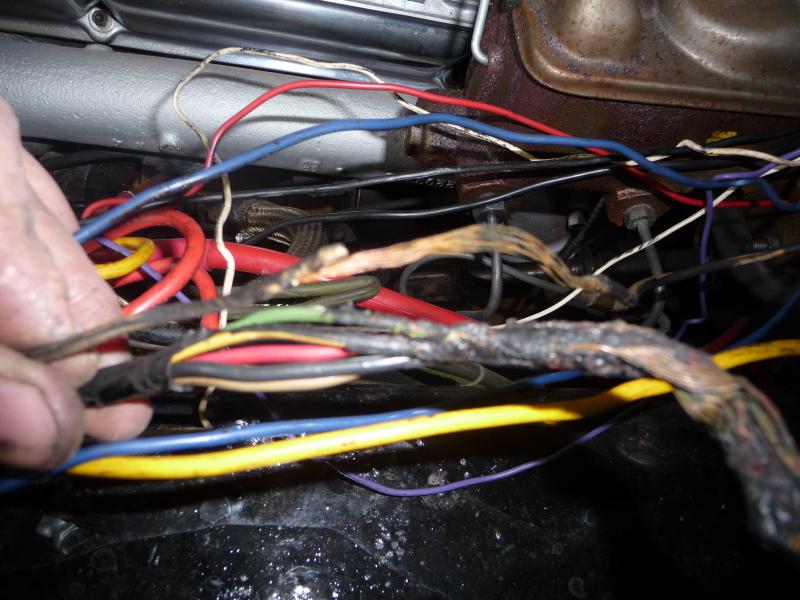

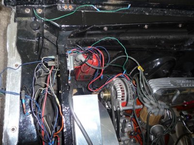

Quick update. I tried tracing the horn wire from the bulkhead. Years of "harness abuse" has taken it's toll.
Have a look at these pics. The lighting harness has fused together, there are connectors all over the place and I can't figure out how the MSD has been wired up. I'll have to do a drawing I think.
Does anyone know where I can get the original "type 56" male and female block terminal connectors? I'm going to restore the front harness.

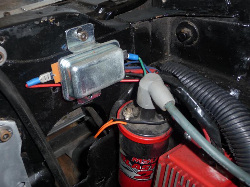

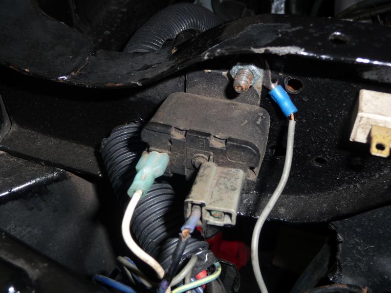

Also can anyone confirm that the silver box above the coil is a voltage regulator and that the other relay pictured is the horn relay?
There's a sticker on the alternator warning that an external regulator must be used, so I'm hoping it is an electronic regulator of some sort.
Cheers for now

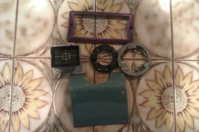

Hi mate,
sorry for the delay, I will give you a list of the parts you need, ok?
turn signal switch with horn contact that touches the horn ring:
http://www.danielsternlighting.com/products/products.html
horn switch and spacer screws:
http://www.ebay.com/itm/1964-Dodge-...Parts_Accessories&hash=item4d0dac6050&vxp=mtr
http://www.ebay.com/itm/NOS-MOPAR-1...Parts_Accessories&hash=item35c8ccc1dc&vxp=mtr
horn contact ring:
http://www.ebay.com/itm/NOS-MOPAR-1...Parts_Accessories&hash=item35c8d592ce&vxp=mtr

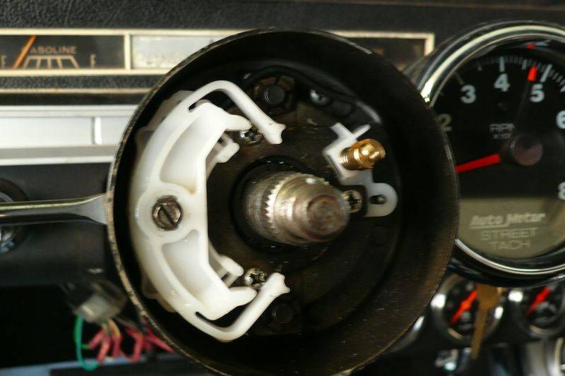

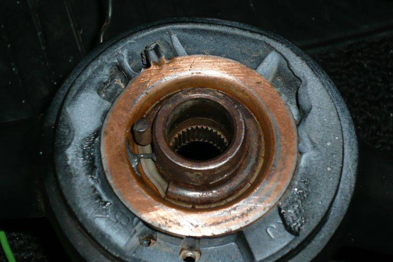

This is the horn ring upside down, what you see is the contact ring:
And here is a look into my steering column,the new switch:
Give me a shout if you need more help.
