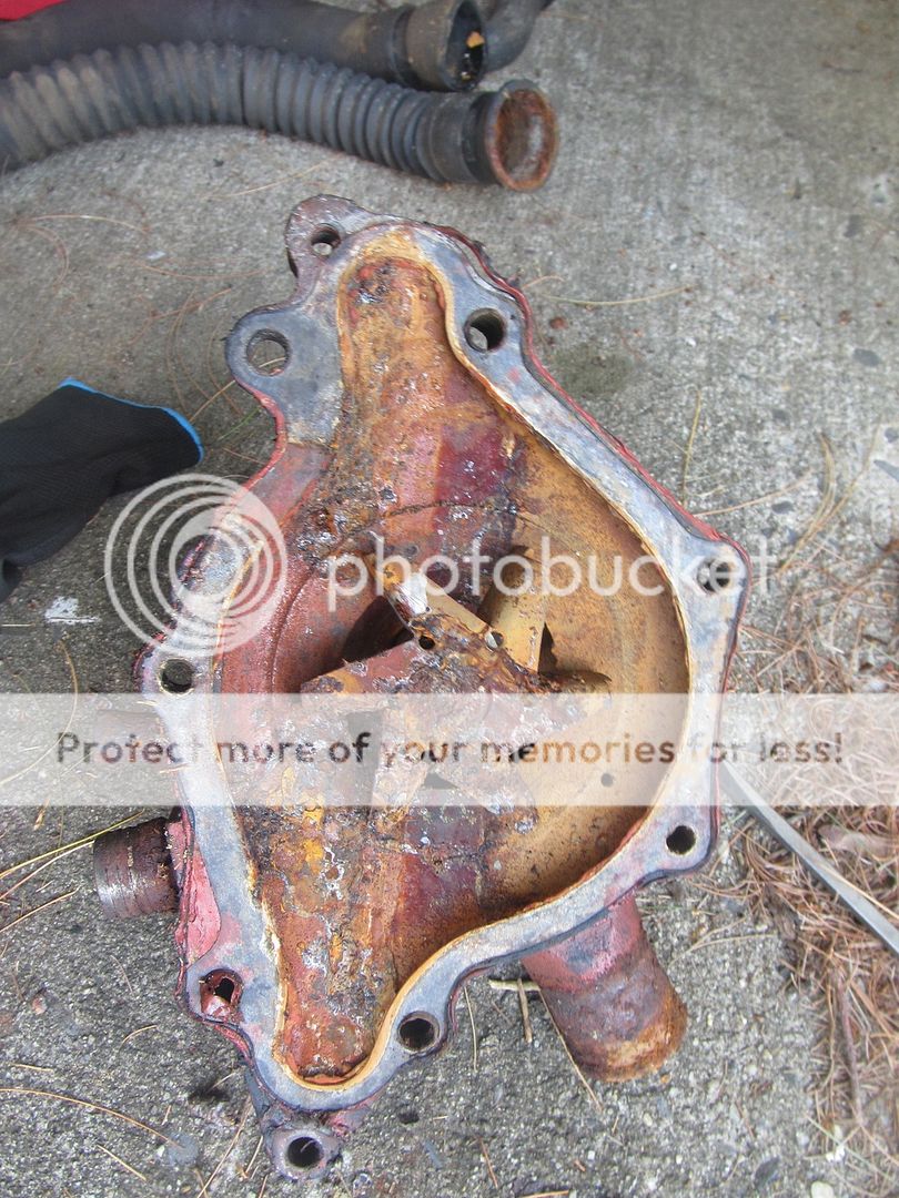

Thanks guys, I dropped it off at a radiator shop and I should have it back this week. I'll keep you posted. While i have the radiator out I figured I should check out the water pump and make sure it was in good shape. I have a pic and want to know if you guys think I should replace or just put on a new gasket.
trying to figure out how to post pics.....i've done it before..haha.
Since you asked...Now is the time to replace the pump, hoses (both radiator and heater), clamps, thermostat and coolant. Might even consider doing a flush of the system. Also, my preference is to buy the preformed hoses verses the 'universal' corrugated ones. If you do, make sure to add a spring inside the bottom hose. Have fun...
