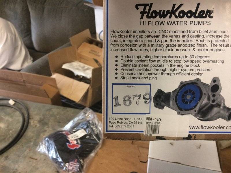

How many folks have installed the FlowKooler high volume water pump in a car with a big block and 26" radiator?
Right here....
I saw you had it cleaned. I’m saying do it again and be sure they rod it out this time. It’s really the only stone unturned.
I said it's running cooler somewhere since changing the high flow 180 thermostat to a standard flow 160.
