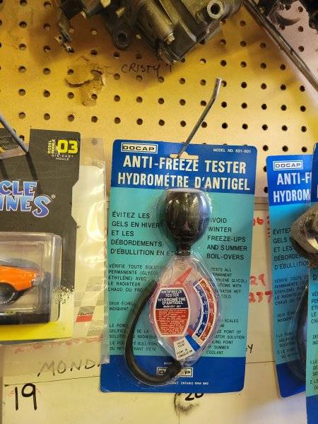

Straight water with a wetter would have been best, but in the current state I'd be checking the over concentration of AF , which cools poorly

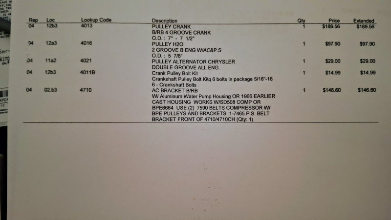

According to Bouchillon Performance Engineering, the crank pulley is 7-7.5 inches in diameter and the water pump pulley is 5.875 inches for the proper drive ratio.
