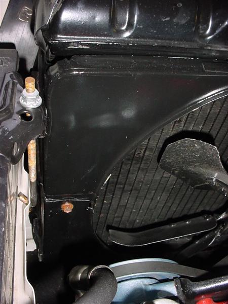

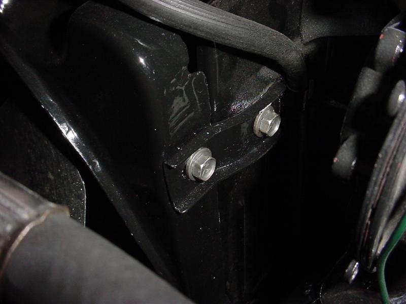

The way they mount is via four brackets mounted at the side rail of the rad with special insert nuts and bolts
Heres a couple pictures......

I would sure like to know if they would interchange from a c-body to a b-body. I would like to install one on my 65 coronet wagon. I can find some from a c-body, but since the parts book show a difference I have not bought one. I do see that most of the time the 2 piece c-body shrouds are about half price of the correct b-body shroud. That is another reason I would like to know for sure if they would work. Great picture BTW to help explain the mount.
Matt
Yes, thanks for the photos. I'm working with MoparSteve on a shroud he has, but mine is from a 65 C body Big Block and my side brackets only have two rectangular holes about midway up the core spaced maybe 4" apart. There are no captive nuts in them. Steve is checking to see if his shroud might work but the photo however looks like the mounting brackets are spaced apart a fair amount more than 4" or so? TK

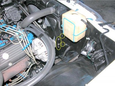

Here are a couple of pictures of a 65 C-body shroud and mount that are posted over on the C-body only site......
