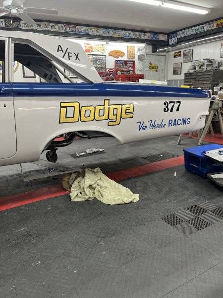

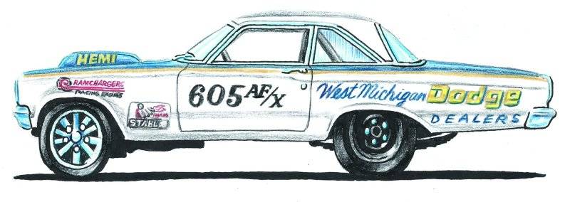

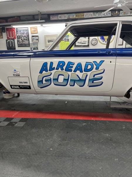

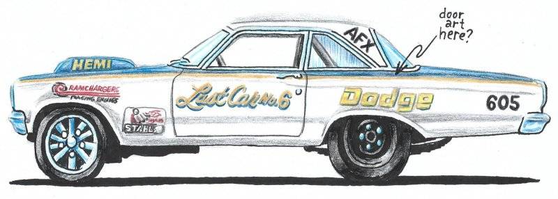

Doing some drawings of lettering and paint for the afx any other susgestions would be greatly appricated. Lot eayser puting the thoughts on paper than on the car.

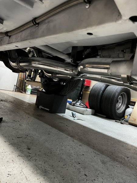

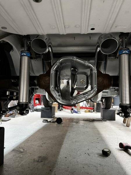

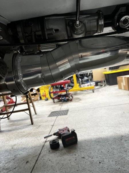

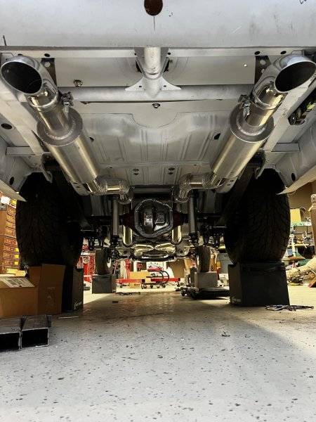

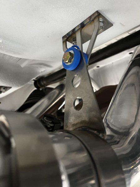

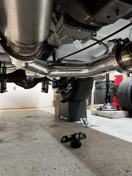

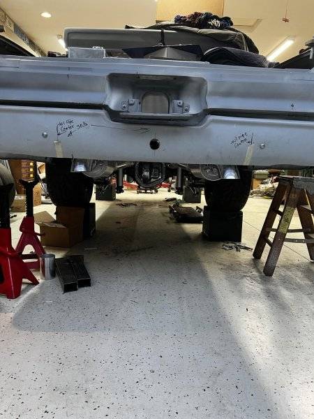

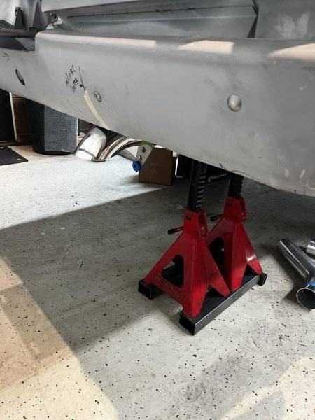

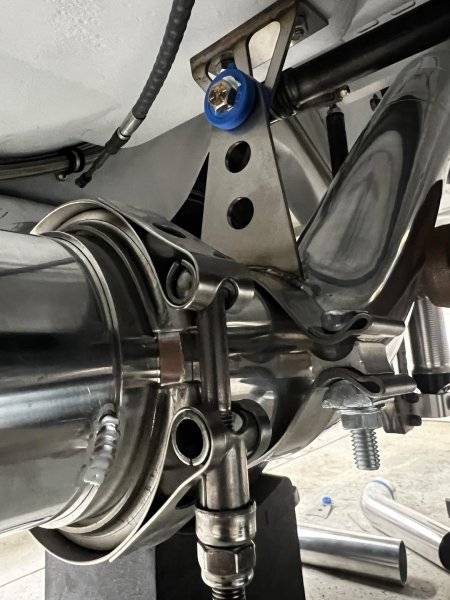

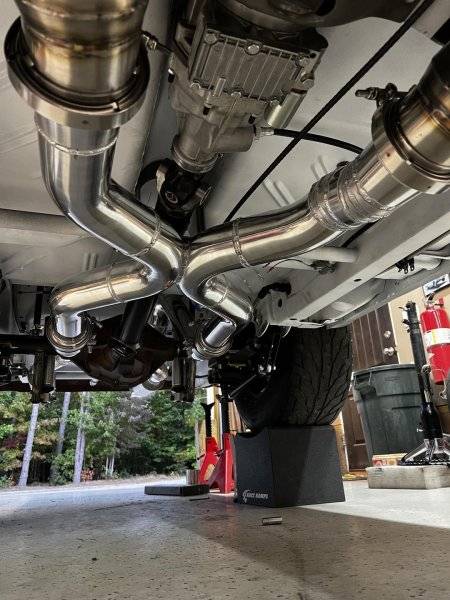

Been working on the exhaust system 3 1/2" all aluminum exhaust. The whole system including mufflers with turn downs weigh less than 20 pounds. Un screw the 4 band clamps and the X pipe drops off the car

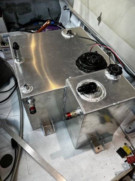

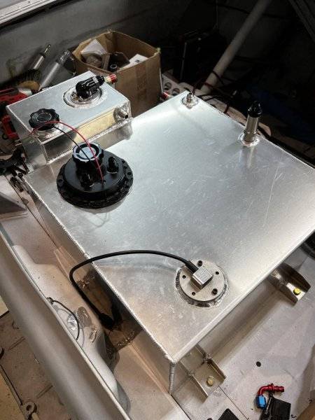

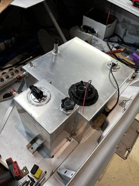

Also been working on the fuel cells pretty much done one 18 gal tank and one 3 gallon tank. Now off to get them hard coated (clear) anodized
Got the exhaust done and welded up completely turned out pretty nice. From the headers back total weight of the system 22/23 pounds,

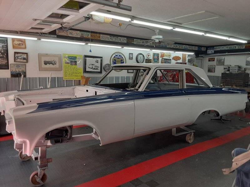

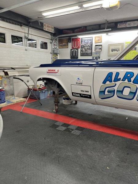

Out of paint shop prison and ready for lettering and final assembly. Hope to have it ready for testing by October 2024
