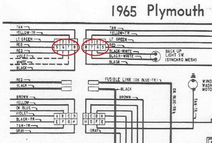

I know that the 65 Automatic cars have the reverse light switch mounted on the column (with the column shifter) But for the manual shift cars was the wiring/switch on the transmission ? I have the service manual and it looks like it.My problem is I can't find the wires. The car was a 3 speed on the column.
Look for the leads at the bulkhead terminal first.
Great, Thank you. I've looked for the wires with hopes of finding pig tails but no luck. Using your diagram I will start at the bulk head and get into the harness.:thumbsup:
