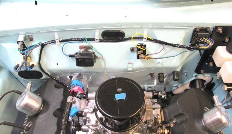

1965 Wiring - Post #40 Picture
Both sides of the Ballast Resistor are directly fed off the ignition switch
1 Side / Brown off ignition switch to ballast - Dark blue off ballast to positive side coil
2 Side / Dark blue off ignition switch to ballast - Dark blue off ballast to alternator regulator ignition side
So Yes 4 wires

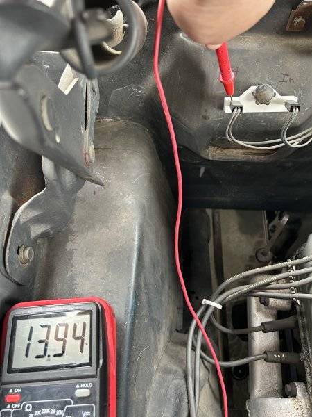

When the car is running above idle , charging system , how many volts are you getting directly at the battery

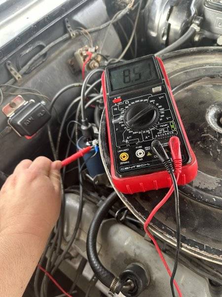

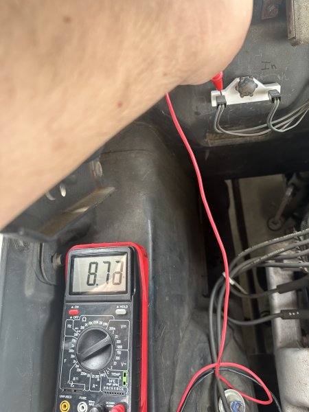

So I tried to drive the car today, thinking I had fixed the issue. Today it wouldn’t even start! Just crank and crank and nothing. I checked voltage with the key in the “on” or “run” position (the position it reverts to after cranking and upon starting) and now these readings are different! I was getting full voltage to the coil, and now it seems to have been reduced through the ballast!
Coil + now
Then I would still lean back to its the brown wire getting voltage when it shouldn't be. Which could be internal to the ign switch.
But right now it's not.
And your batt voltage is very low.
Possibly burnt out the brown wire contacts, that's why it won't start.
Jump batt + to the coil and it should start. Then pull wire off and it should keep running

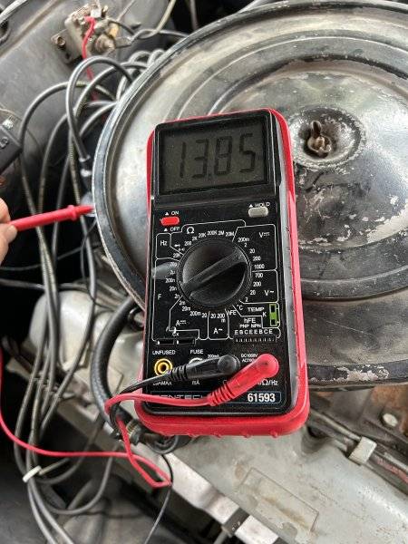

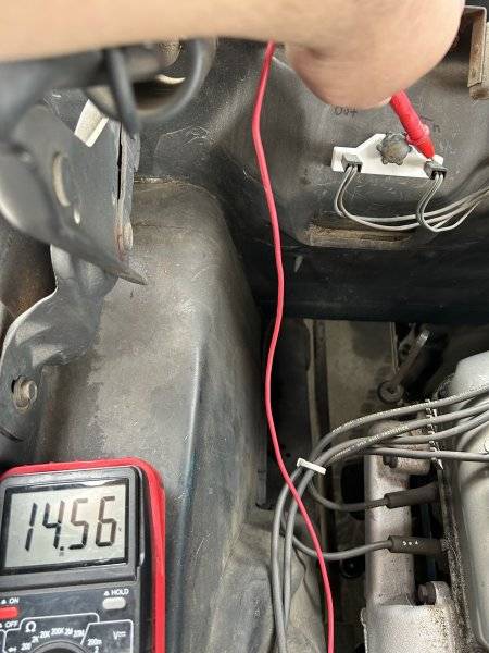

So I was hoping the issue would be in the engine harness, and I ordered one from Evan’s Wiring. I put it on today, and I’m STILL GETTING 14v TO THE COIL!!! Man I convinced myself this was going to fix and was so disappointed to see nothing had changed! Pic of reading taken while car is running.
