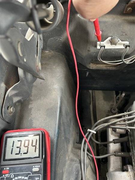

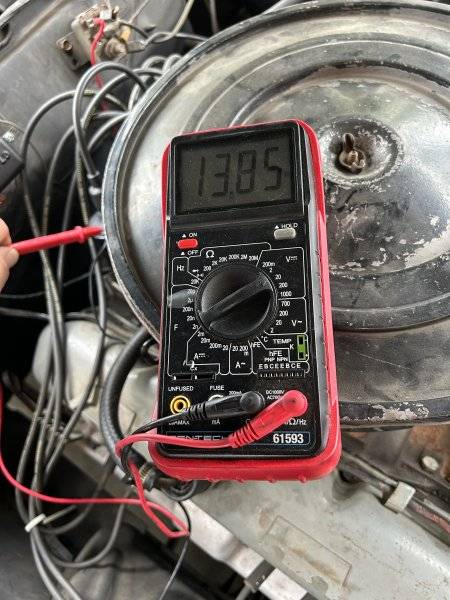

So I got a chance to get under the hood today. I changed the ignition switch inside the car hoping that was the issue. So far I’ve changed coil, ballast, voltage regulator, and now the ignition switch. I was getting the same 13v to the battery side of the coil while running. Any ideas what to check next?
pics of voltage values from coil positive and ballast
Check the voltage on the positive of the coil to ground. Checking from coil positive to the ballast is not a true reading in fact not sure how your are even getting any voltage reading that way. Or is that reading to ground?
that has resistor has to be bypassed somewhere in that circuit
Your charging is a little high or your meter is off a volt or so. On second thought thats probably perfec
Pics for the win.
Why is there 2 wires going into both resistor connectors ?
Unplug the resistor and check resistance
