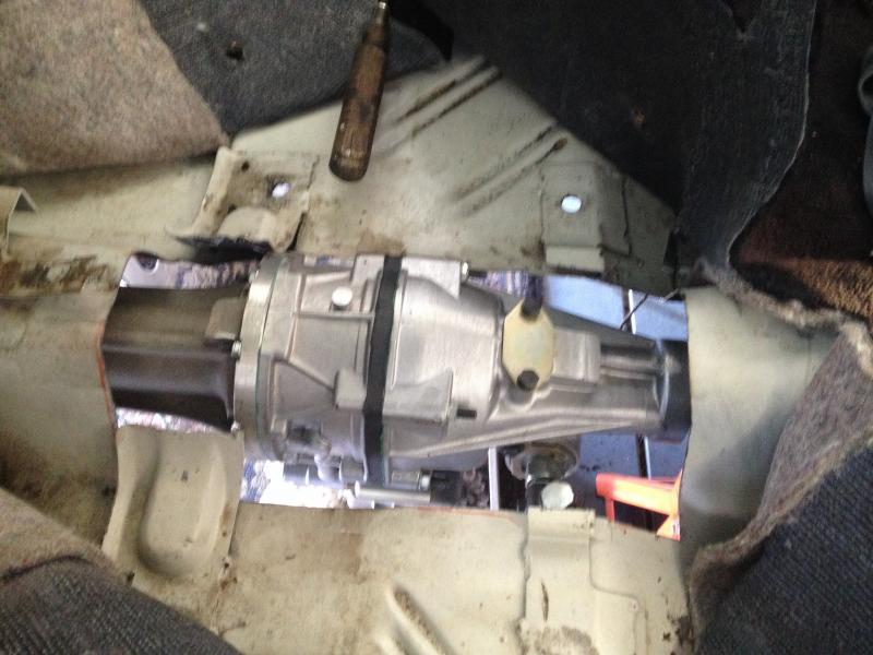

I also used a Gear Vendor and can't wait to drive it
I'll post pics later
image.jpgimage.jpg !!

I see that. Looks great!! Am I going to be forced to cut the tunnel open to fit the GV unit? Really hated to hafta do that. I had originally looked into just adding an overdrive transmission, but couldn't really find a setup that would adapt well.
