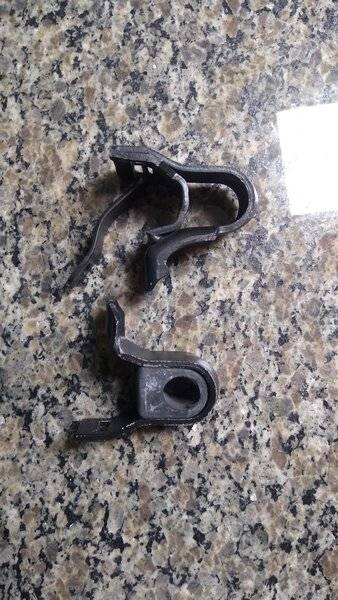

Are all 3 pieces used to bolt sway bar to struts on my 65 Coronet?
A bushing on both sway bar and strut?
Thanks
There should be a bushing in the link that bolts to the strut rod. The end of the sway bar fits in there. Your bar is likely 7/8" , but could be 3/4" . Layson's sells bushings. Lube it up with silicone grease and press it in with your bench vise. I just got done doing this on my '64 Polara last week.
