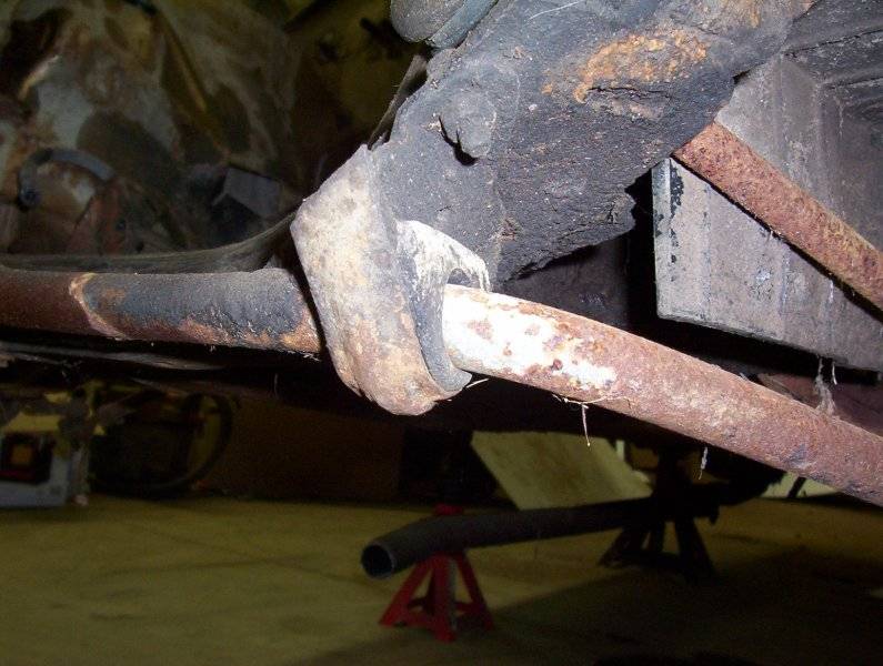

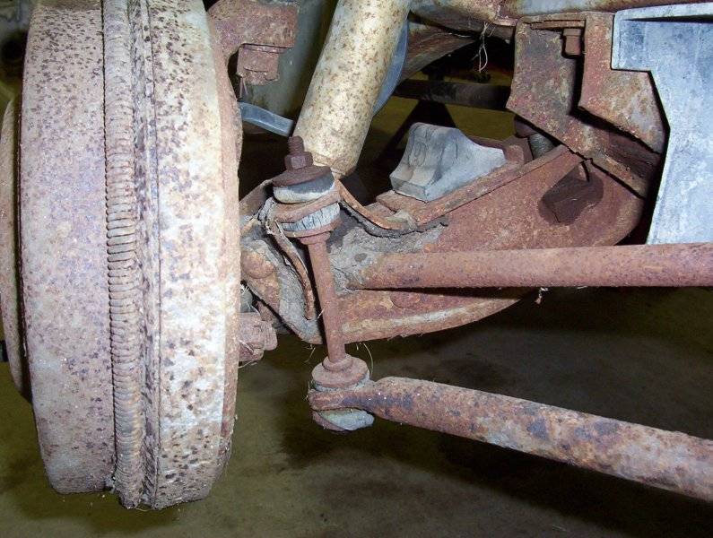

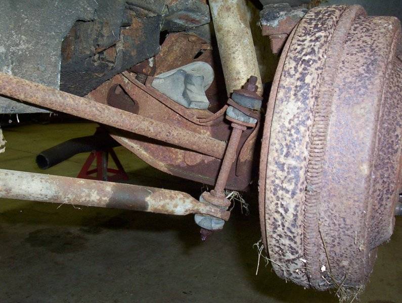

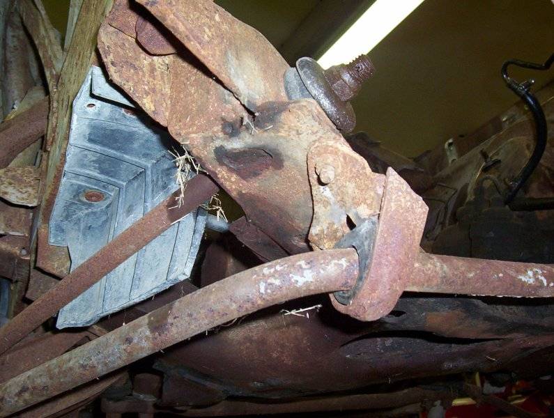

I am about to install a front sway bar on my 68 Coronet. It never had one before. Can anyone send a diagram of the brackets, measurements, etc. I will need to install it?
Thanks of course!
I assume you are installing the front OEM sway bar. Holes should already be there.
Yes but I think ill have to add the mounts. I'll check later today. The pictures are perfect! Thanks.
Do your lower control arms have the tabs for the end links? There are specific sway bar vs. non sway bar lower control arms.
I don't think mine have the mounts. I'll be making them.
Pretty sure you can buy them already made to be welded on.
