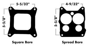

spread bore , is referring to the base plate bolt pattern where it bolts to the intake. some carbs are spread bore, some are square bore , and some are universal. most aftermarket intakes will accept both.
