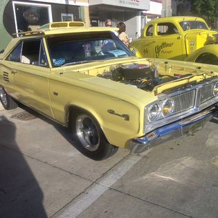

Depends on the cam. I built a 1970 375/440 for freind. All the open areas of the chambers were eqaulized. KB quench dome pistons were fitted to .045" quench. 9.7-1 measured compression. It runs a very small [email protected]" cam. Stock intake, carb, air filter, exhaust. On 93 it will ping at full timing. It'll take about 33-34 total. As to the 383. Did a hop up for my friends 66 Coronet factory 383 4 barrel. Good condition stock short block. Used home bowl ported 906 heads. I don't remember the cam exactly, but around [email protected]", headers, Performer rpm, Eddy carb, 4.10. It runs pretty well. Full 38 degrees timing with no ping. Street car only.
Doug
Doug
