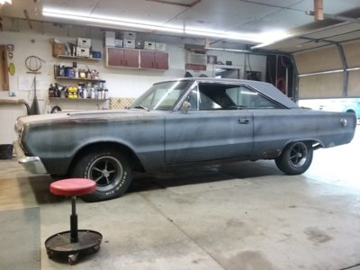

There is no good aftermarket rear quarter sections. AMD is the best but the do not have the wheel wells. I have used sherman and they are not correct and a POS - huge time to get them to work correctly- best way is get a set cut out of a four door car if you can. My driver Sherman panel was finally removed as even the arch was off thus factory trim did not fit plus the body lines are not chrisp like factory. My 2 cents I would be real happy if AMD made a set. I have used their stuff on other projects and they all worked well.
