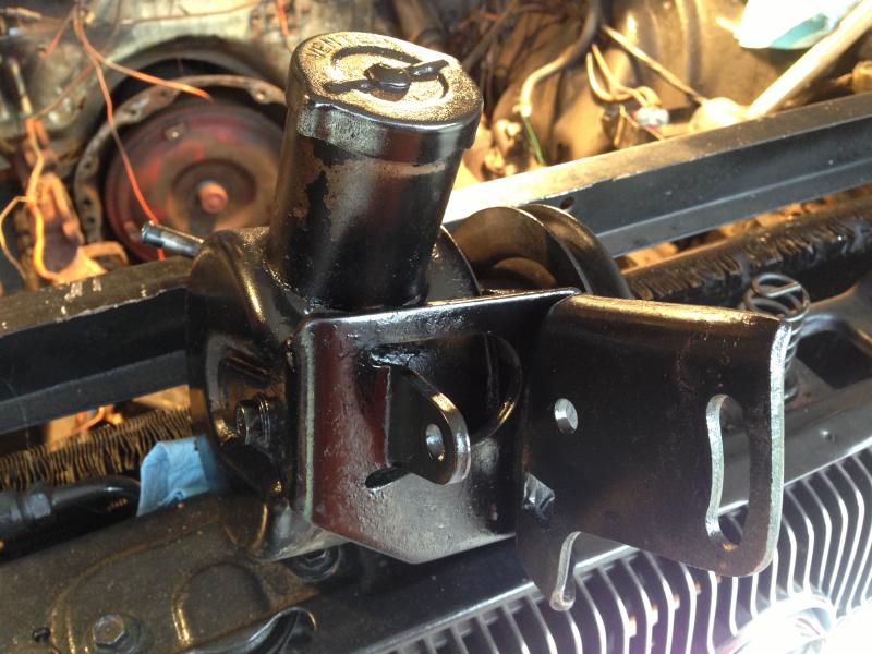

I am trying to help a local guy with his '67 Charger project. Somehow or other he has lost the little pivot bolt bracket that bolts to the lower two driver side timing cover bolts. It stick up and over I think and the pivot bolt for the power steering adjustment screws into it. It is the last piece he needs to finish putting the accessories on his new engine and dropping it in.

Like this one

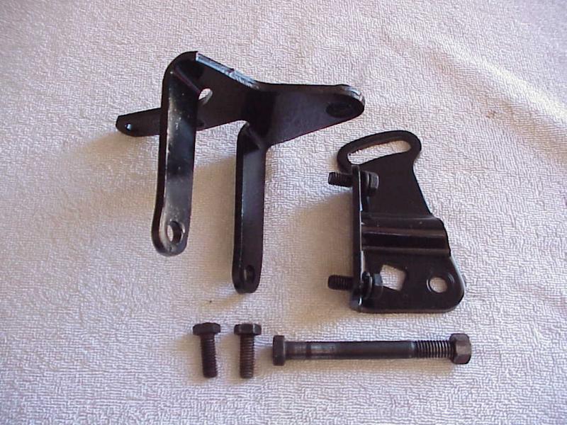

that is why starting with a posted photo of what you have, sorts out the guess work by viewers. I posted a photo of the correct brackets for your application. Any other pump would not be 'correct', but getting a part for Your thing, is first chore.

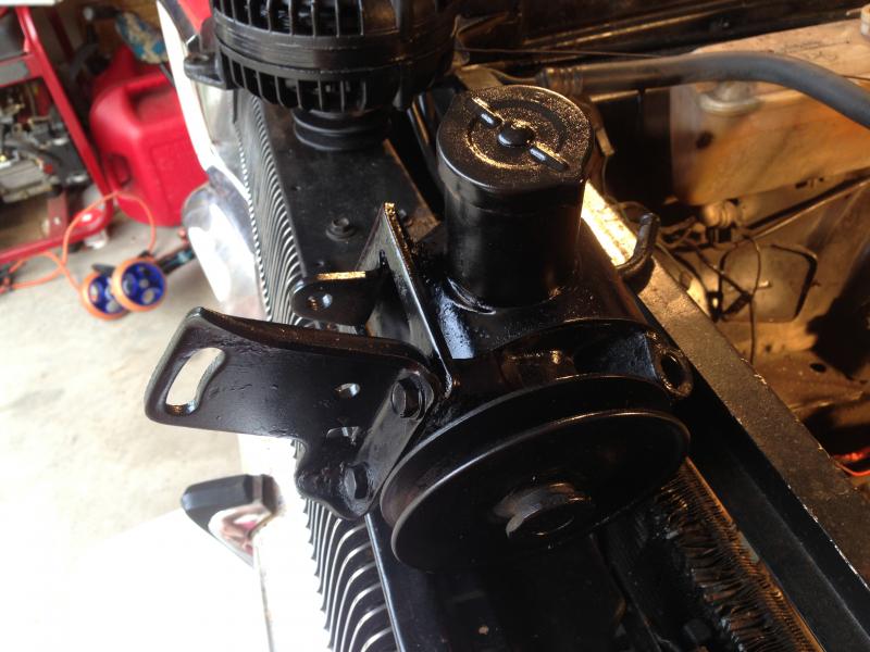

that is a 67 68 small block pump, and it looks complete. fits the cast iron pump housing, which is why you can't fit it on the bigblock.
so now you know.
