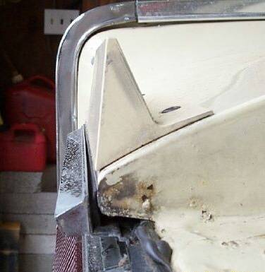

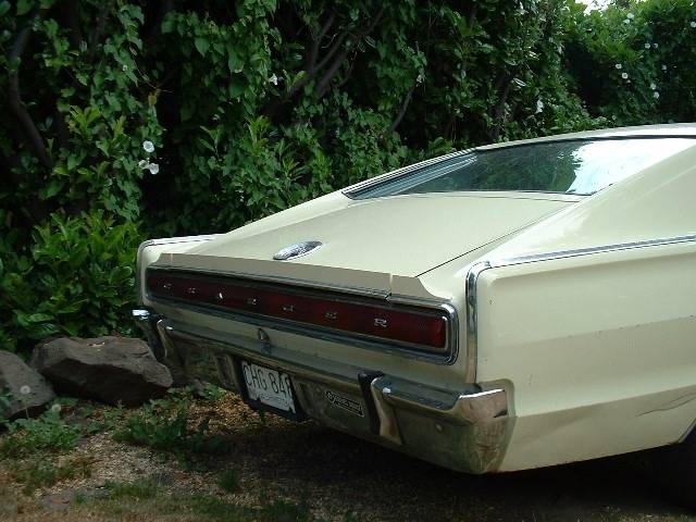

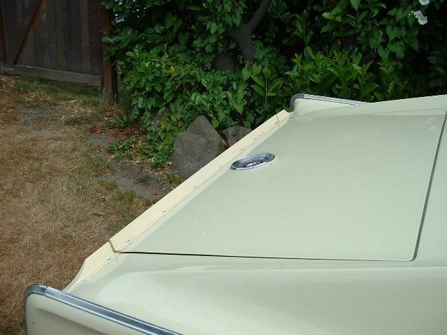

Here are a couple of pictures of the original production spoiler. I do have much better shots at home (at work at the moment as usual) that illustrate the actual profile as seen in a cutaway view. It's a very simple shape... The problem with reproducing these spoilers is the bottom curve, or more accurately put... "curves"... It looks flat and simple, but the back of the deck lid has a slight curve to it running across the back, that levels out when it meets the body on each side. Then there is the curve running up the back of the body and the deck lid. The shape of the curve is constant as it moves from one side of the car to the other, but it rolls upward as it you get closer to the center near the medallion and then rolls back down again at the other side. These are all very subtle changes that could be pulled in when attaching the spoiler to the vehicle if the spoiler has a little give & flex to it.

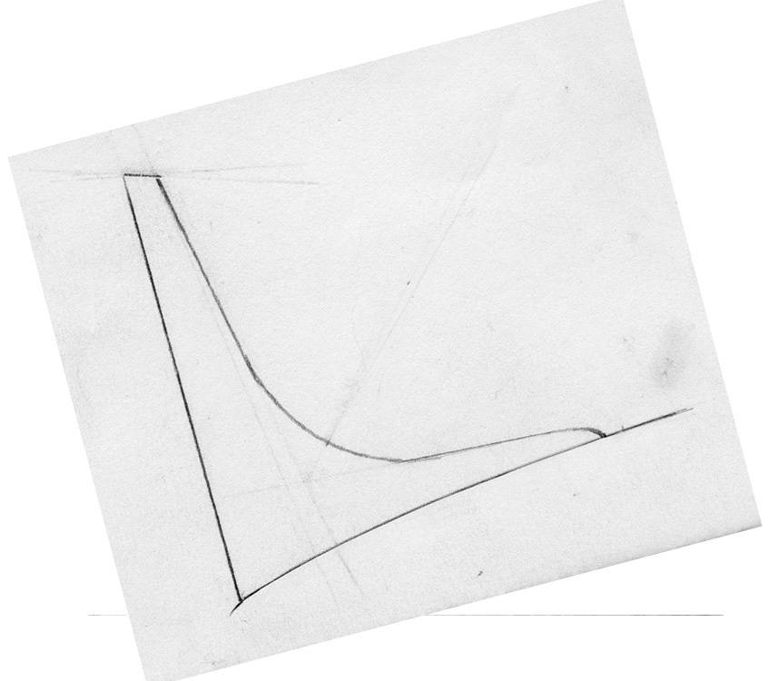

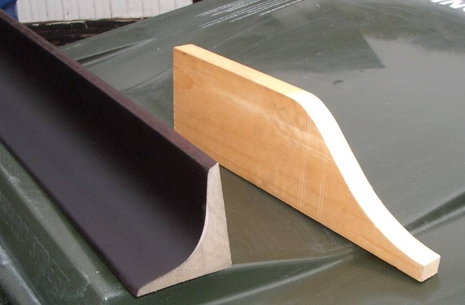

Here's a sectional look at the model I designed and made up. Sorry I don't have a good pic of the end cut (shape) handy at the moment, but at least you can see the profile. I have the model finished and ready for production, (2 versions actually) but I am holding off on that right now. My recently restored chassis is going into paint here in a couple of weeks, so that's my first priority at the moment.
The fist pic is my original design sketch...
The second pic is an early work in progress shot, showing where I had carved out the basic sectional profile from a 4"x 4"x 8' laminated block. This would later become the master from which the actual molds are made for reproduction.
