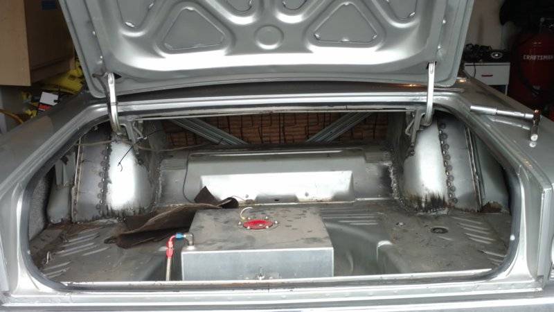

I have always had a question on installing mini-tubs on a 66 B-body. Once you widen the wheel wells do you have to fab trunk lid hinges since the stock hinges won't work?

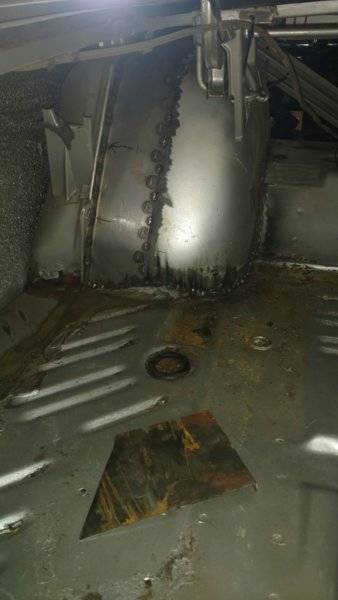

On my 67 Plymouth we used the supplied brackets that came with the US car tool kit only had to attach them to the tub and orginal hinge
Bracket before it got welded. And finished product
