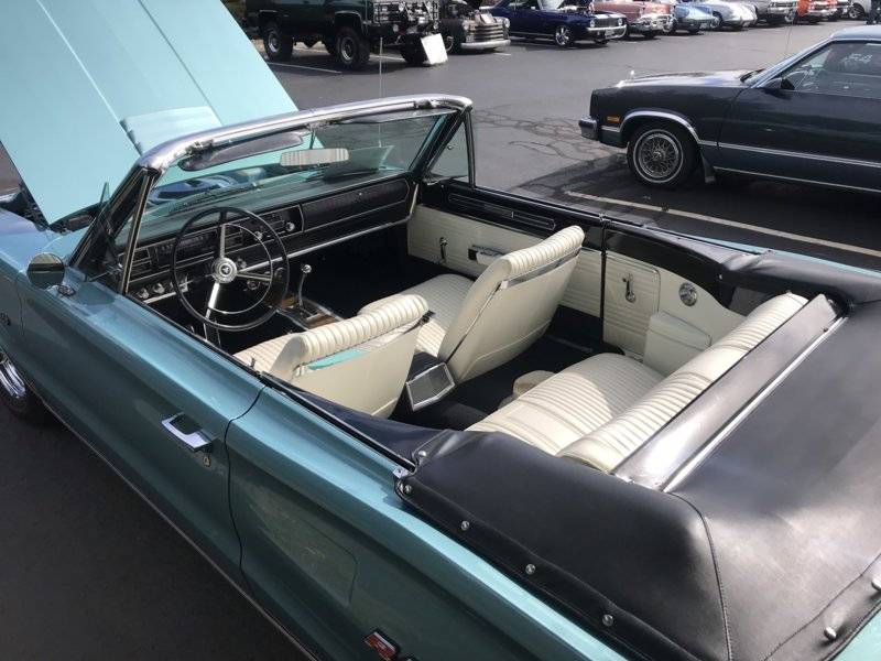

I'm looking for a picture of how the boot ties into the rear seat.
The outer perimeter is snapped in, but I cant seem to find a clear picture of where the front part of the boot goes.
Does it go into the filler panel behind the rear seat?
I'm looking specifically for 66-67 Bs.
Not sure if 68-70 is the same.
Thanks in advance.

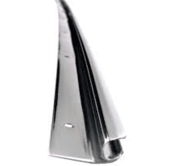

They are all the same even E bodies are the same... There is a plastic key sewn to the boot & an aluminum channel screwed to the back of the seat.... Slide the key in the channel & snap the clips on & your done...
The channel shown is for a chevy it's similar to the Mopar design..
It looks like a seat welt bead and it's sewn into in straight part of boot behind rear seat top. It slides into piece posted in post #2.
The outer perimeter is only snapped in on 1966 and 1967.
1968-1979 is clipped under the trim, the factory didn’t use snaps on the trim.
