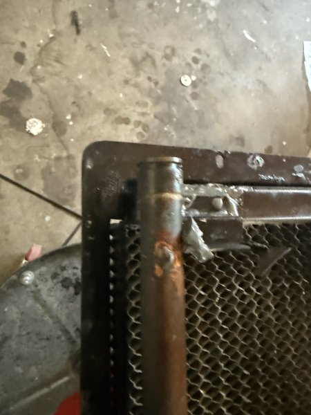

Anyone know a good source for the orings that go on the heater core to seal the heater core and the firewall tubes? My universal oring kit orings are too fat or too thin. Also should they be oil resistant like an ac oring?
Any standard A/C o ring should work. (proper size of course) They should be the green colored ones.
These are for the heater core tubes for the coolant on A/C
cars only.
A standard o ring should work fine. Coolant only has 15# of pressure and 220° temps.
If you find any of the repop suppliers that sell them, it is a very slim chance they are made specifically for that application.
