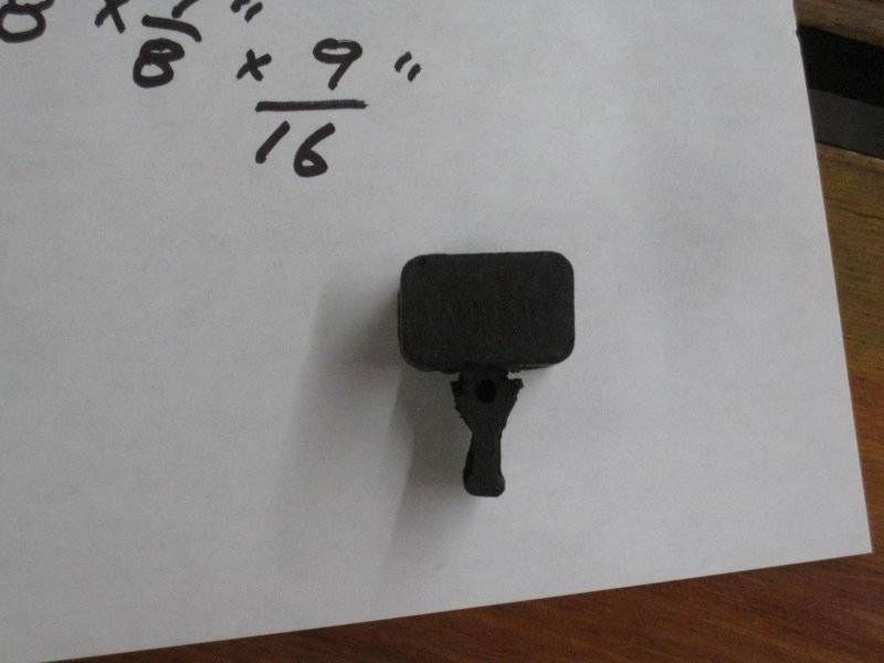

I think you need to remove the rubber bumper to gain the clearance/stroke necessary for cable removal. Be VERY careful to save the bumper. I haven't found any replacement for it.

I was assuming the 66 was the same as the 65, if so, depress the pedal to access the bumper.
