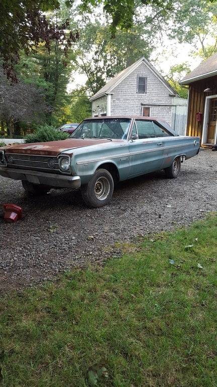

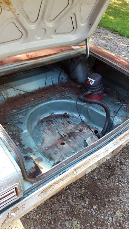

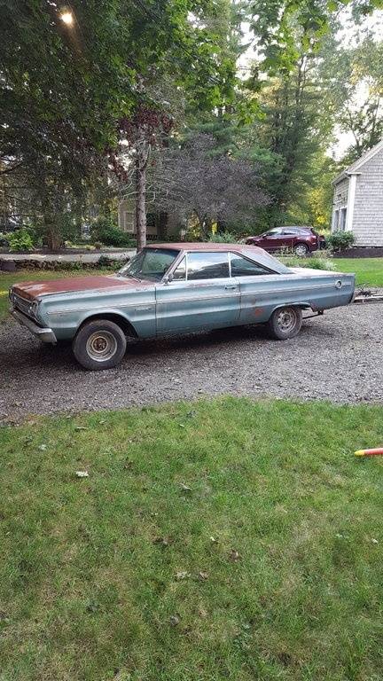

Here are a few pics of the 66 belvedere II i picked up. Paid 850$ for it pretty solid, bad part there was no title but I found the original cert card with owners info. Im going to try and track her down. Going to build a super stock drag car.
I have a complete rebuilt 318 with trans , guy that built it said it has about 275-300hp. Plans are to race with this engine then next year buy a 408 stroker.
Questions for you guys. What rear end ratio and stall converter would you guys recommend
