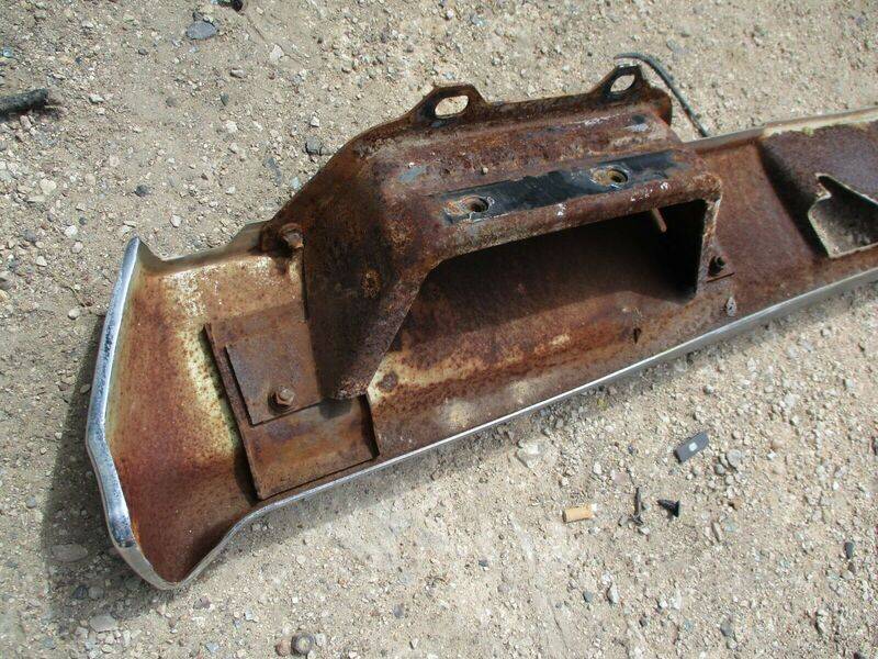

I'm unable to locate new, replacement bumper bracket&hardware set for my 66' coronet,...but From the looks of it, the 68's which i can find, appear similar front and rear and available.
Were could i source the 66's or will the newer years fit is my question/

66 - 67 coronet are the only ones that will fit directly. Chargers of the same years are longer and the bumper would stick out too far. I don't know of any reproductions, so used it is.
I forgot to add that station wagons of those years are also different. I don't know what the difference is, but they have different part numbers.

Thanks for the info. On the 68' brackets that are available...., Any chance i could cut and "section" re-weld/them as the wholes and angles may be correct, the distance is the problem as i understand it? The pic i used is a net pic but that would be my brackets and bumber
