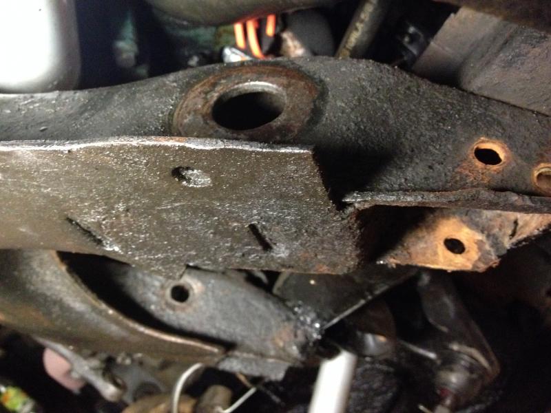

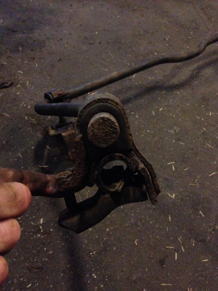

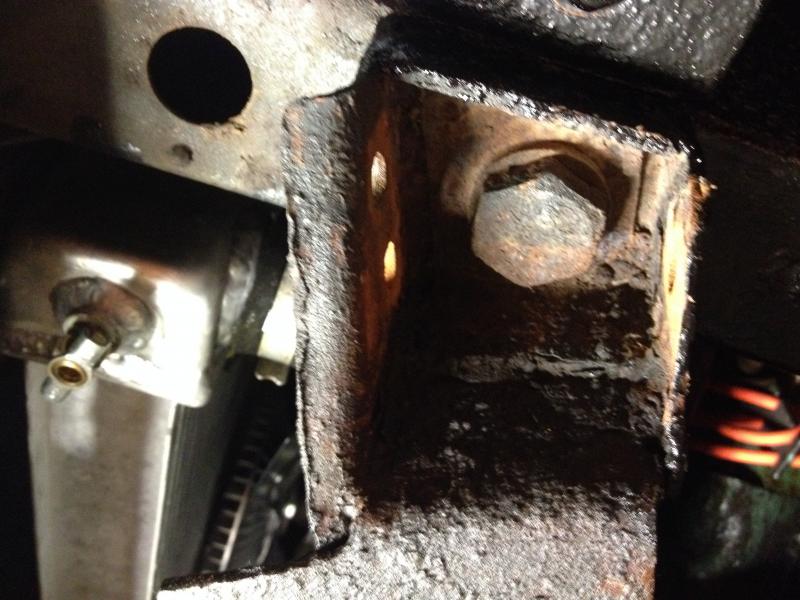

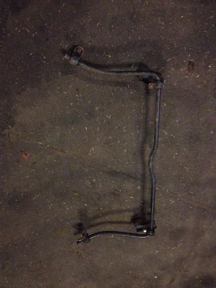

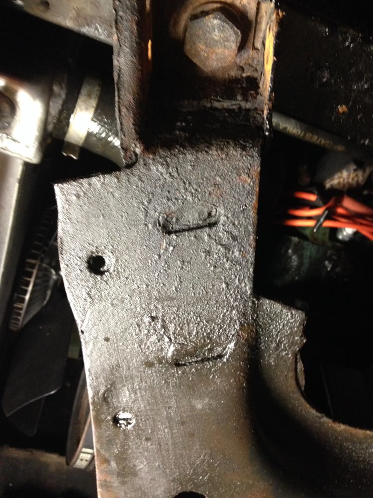

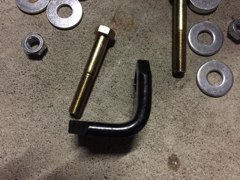

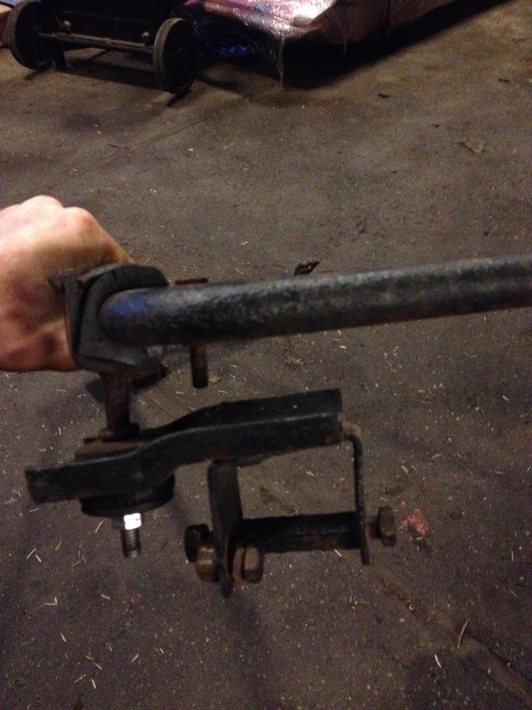

Hi. My -66 Dodge Charger have a factory Sway bar installed. They are fastened with brackets in front and the ends are fastened to the Strut Bar.
I want to upgrade the Front sway bar. do any have some to recommend? (My Lower control arm do not have mount for sway bar)
Thanks!

you have an early 66 car, you will need to either make some "L" brackets for the later bar, or change your lower control arms to later style

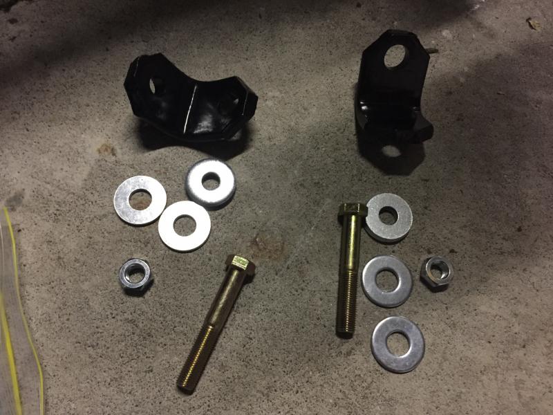

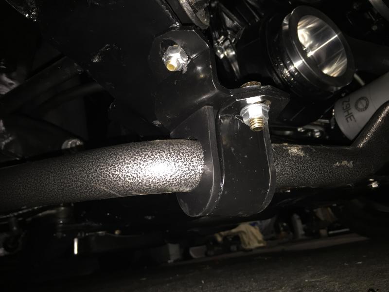

I've got the 1 3/4 bar for Hellwig (& 7/8 rear as well) good units, easy installs. I have the sway bar tabs so I didn't use the extra mounting hardware it came with but they look like good solid mounts. I can take some photo's of them if you want to see what the look like. My kits was for the 68 B-body, I think it was the 55903, as an FYI.

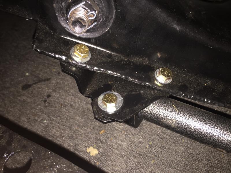

You shouldn't need to drill any holes, the kit that Malicious found should mount to the 2 front holes in pic#3.
Correct, no holes needed to be drilled for the Front sway bar. It mounted up to existing holes. Sorry I got your response last night after I'd left the garage, so I didn't get pics last night, but I'll get some pics of the brackets and the mount points for you tonight.
For the rear I used the 6909, Hellwig site says that it will fit the 66, but it doesn't seem to say the front bar will fit... I would of assumed the front would fit and the rear might not have? I guess my pics will help you decide if the front will fit. The rear DID need holes drilled on the chassis for the end links, around the leading edge of the kick up.
