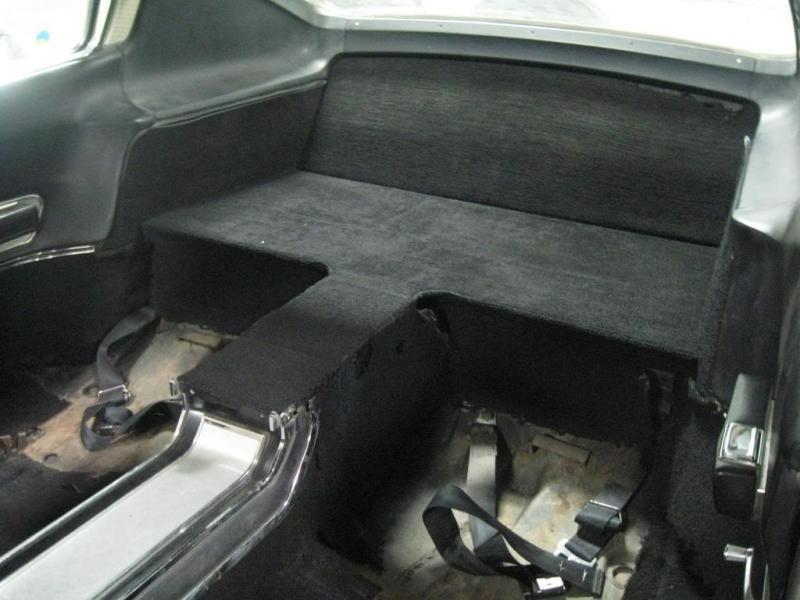

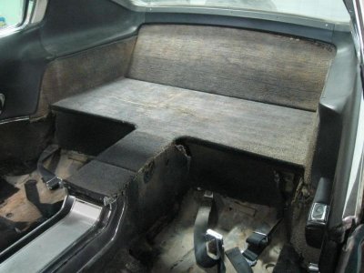

Last winter I recovered the front seats in my '66. The rear seats were good shape but just needed to be freshened up to match the look of the new front seat covers. I sprayed them with SEM Color Coat satin black. They turned out great. I also sprayed the carpet, it made big difference.
Before
After

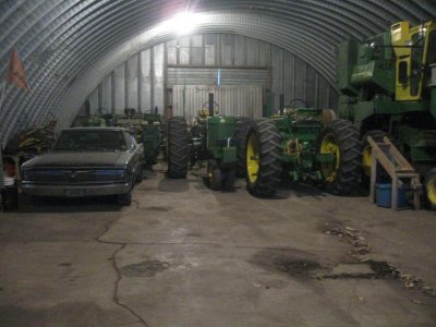

Don't know how that pic of the car in the shed got on there, can't delete it. Oh well, that's where the car spends the winter months.
