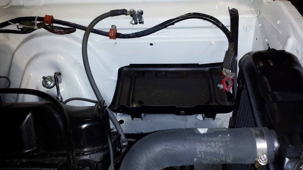

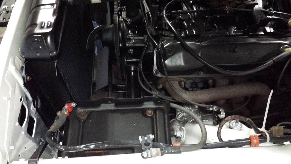

There is just no room in under the hood for the battery since my car has air conditioning. NOt sure how it would fit there.
There should be room right here.
Where Chrysler put it.
You can get one most anywhere.

http://www.autometaldirect.com/amd-battery-tray-66-69-b-body-p-682.html
