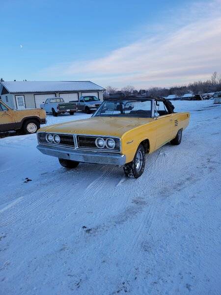

Trip went well and it's tucked away in my garage. I'm sure I'll be really picking brains now :)
1jULDWYQfVkpyQ3mU0tbvwrrEe6wwH8rF4Q2SHO7y40VYFjLBTYOjsYJllu7j4yxnNTZ5mi=w1250-h937-no?authuser=0.jpg
Nice!! Now go paint them grilles!!!! :mob::lol:
