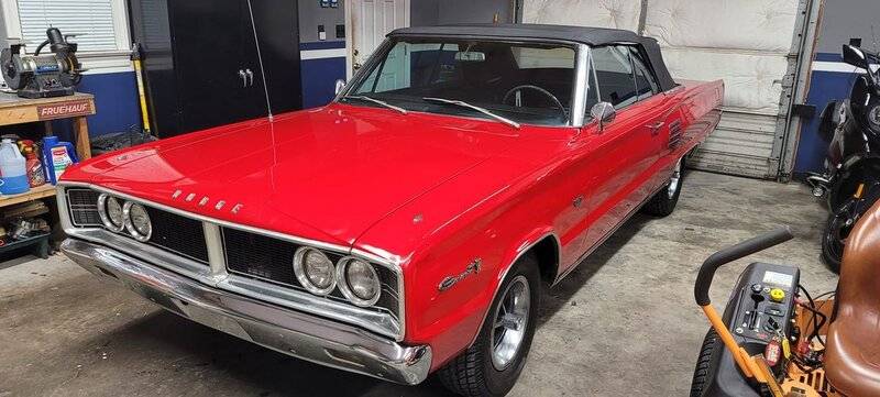

Hi all, brought this 66 Coronet convertible home last week. 440/4 speed (not original); Body is in great shape, a couple soft spots in the drivers floor; other than that she needs alot of misc things---oil leaks fixed, steering gear, engine upgrades, some interior and trim pieces etc; I'll be pulling the engine/trans and going thru both this winter. Looking forward to checking out the forums here and diving into this build!

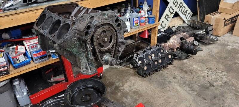

Got the 440 tore all to pieces today.
Definitely hasnt been touched in years. Every gasket was leaking, lol. Only evidence of anyone being in it is number stamps on the connecting rods and welds on the crank to balance it. That is good; someone balanced it. Not sure if this was factory or not.
Going to send it to the machine shop for a deep clean, bore, new cam bearings, and a balance--and whatever else it might need once they get everything measured up.
Calculated compression ratio at 7.65:1; that suggests a truck/RV engine, not a C-body engine as originally thought. Its definitely a 71 block going by the casting numbers. It had the emissions heads on it.
No worries, parts have already arrived to handle that. Once built, it will be around 10.5:1.
