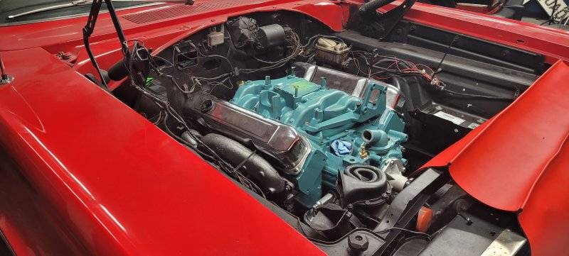

1969 440. A few mods; Performer RPM Aluminum heads, roller rockers, new pistons, upped the compression to 10 to 1; cam is upper end of mild; can't wait to drive it. TTI exhaust with Super 44's from Flowmaster.

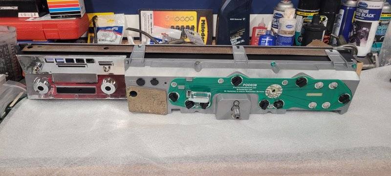

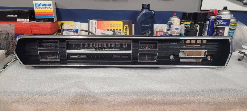

Got the cluster all back together tonight. Converted ammeter to voltmeter with the help of a gauge expert. Retained the factory look. Went thru the speedo, greased/calibrated; fuel and temp gauges working good; other than that replaced the 56 year old circuit board for good measure. Got a bit more to finish up on the interior and console wiring, and some testing, then can move on to final assembly;
Wow! That looks great. Who makes the new circuit boards? And what was the process of converting the amp gauge?
Classic industries has the circuit boards. Redline Gauge works out in CA did the ammeter conversion. They replace the guts with a voltmeter board and driver, and it retains the factory look and function.
Thanks, did you redo the lettering and numbers too?

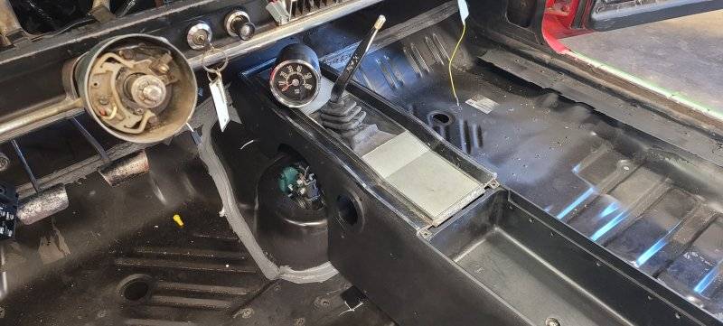

Got the console mocked up last weekend, brackets welded in, most of the wiring is done just waiting on a few parts; got done what I could today on the wiring, and undercoated the floor pan, next, finish all the dash wiring...radio, extra gauges, console harness is what's left...then..-- adding fog lights "due to 67 bumper on a 66" LOL. Going to look like it had them from the factory.
Looking great!
Where/how did you mount the extra relays?

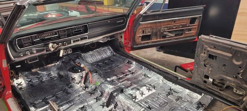

Wiring and dash is all done, except for radio, will be a few months on that, it's being rebuilt. Got the sound deadener installed today, next week is carpet and interior!

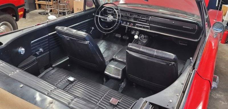

Interior is all set! Just waiting for the radio to be rebuilt and a couple window seals which are backordered.
