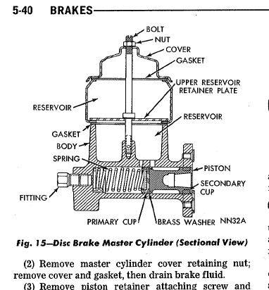

I don't believe disc brakes were a factory option on a 66 b-body?
They were available
. If they are disc they have a special master cylinder reservoir. @Joe Andrews the single master if it's there is worth some decent bucks.
Yes, Used the same single pot master cylinder like any other 66, just had a taller pot to accommodate the fluid requirements
