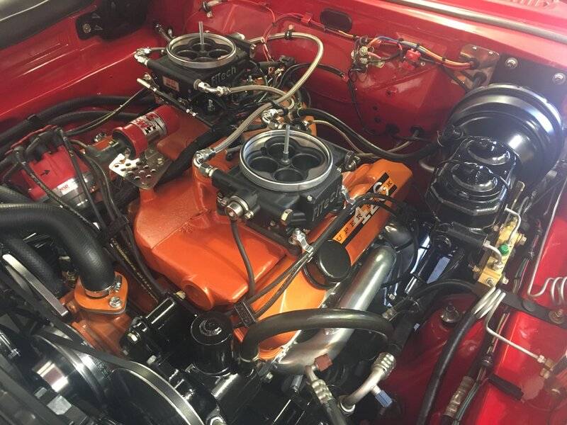

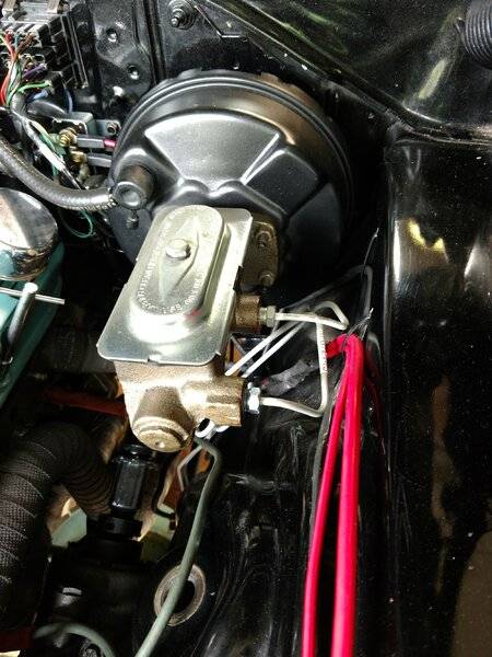

I originally changed the master (Rock Auto) and added the junction block and lines they were an E-bay Kit. (https://www.ebay.com/itm/190829483923)
Now I'm doing a front end rebuild and adding disc brakes on the front along with a sway bar and gearbox. Phase 2.
Thanks Don was going to crawl under for a picture. Not now. Heads and exhaust get in the way.
Thanks Don, looks like you have the Kelsey Hayes PB Booster as I now have. I can not tell from this pic, do you have a small spacer/gasket between your PB booster and your MC? Best, B.

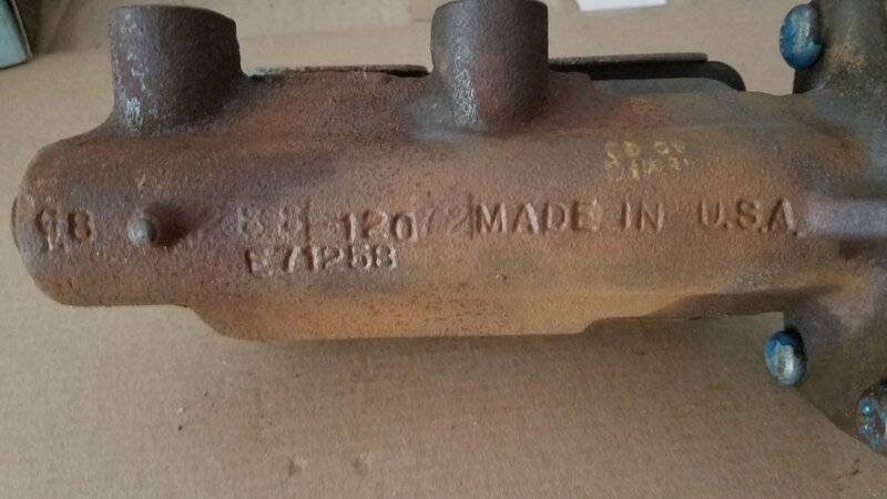

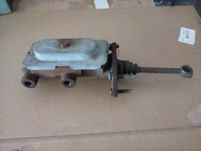

I have this MC I took off of my 67 Coronet,make me an offer on it if interested. One mounting stud is broken but they can be replaced.
I converted to Hydroboost and wont need it, I also have the distribution block at the shop.

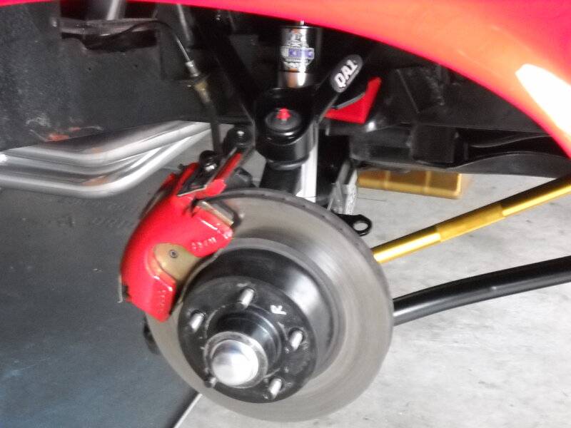

My opinion, do yourself a favor leave the brakes the way they are inspect your lines maybe check your wheel cylinders but don't go through the heartache of trying to put an aftermarket disc brake kit into one of these B bodies I'm still struggling after 2 years I can finally start driving my car it's still it's hard to stop you can read a lot of stuff on here about it, its tough if you're going to do it read up on it do it right and don't be afraid to spend some dough but you don't need it you have a convertible enjoy the shows the nice days in Missouri you're not taking it down the track the brakes are fine , enjoy it , don't lay it up in the garage
Sorry that your conversion has been such a problem for you Joe, but I don't agree with you about keeping the drums. The first time somebody pulls something crazy in front of you you are really going to appreciate the disc brake system. You are right to either use the complete later model A body parts or deal with a reputable company such as Dr. Diff for a complete system, verses using a mix of components that will give you a headache. Remember, there's no shutdown area on the street...lol.
