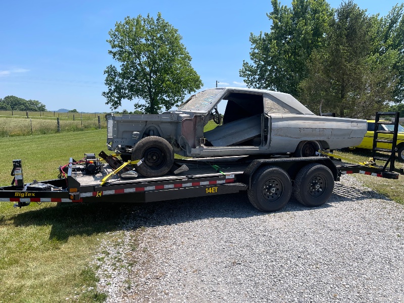

Hello FBBO, this is my first post so bare with me. I have a 66 coronet who a mutual car guy was trusted to restore the car years ago for us. Well time moved on and he never restored it and then called us to come and get it and that he wasn’t going to finish it.
So, now that I have my car back I’ve been looking to restore it myself and put it back on the road. I plan on building a tip over jig using the front bumper mounts and rear but on the rear he filled in two holes that I need.
So after that long unnecessary post would someone be able to get me some measurements on the correct locations for the rear bumper mount holes? I don’t have the small reinforcement plates or a good bumper bracket to use as a template. Thanks in advance!
