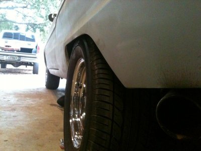

I have 235/60R15's on my 66. image.jpg

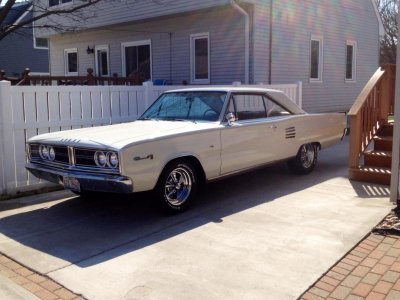

I played it safe on my tires and rims the Cragars are 4.5 bs , there is room to go bigger but like I said I played it safe and for me I like the way it looks a lot.
