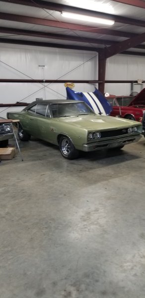

I have 275/60's on the rear of a 68 R/T on 15X7 Keystone wheels and 245/60's on the front. Sorry this is the best picture I have right now.

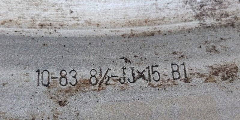

My "spatial memory" recall tells me a P245-R15 on your wheels should be fine up front, but P255-R15 up front might rub. Do a fit check if possible. Also, a tire dealer might not recommend the P255 for a 7" wide wheel. I tend to agree; and that's why I went with 15x8.5 on my first B body.
Below is my '71 Satellite with G60-14 on all four corners mounted on the factory 6" steel wheels. I recall those tires being close to rubbing on the front, but I never found any evidence of rubbing. I no longer have this car (GTX tribute, but some people used to say fake).

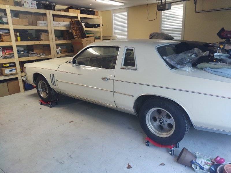

Below is my '79 Chrysler 300 (B body) with P255-R15 mounted on 15x8.5" wheels. All four corners. No rubbing anywhere...ever. However, I always thought the wheel wells on my '79 had more room than my '71. I could be wrong. I sold my '71 in 1980.

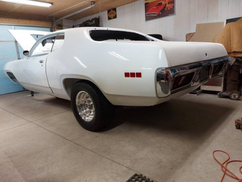

If I had a '71 again, then I would go staggered width front/back wheels so I could have a nice, wide footprint on the back, as well as fill up the enormous rear wheel wells. Up front I would go as wide as possible to fill up the wheel wells without rubbing. Normally, I like the same sizes on front and rear, but (again) the rear wheel wells on a '71 need to be filled up for visual appeal. Also, I would go with slotted wheels if at all possible. Just opinions...tastes vary.

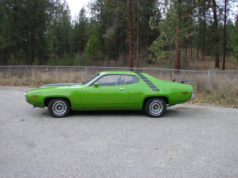

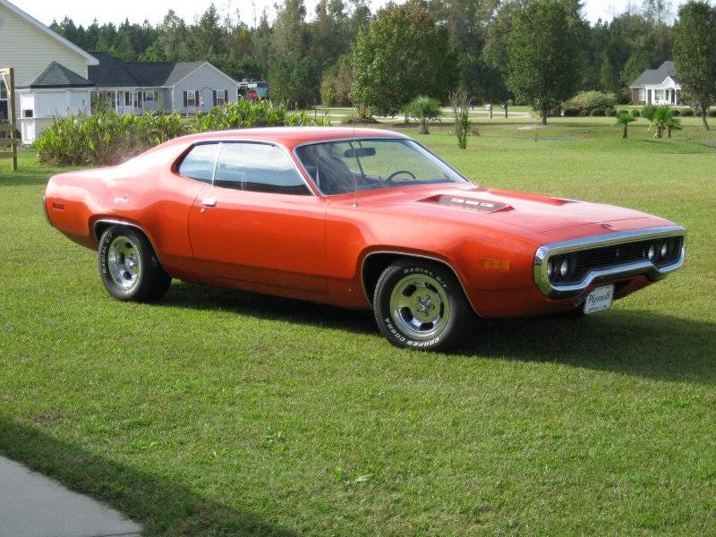

My old 71 RR 275-60 rear and 245-60 front.

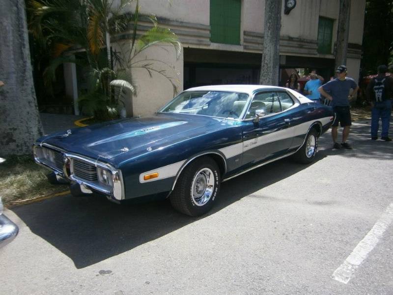

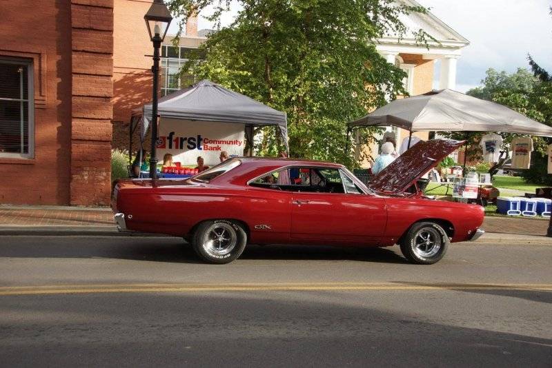

My car pics is 15x7 rallye… just happens to be a Charger and not a Plymouth LOL
