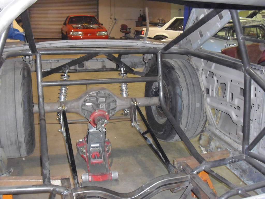

custom 9 inch rear end with mark williams 40 spline setup. 3.70 gear
and a lot of time fabricating

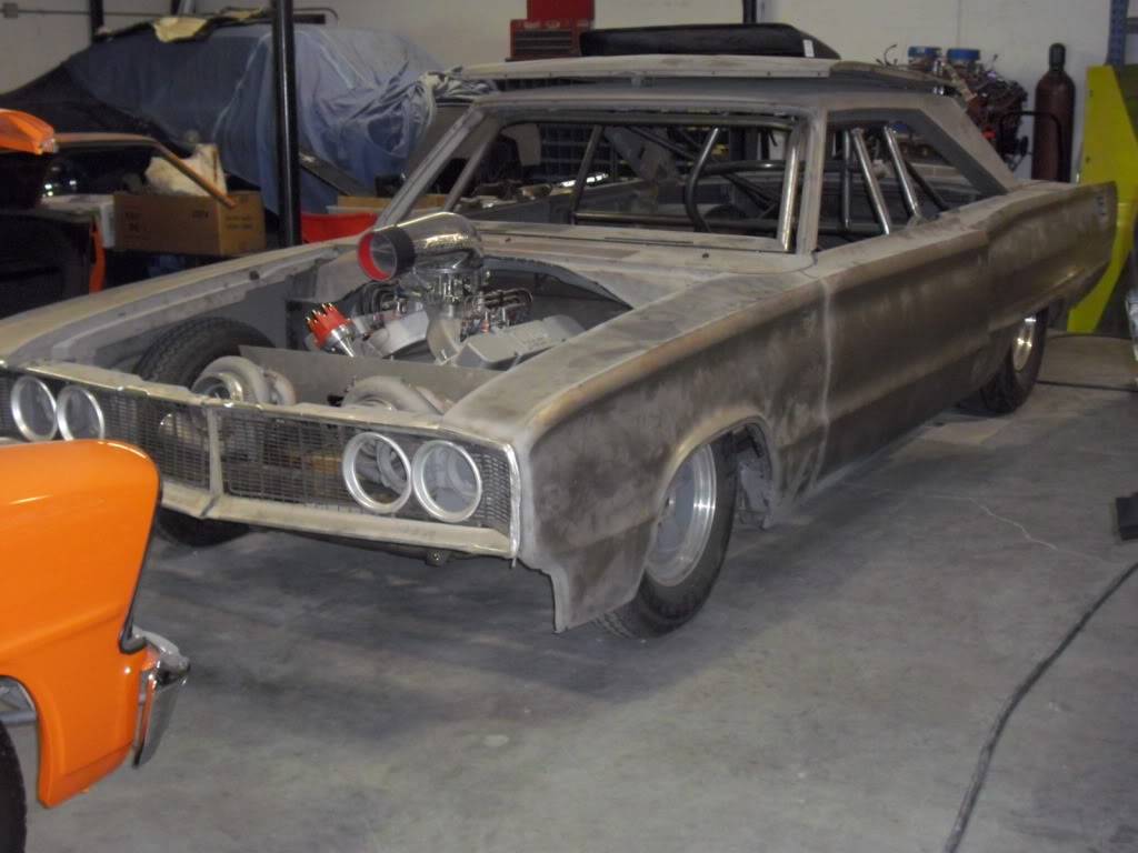

here are some pictures, this is where the project was taken over from the original owner and turned into the twin turbo nightmare

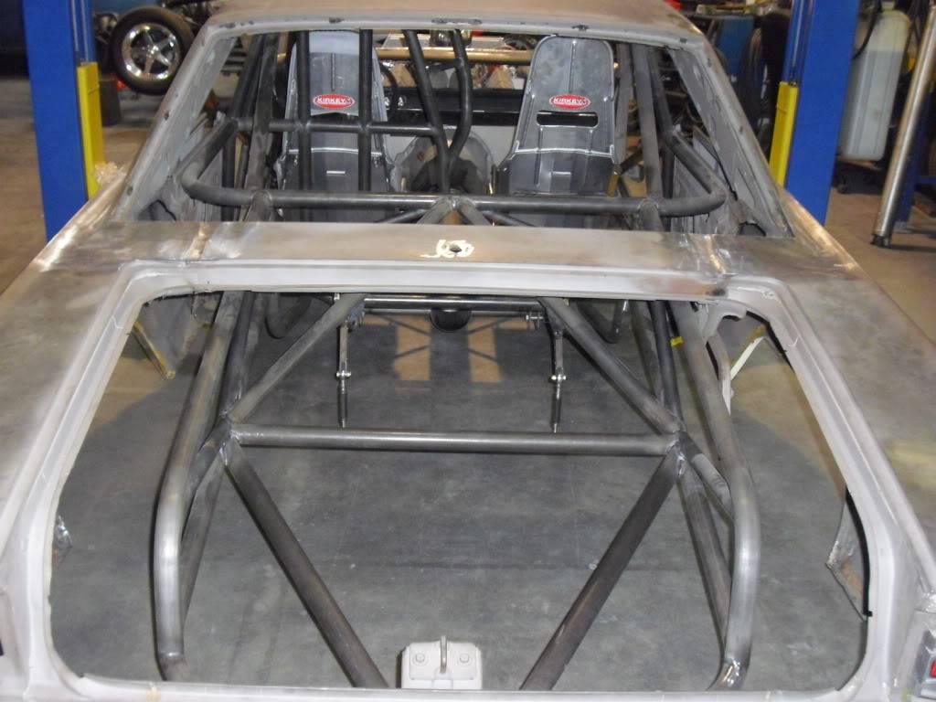

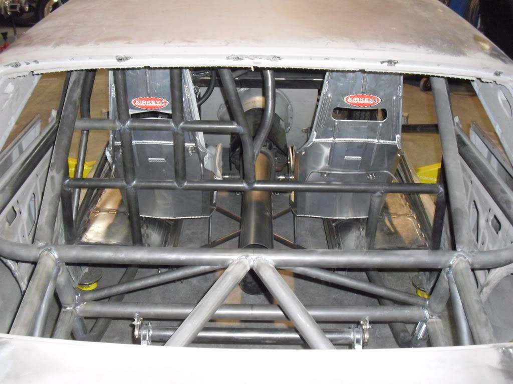

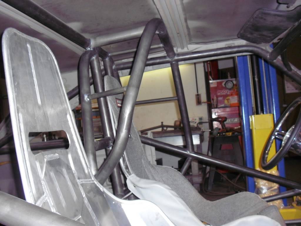

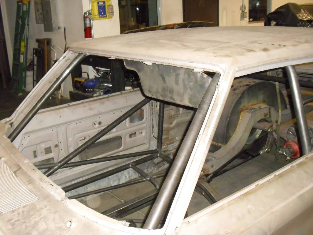

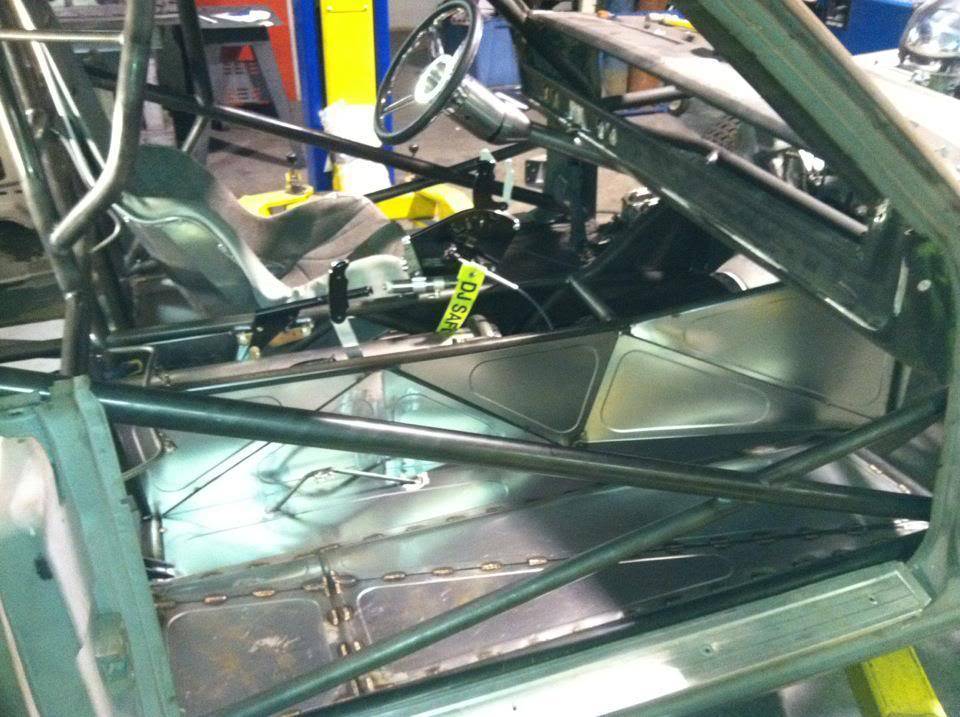

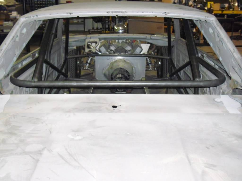

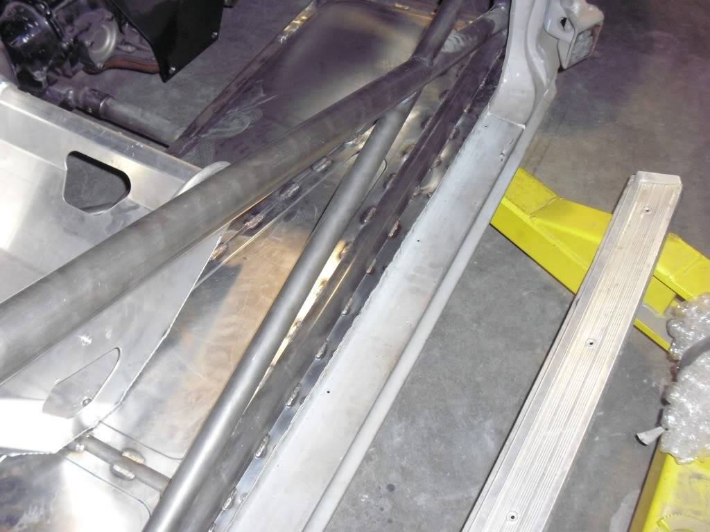

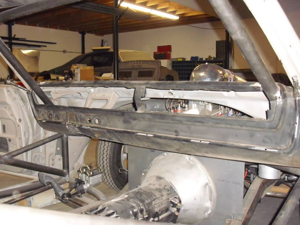

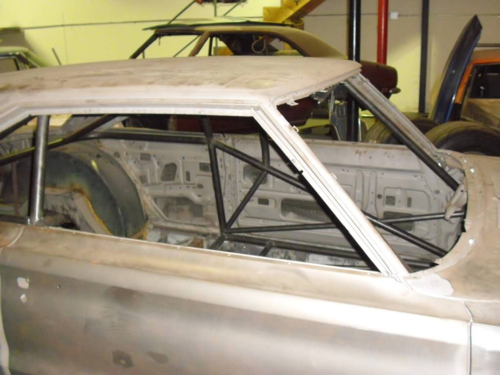

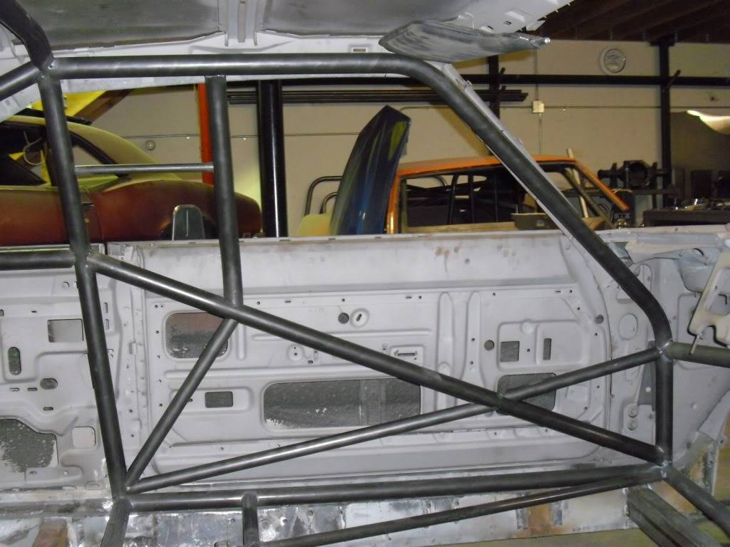

the start of the new cage chassis, put a lot of effort into hiding the cage within the body lines of the car, obviously nothing will hide a funny car cage though

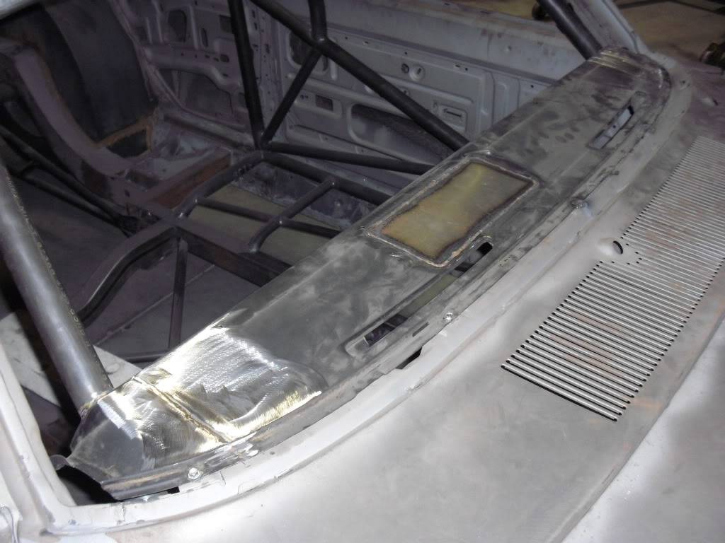

the dash is split in two, the top half is now permanent and the bottom half comes out on dzus fasteners to access where all the electrical and computers will be
more to come

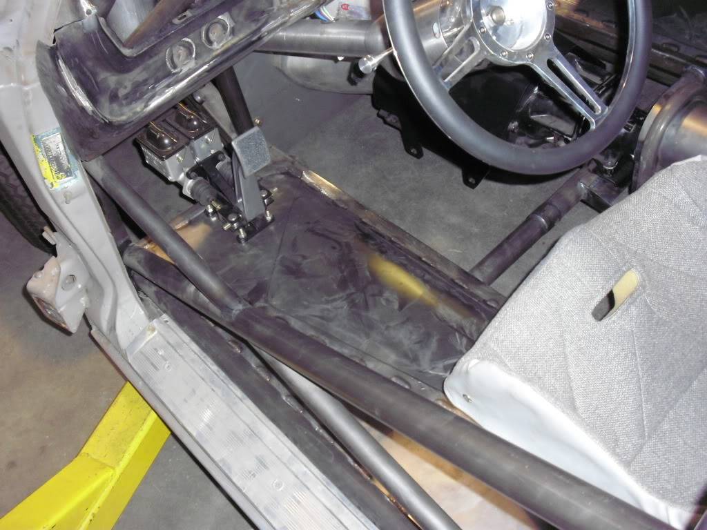

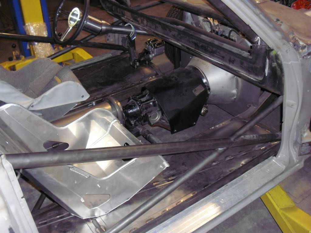

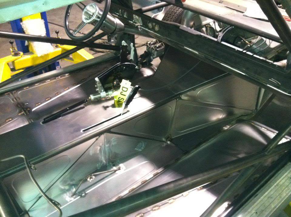

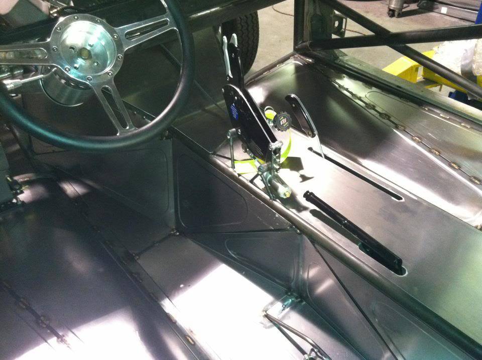

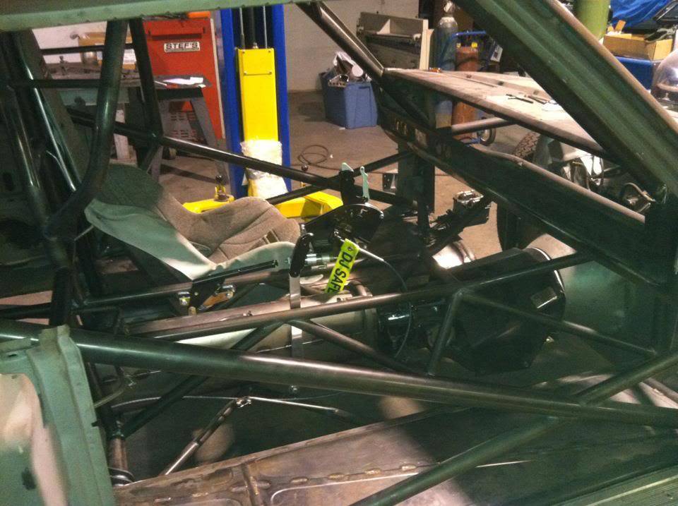

decided to double frame rail the car and integrate it into a console. All of the controls for the car (parachute release, e brake, fire handle, shifter, cables, etc) are installed in here and keeps from routing the cables throughout the interior and back window, trunk area. The top is removable to access transmission, driveshaft tunnel etc.

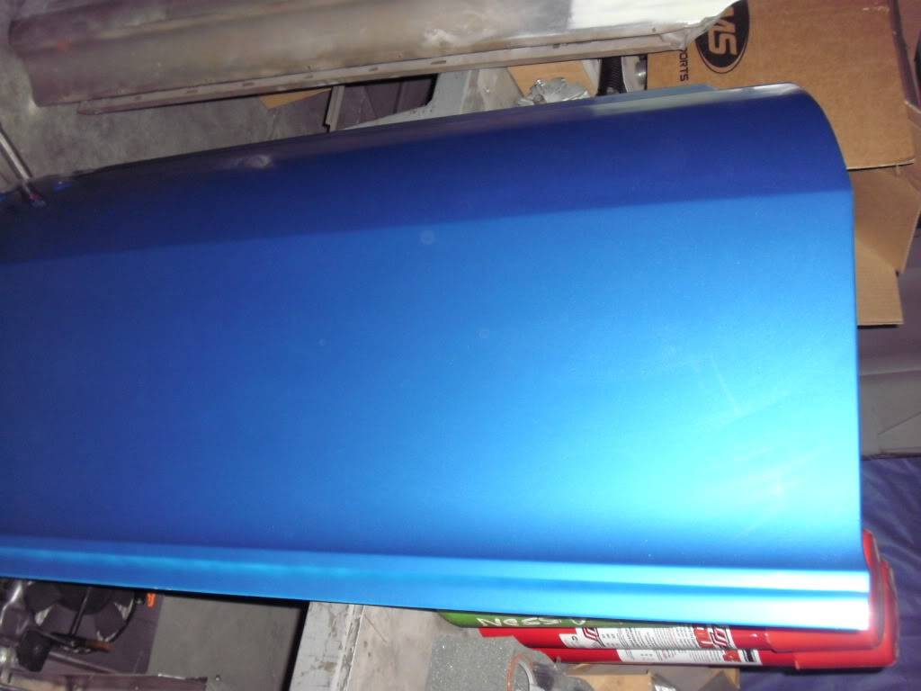

and pretty much decided on this color for the car

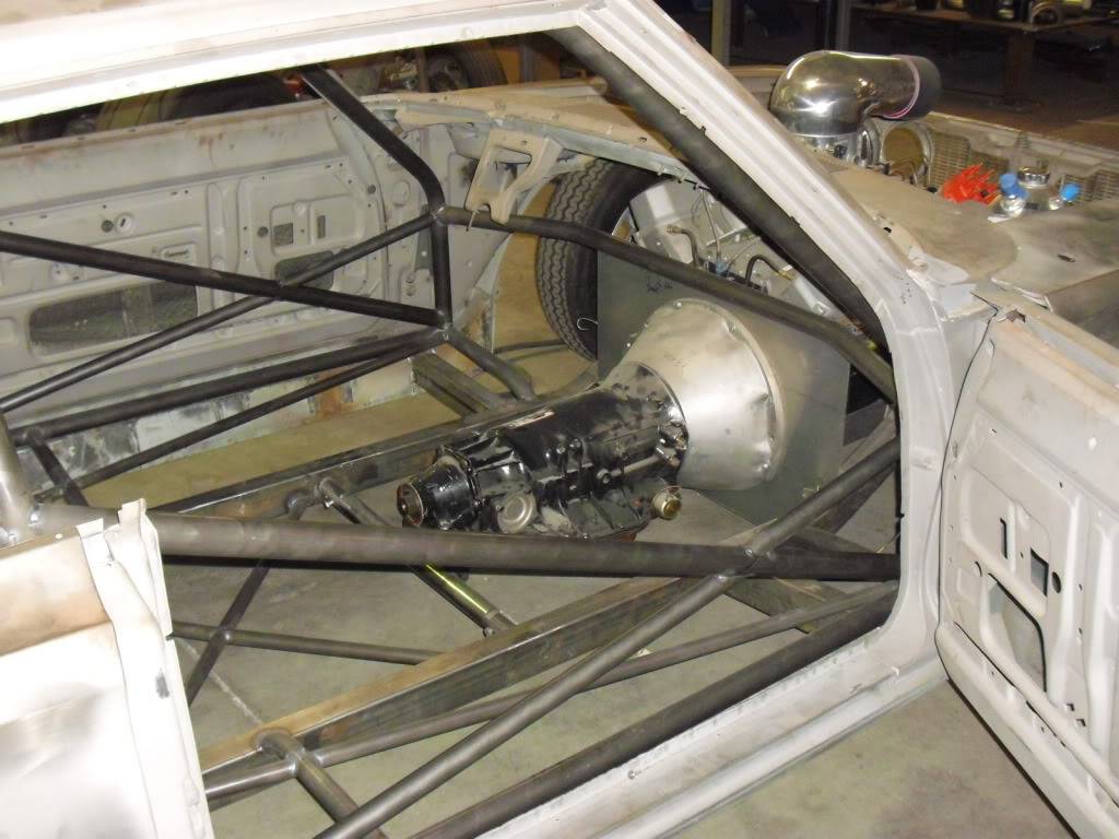

Do you any close up pics showing how the steering column is mounted?
right now the column is temporarily mounted through the roll cage, it slips into a piece of tubing through the firewall upright

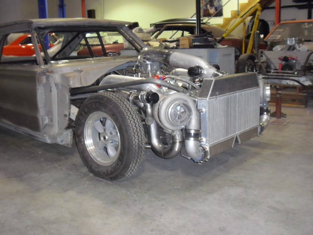

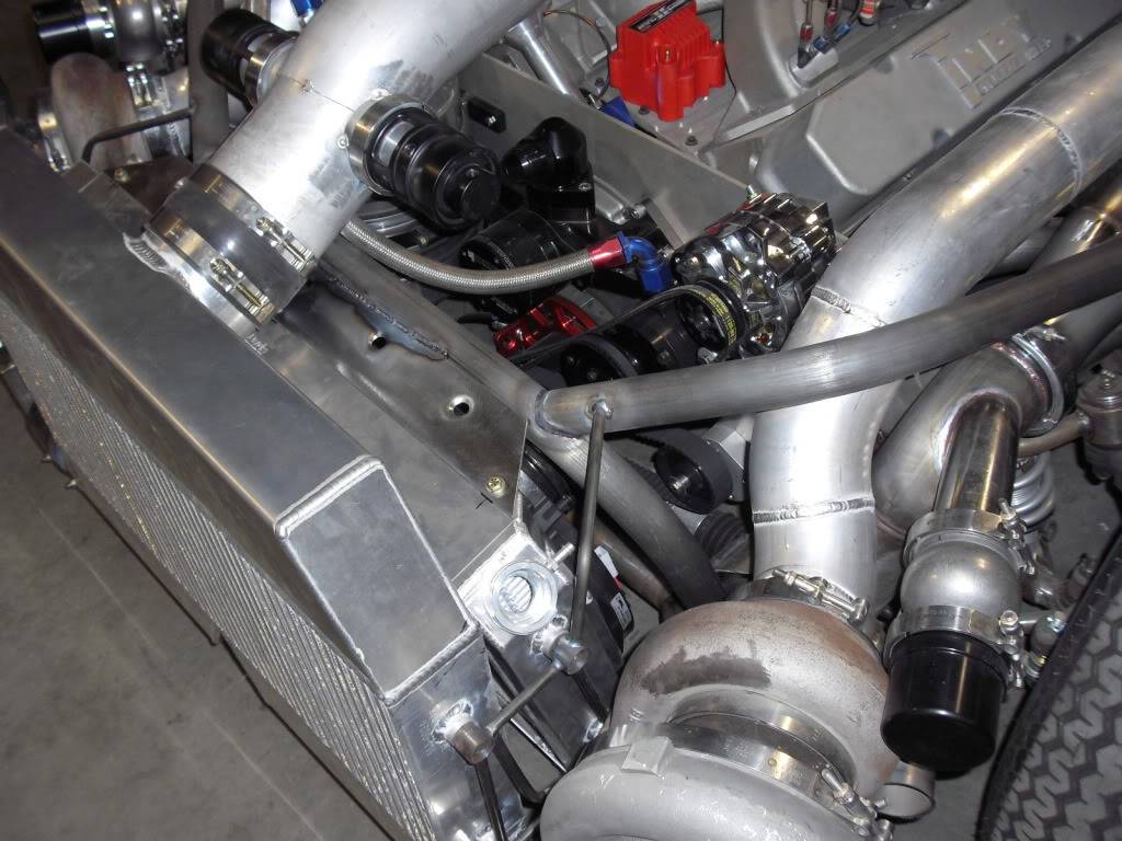

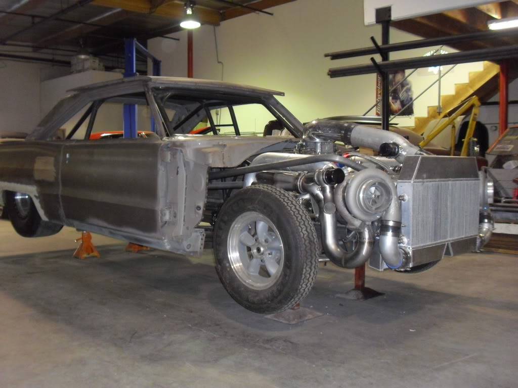

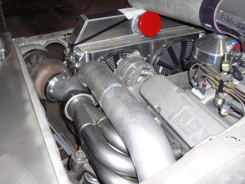

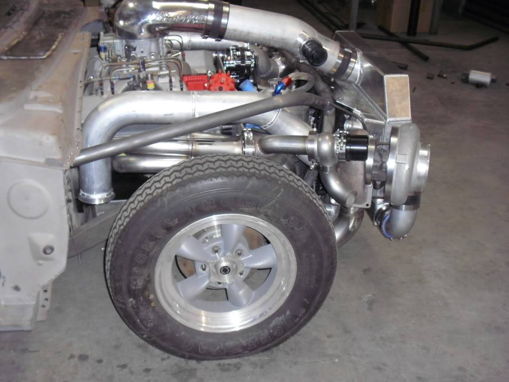

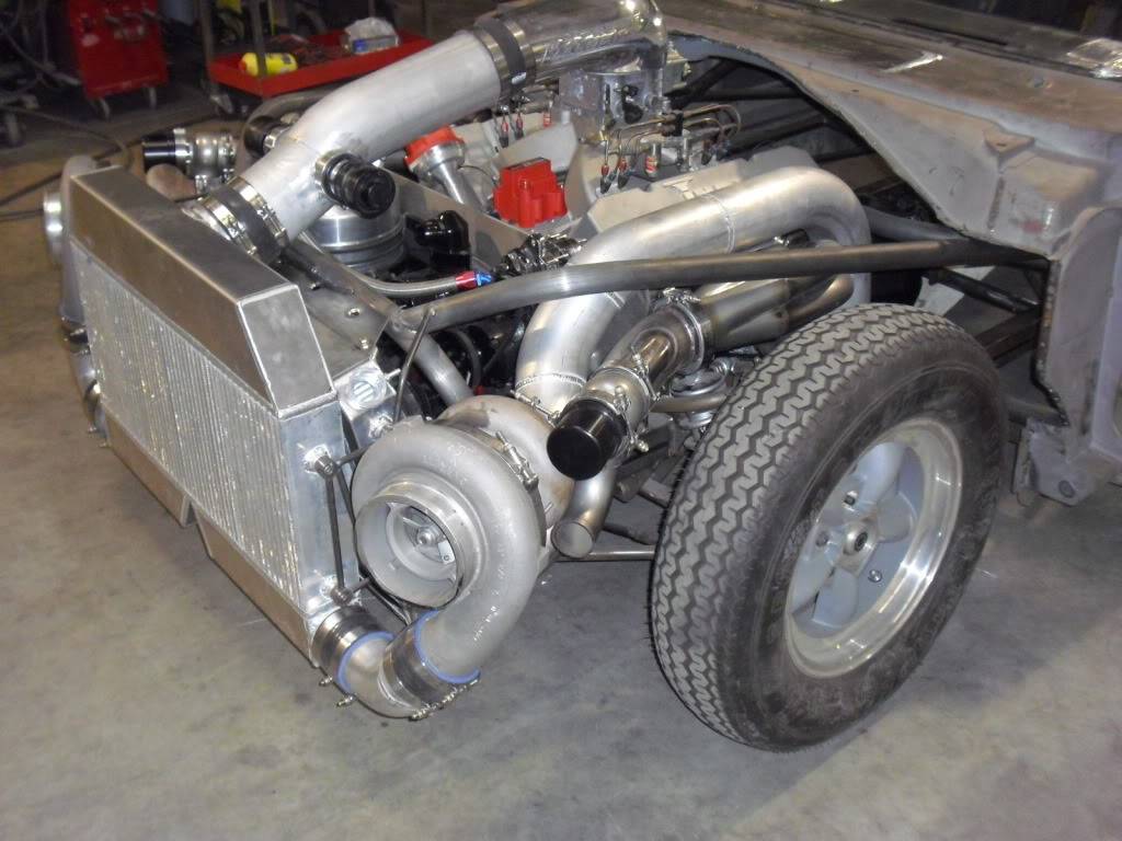

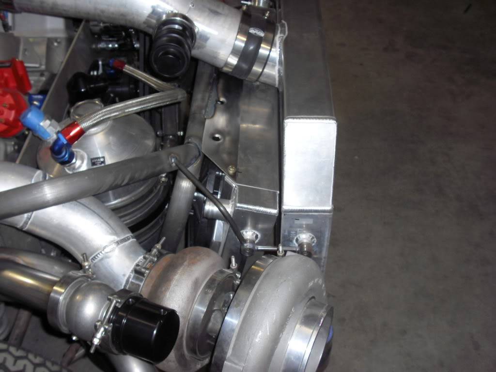

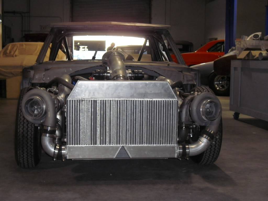

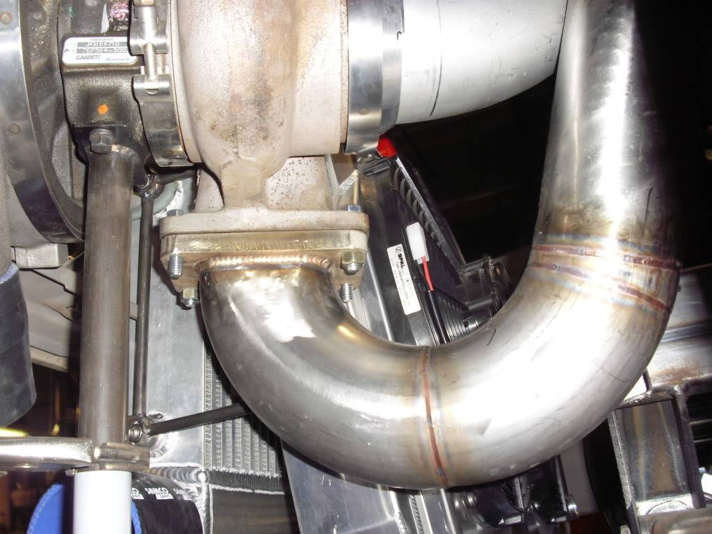

some pics of the engine/ engine compartment/ turbo system
Motor looks like they should have used that one in Back To The Future.
ill second the "Bad Motor Scooter" for sure!
Do you mind me asking why you went with a GM trans? Looks like a 400 or 700?
Turbo 400 by rossler. Main reasons. Strength (this motor is capable of 2800 hp) price. Safety. Gear ratios available. Converter selection. And it has been proven on other cars of mine that make 3-4000 hp.

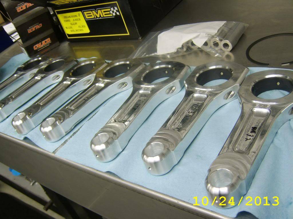

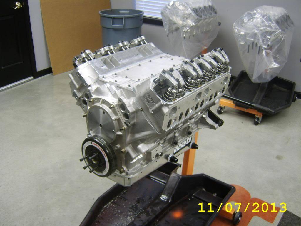

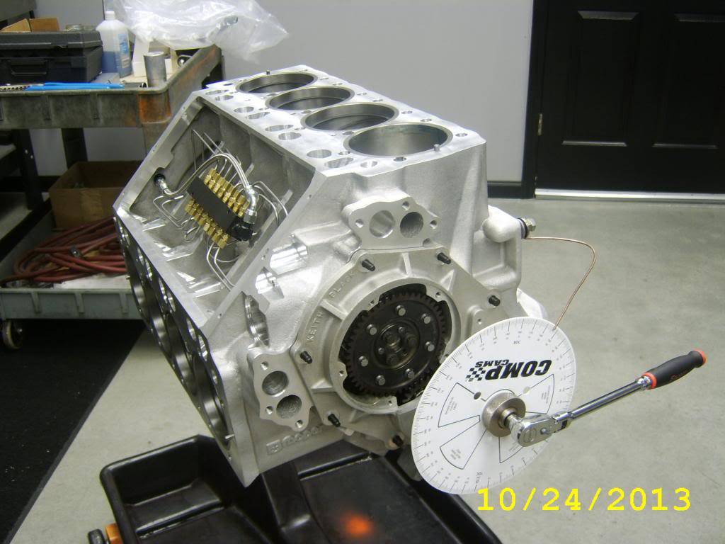

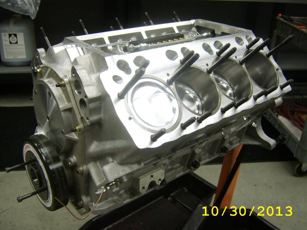

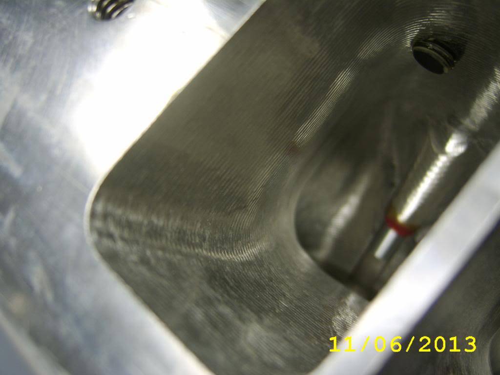

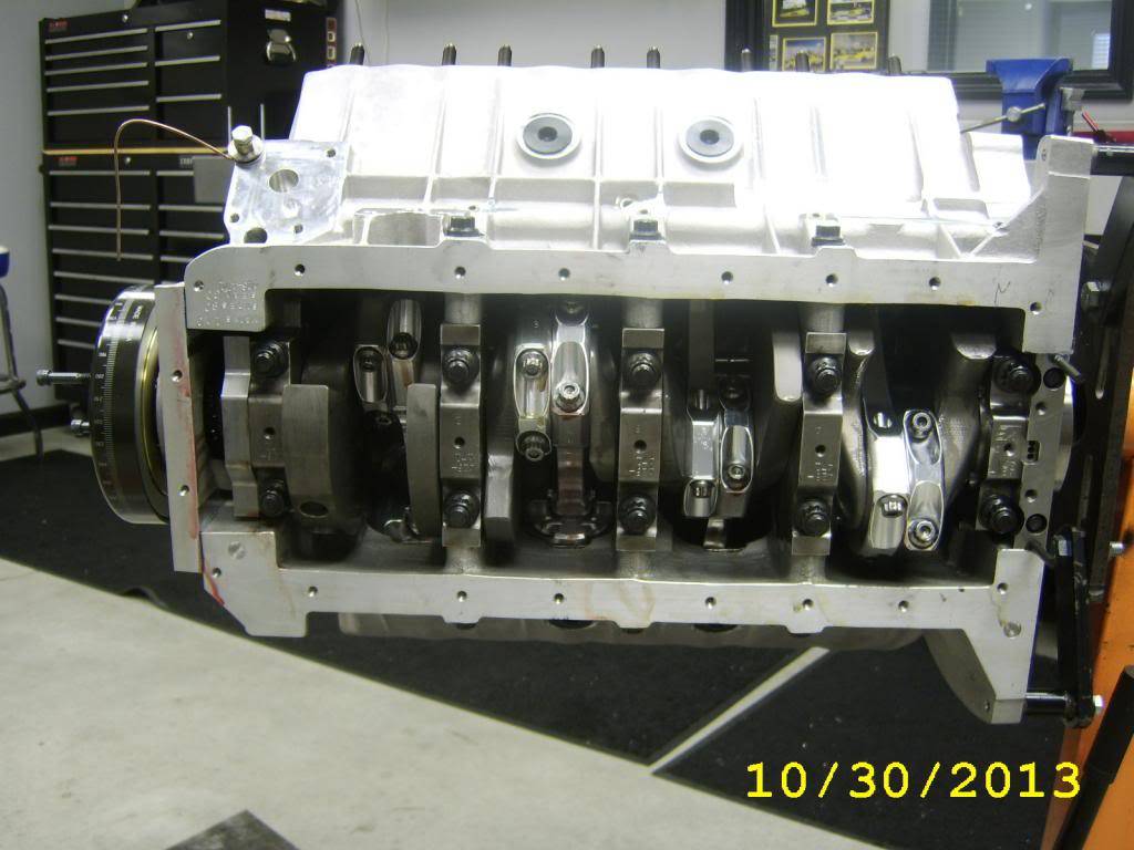

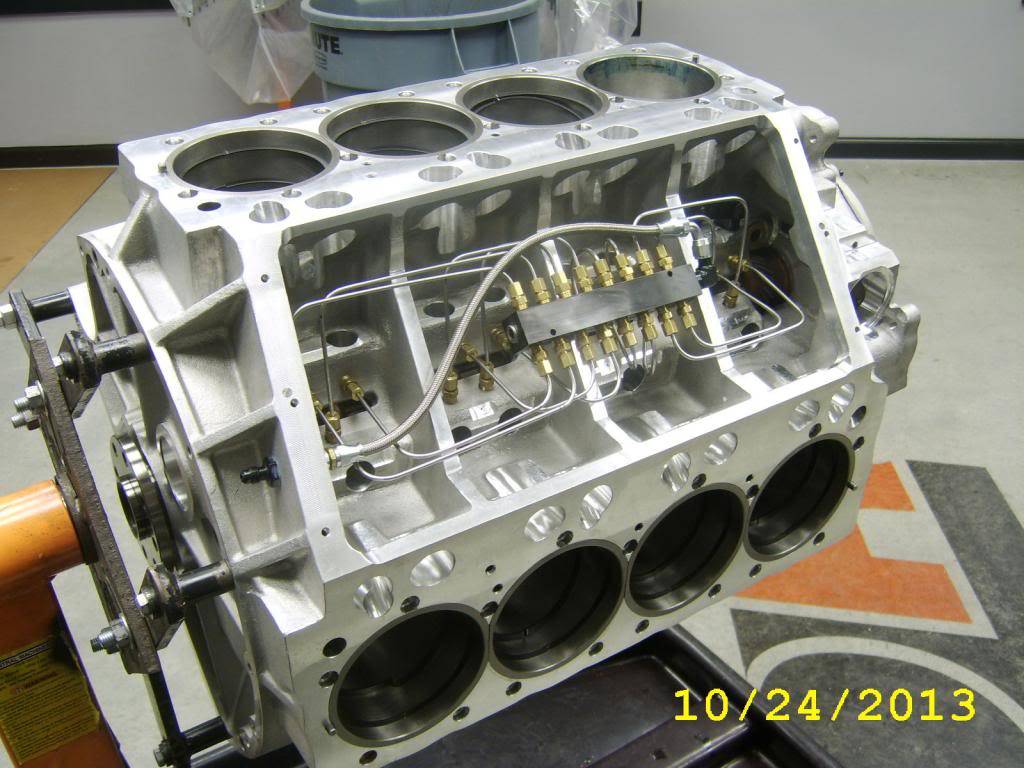

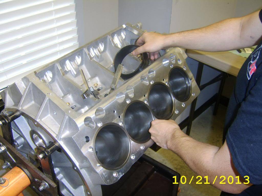

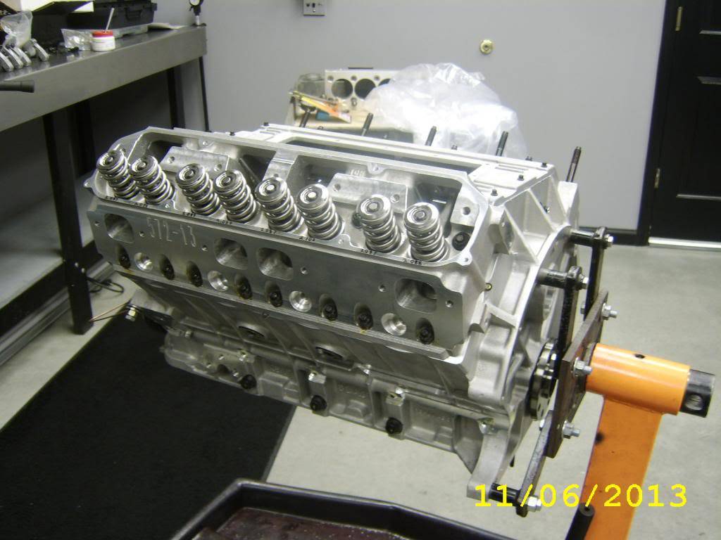

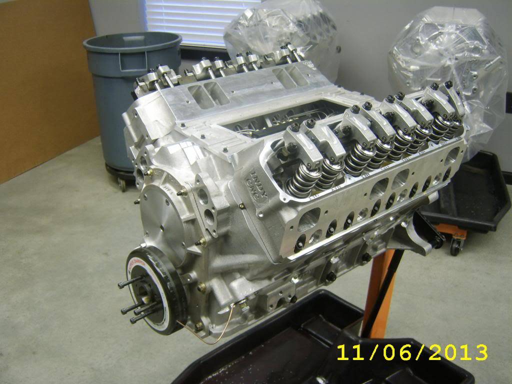

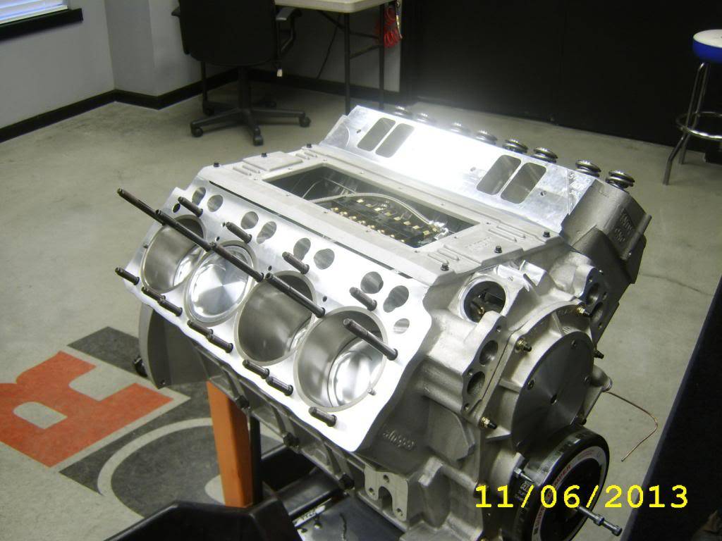

Well its been a while since I posted any updates......so here is the motor
will post some more pictures of the car in a bit

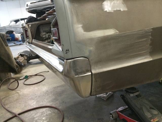

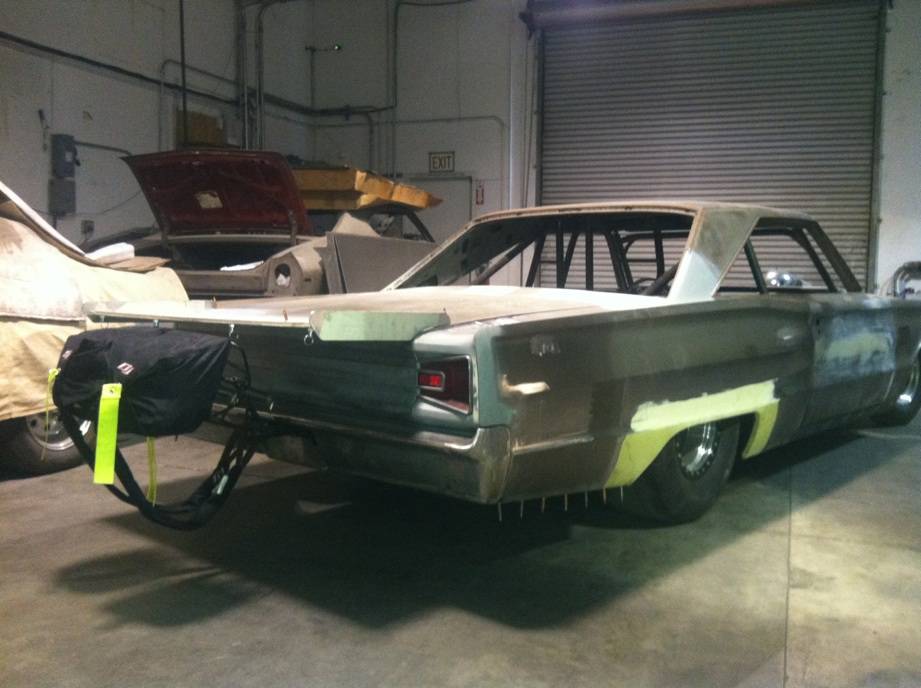

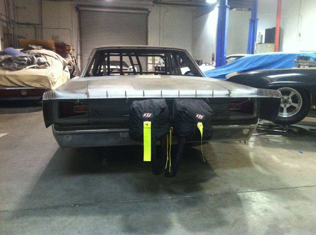

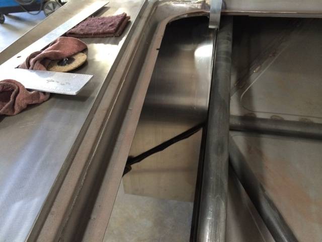

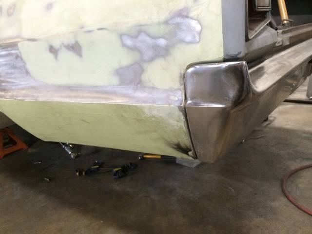

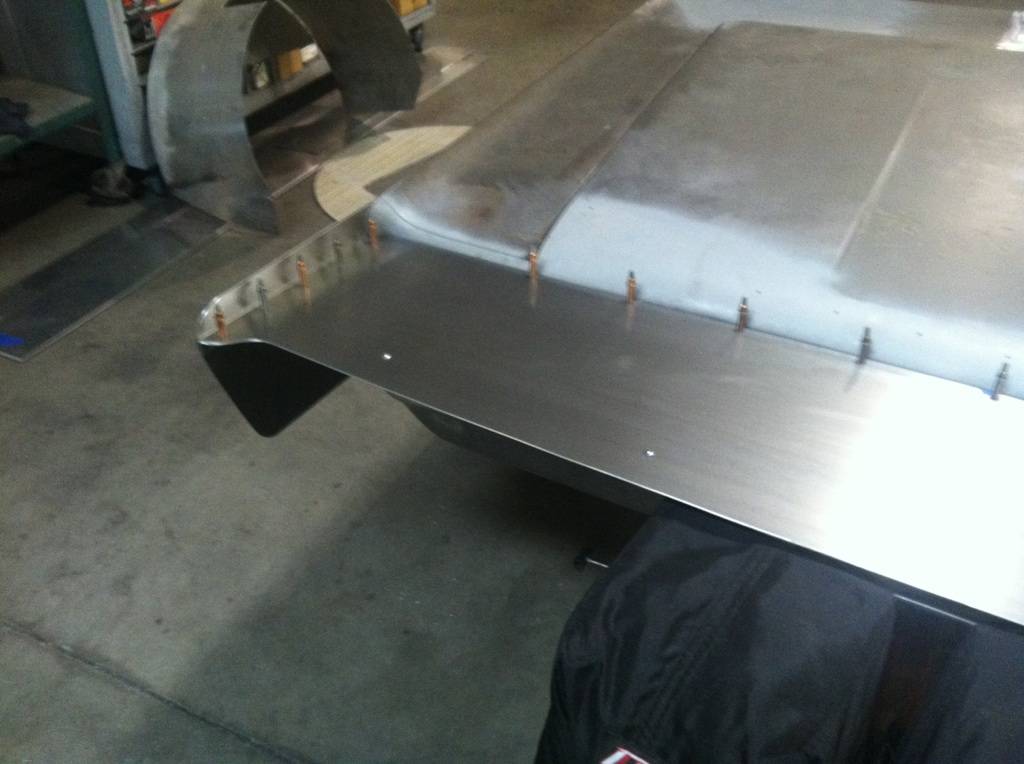

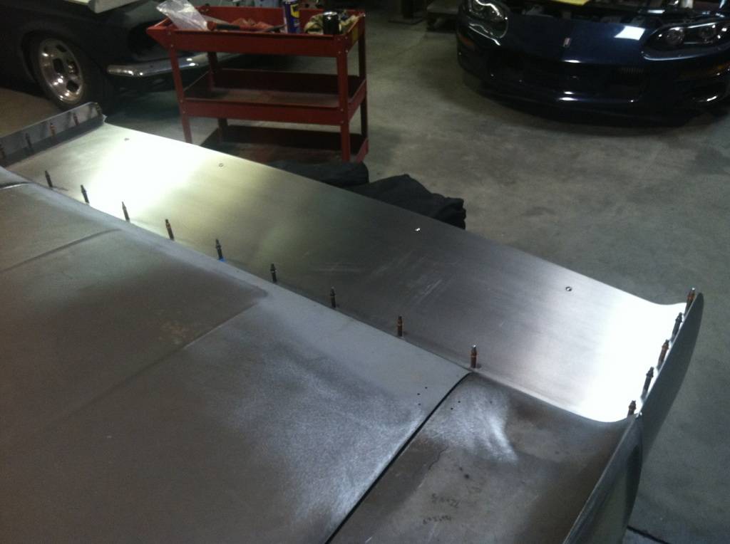

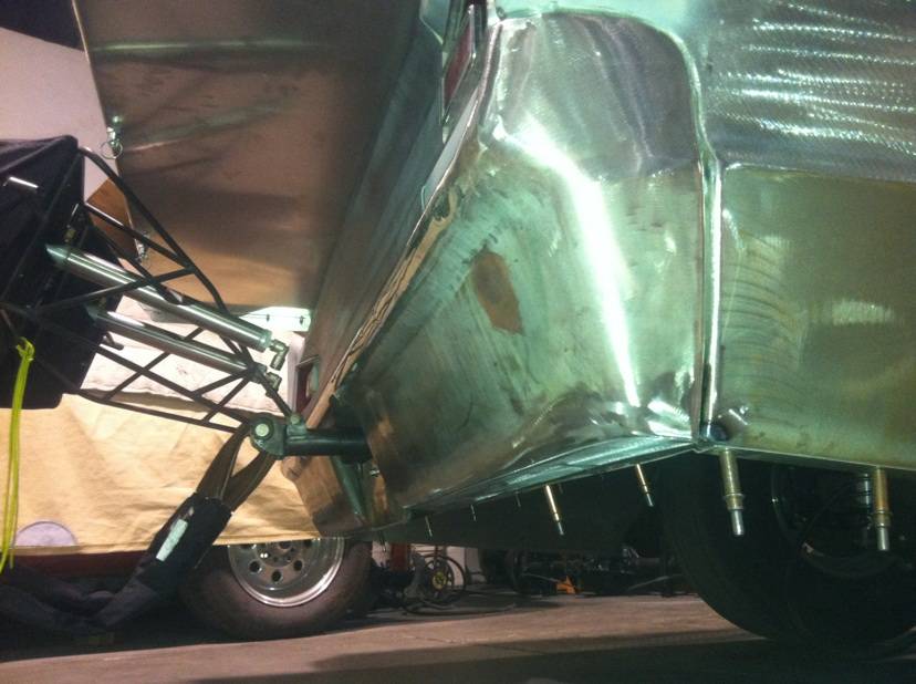

The rear of the car has had extensive modifications done. The decklid was smoothed out, no mouldings, and removed the reverse lights from the decklid. The quarter extensions were smoothed out and the center lense will now be replaced with a reverse/clear lense. The surrounding light will be the running and brake/turn lights. The rear bumper has been cut, channeled, sectioned, pinched, added on to and anything else you can imagine, along with modifying the body to compliment the lines. The underside of the bumper is smooth and works into the "aero" tin work under the car. I then fabricated a aluminum wing for the car that stays with the decklid.

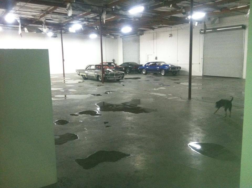

The process was slowed down by moving....here she is in her new work space
Here you can see the bumper finished up with the body line details added in

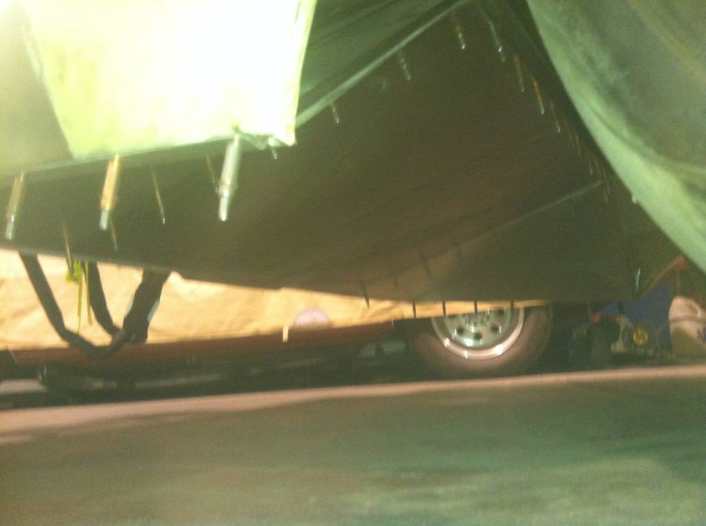

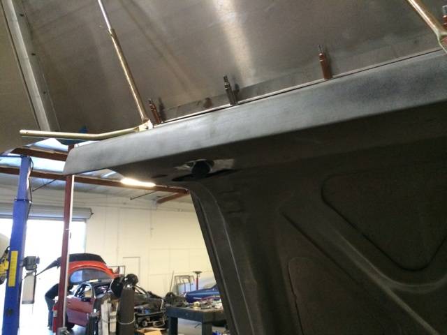

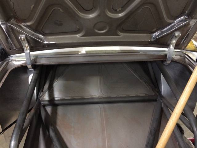

trunk bump stops

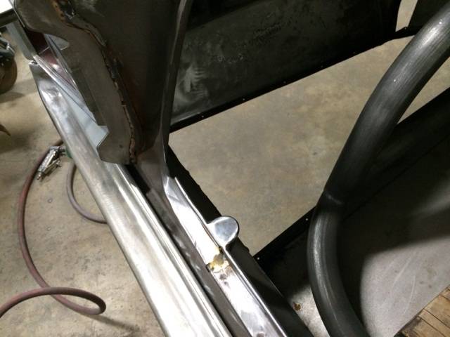

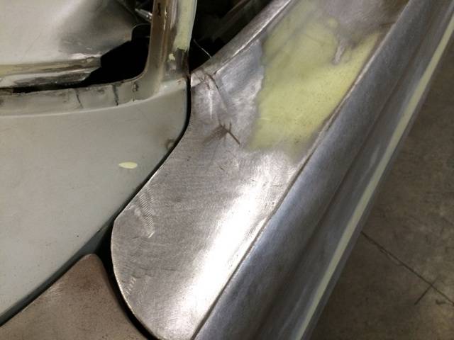

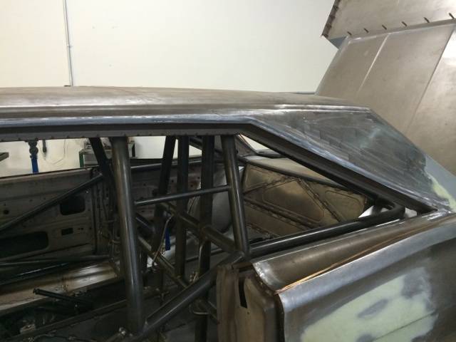

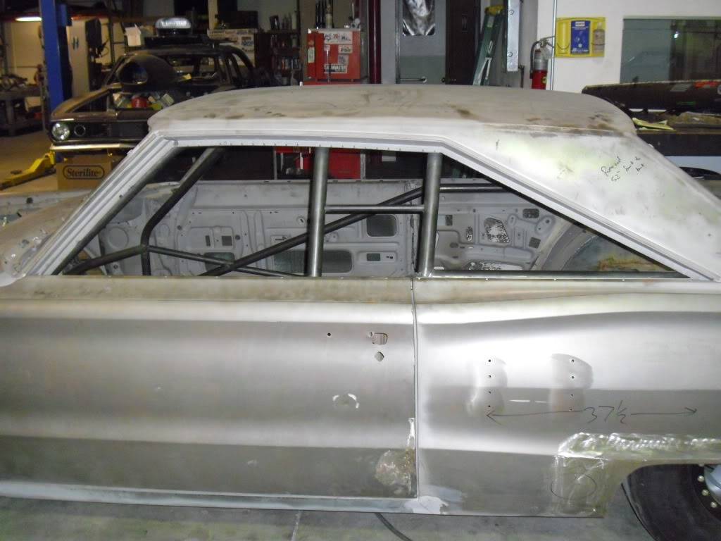

removal of the drip rail....the car is going to have flush mounted glass like a newer vehicle and we will be getting rid of the wing windows and going to a one piece door glass

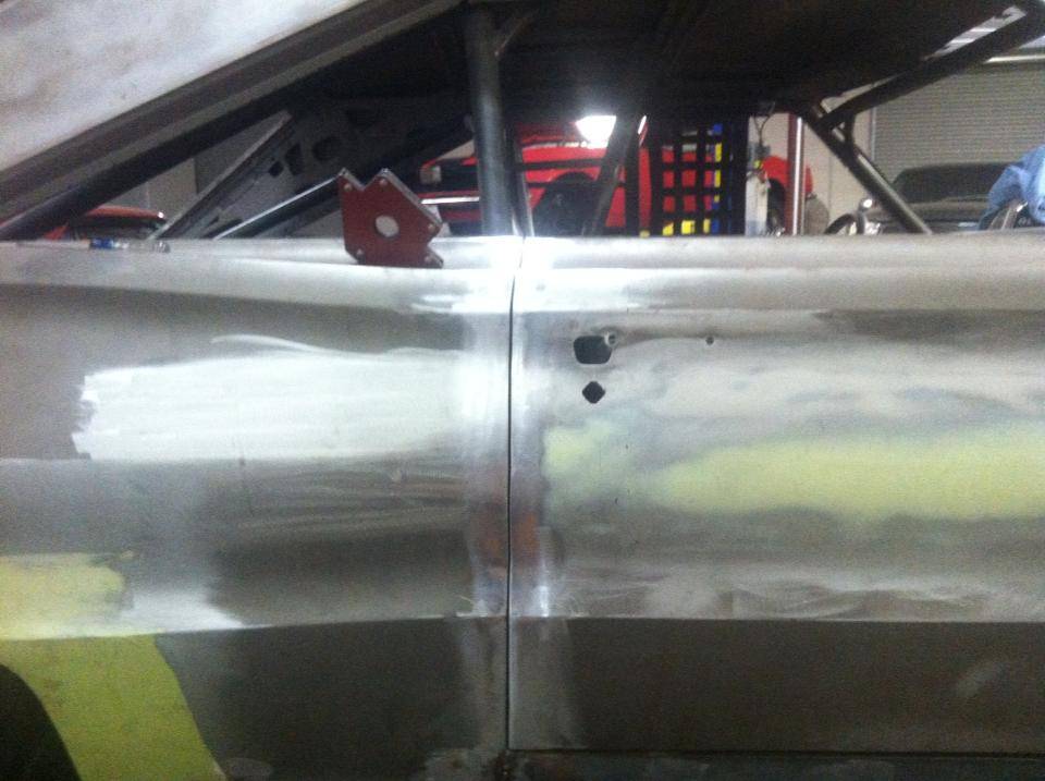

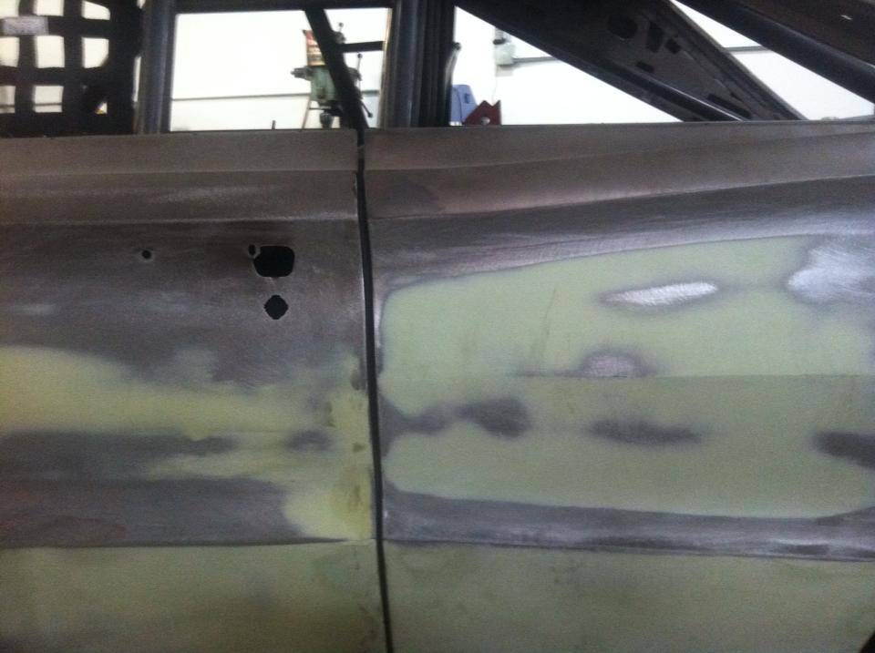

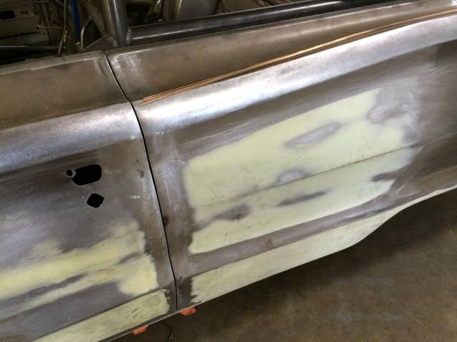

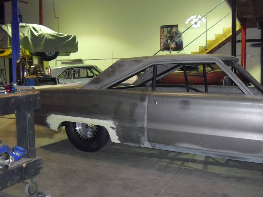

The gaps on this car were not up to standards so I went around and modified every gap on the car until it came out to .100 of an inch. The quarter panels had to be moved around on average .200 of an inch and up to .400 of an inch. You can see how bad both door gaps were and even the bottoms of the doors were added on about .160 of an inch to make them exact. The upper door/cowl has been extensively modified due to going to a one piece window you would see the voids left for the wing window.

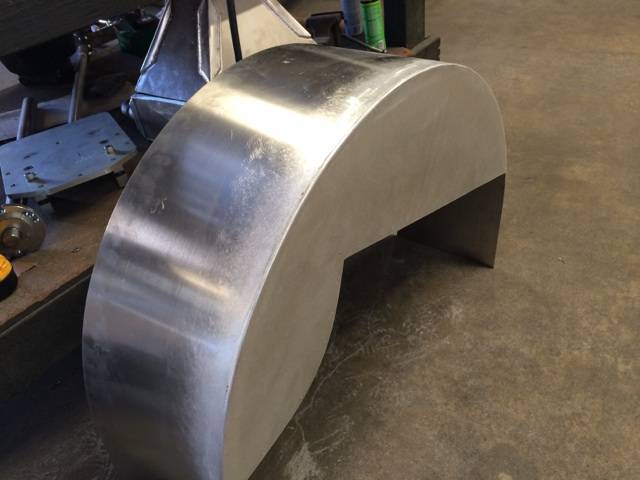

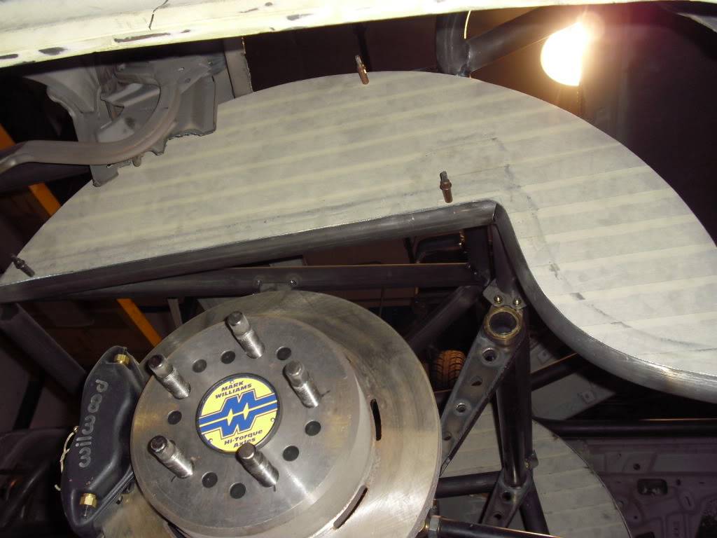

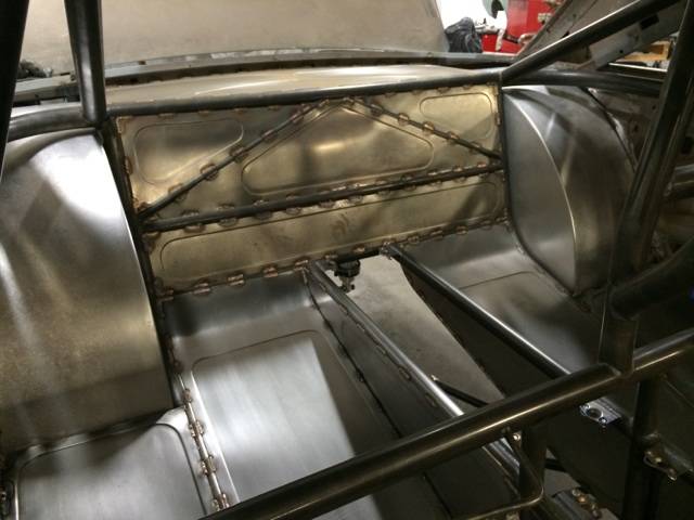

Now onto the wheel tubs and rear tin work. The tubs are hand made from .090 aluminum and made to look like they are one piece
