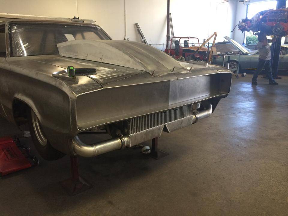

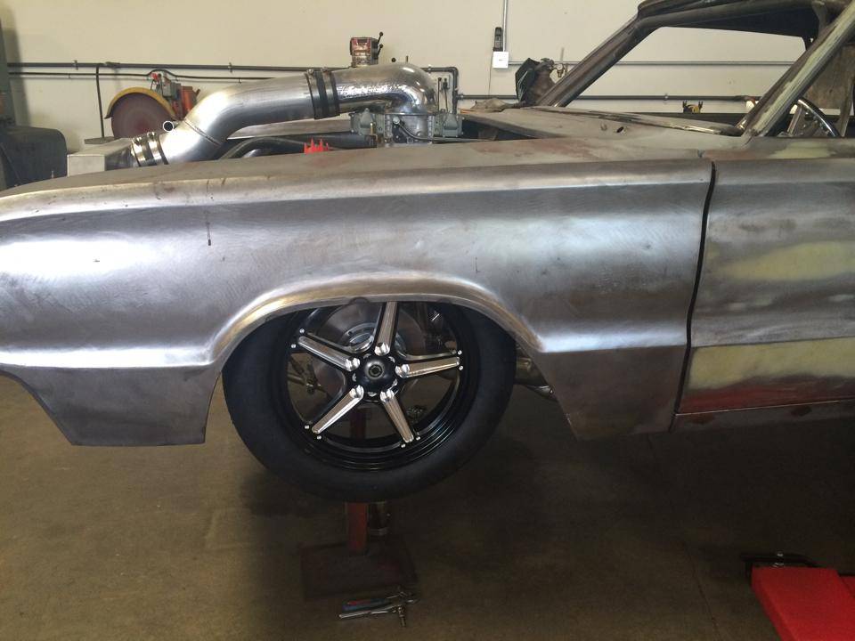

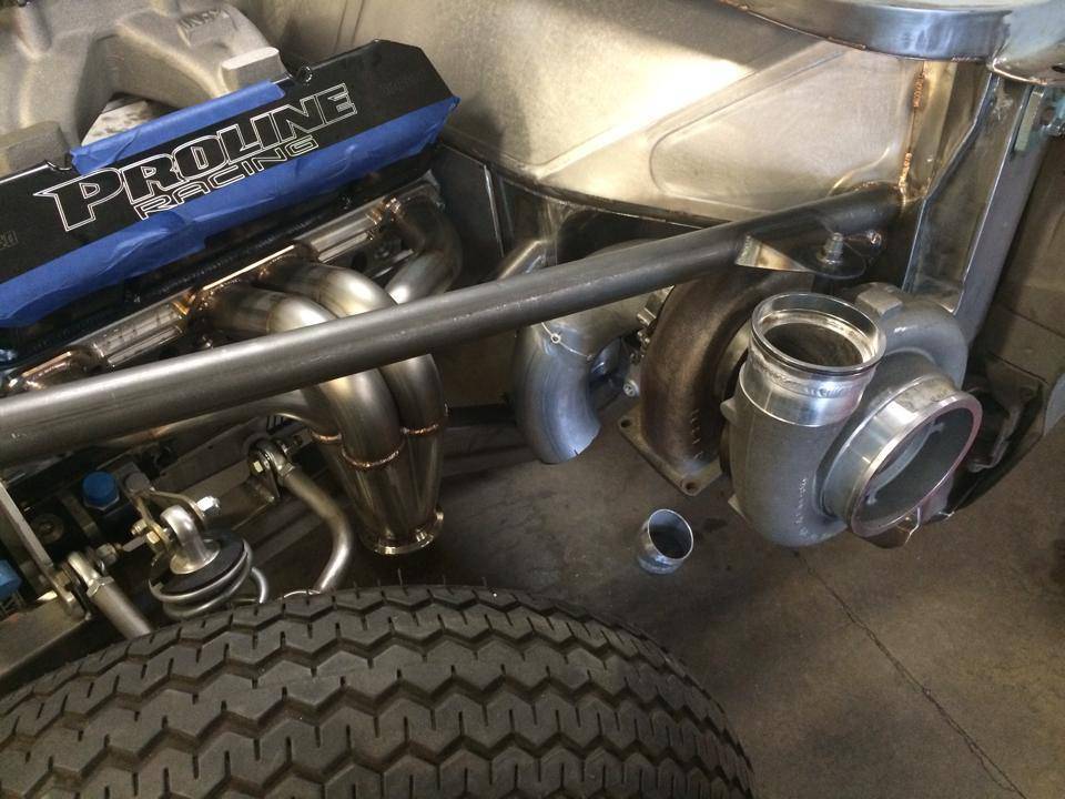

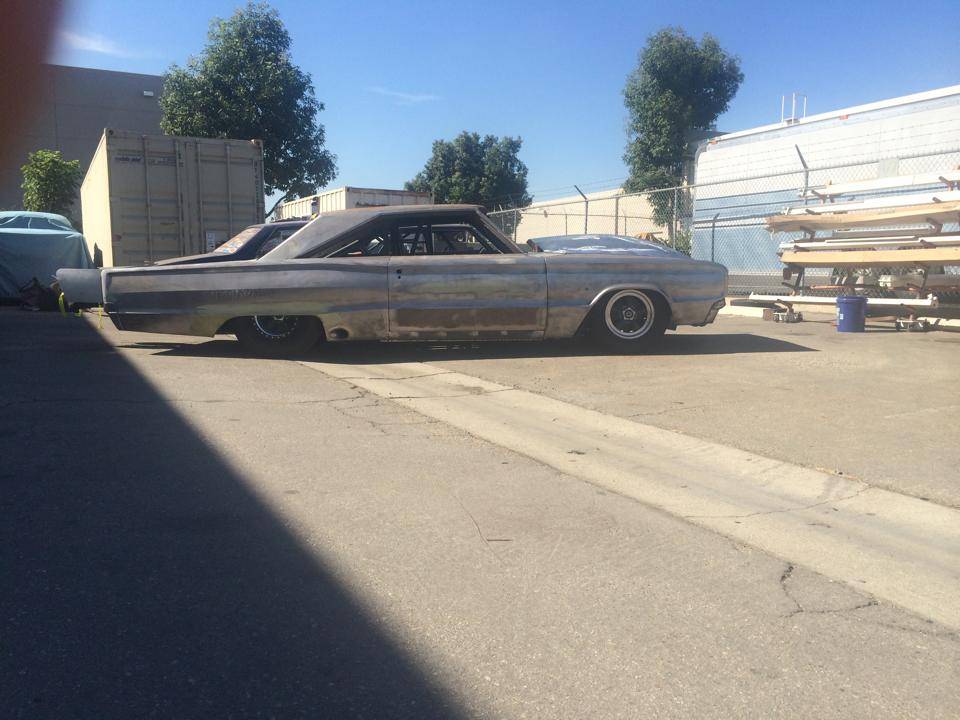

had an idea hit me last night and i think i am going to move the turbos from the front and put them down low behind the front tires now

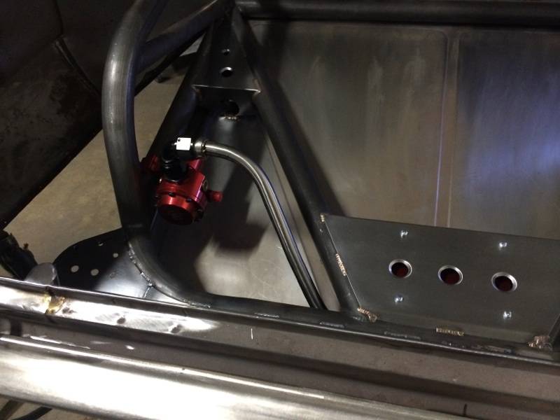

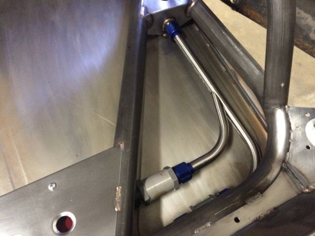

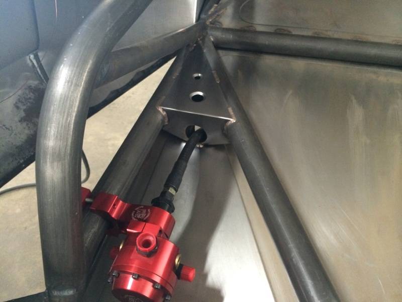

The fuel system consists of a waterman cable drive mechanical pump and a aeromotive a1000 electric pump both worked into the same line with check valves. The mechanical will support all the horsepower we will ever need and the electric can prime and even run the car if the mechanical has any issues. Also the car will be able to switch to efi if needed with no changes.

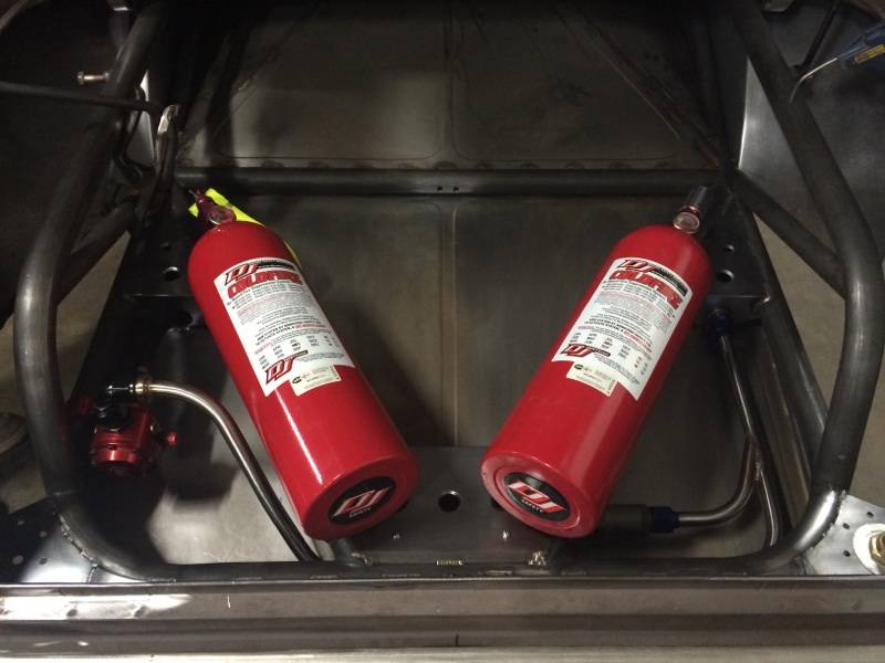

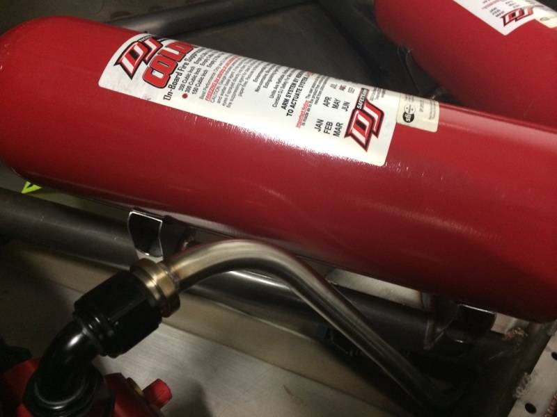

Dual 10 lb fire systems

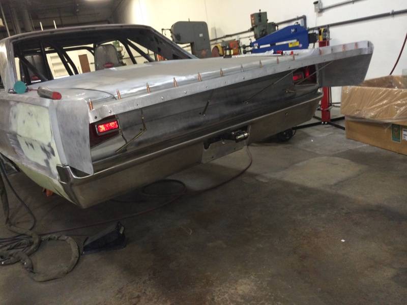

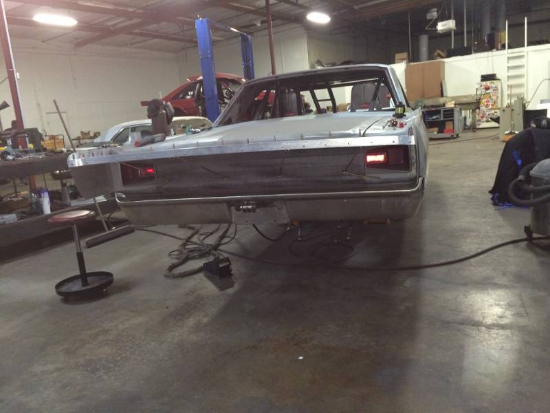

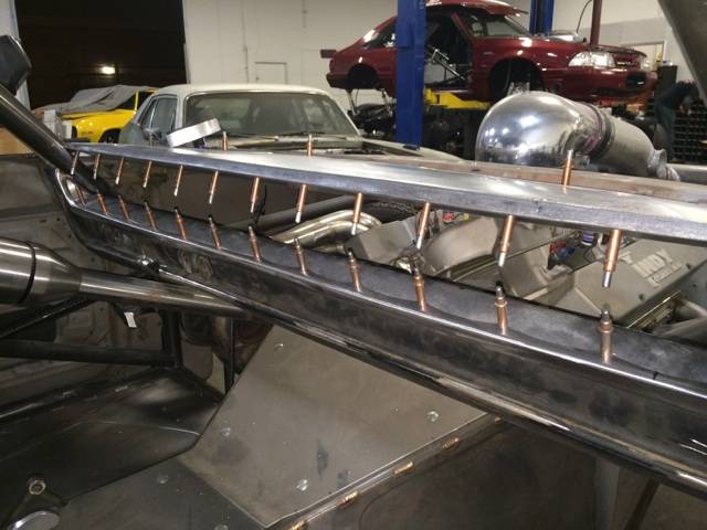

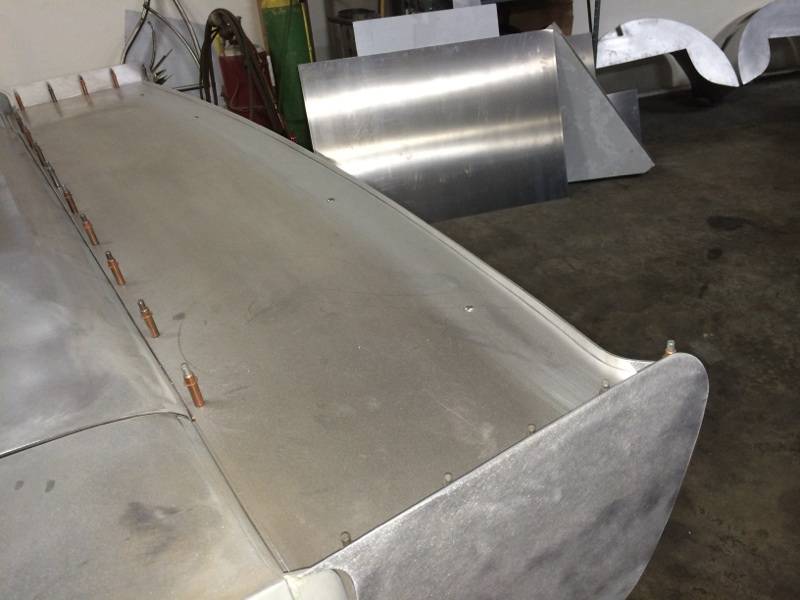

The wing finished up, wicker made, supports added

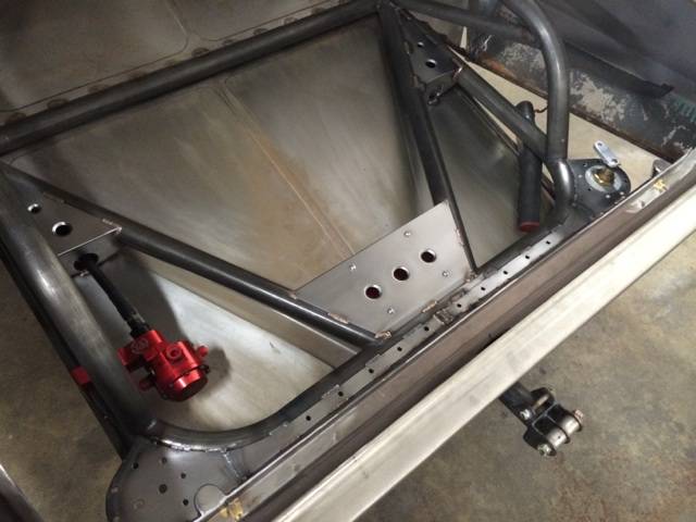

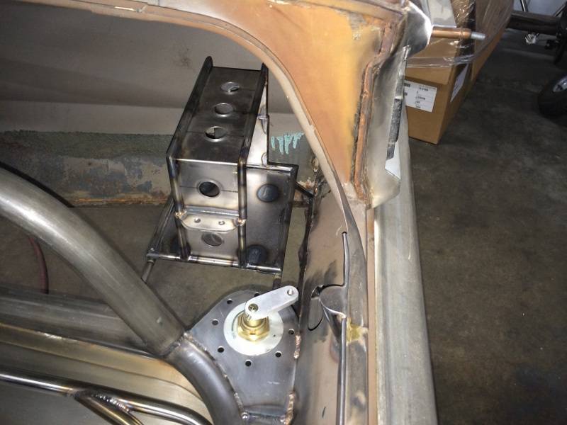

shut off switch, battery charging terminals, and battery trays
Fabricated 30 gallon fuel cell and mounts

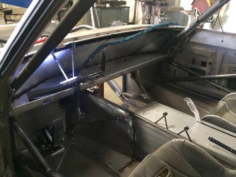

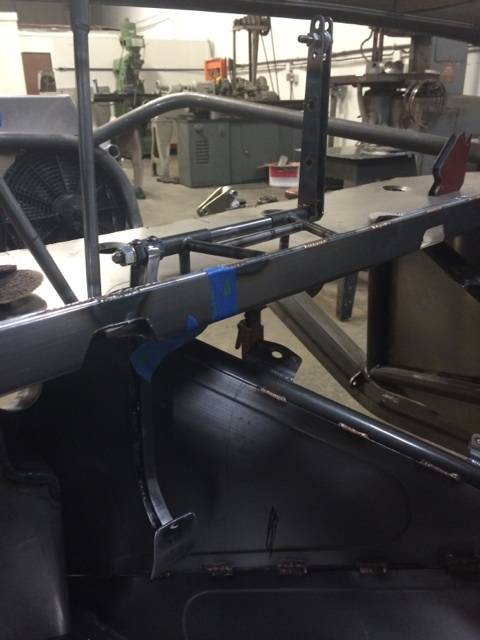

The start of the dash

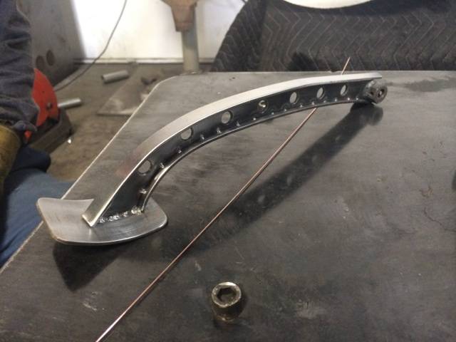

Throttle pedal and linkage

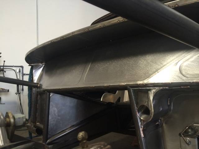

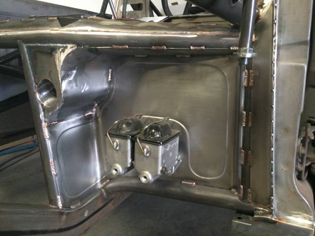

Some firewall pics

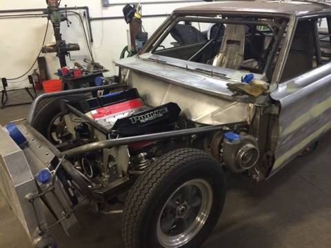

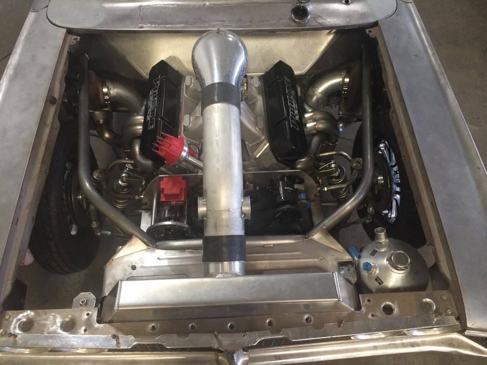

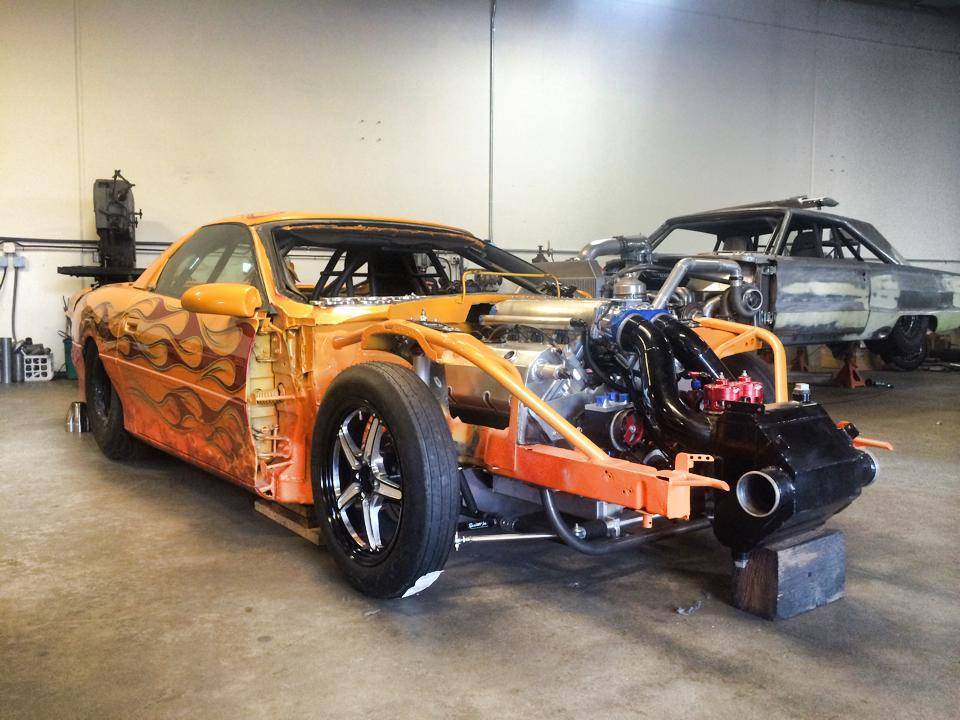

Turbos moved to their new position, motor and trans position set, new combo in car

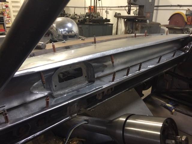

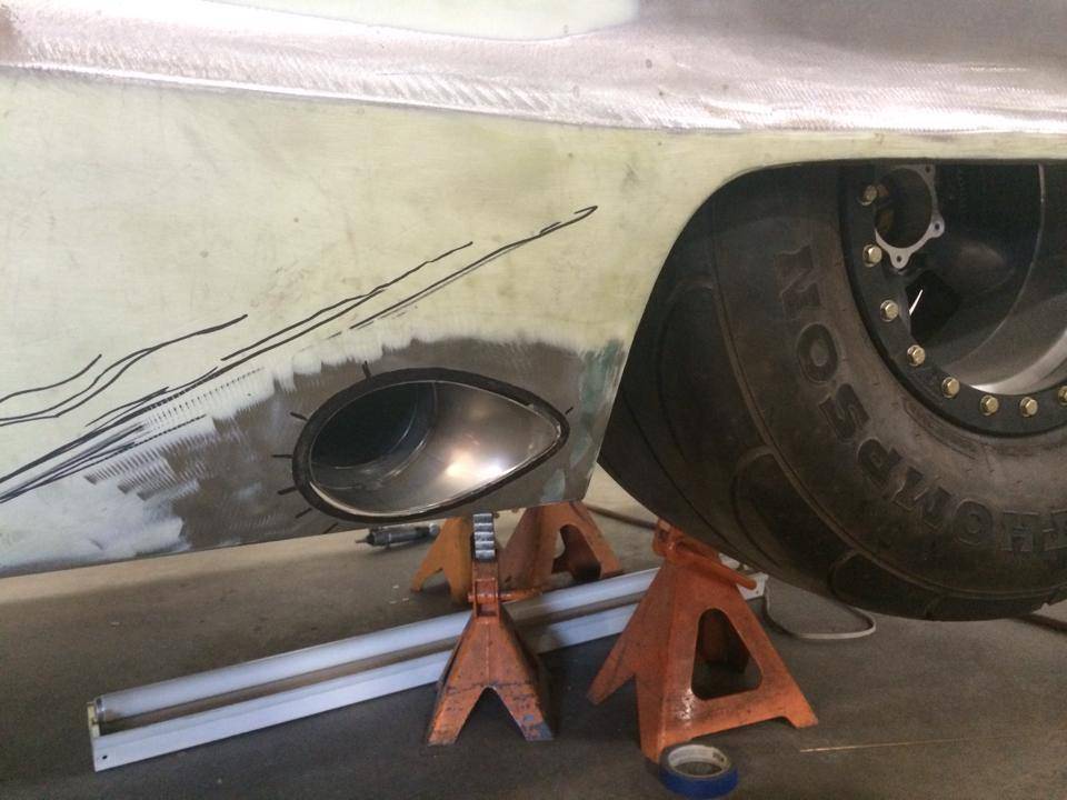

exhaust
can see the new turbo setup in the background, plus a bonus BAE hemi shot

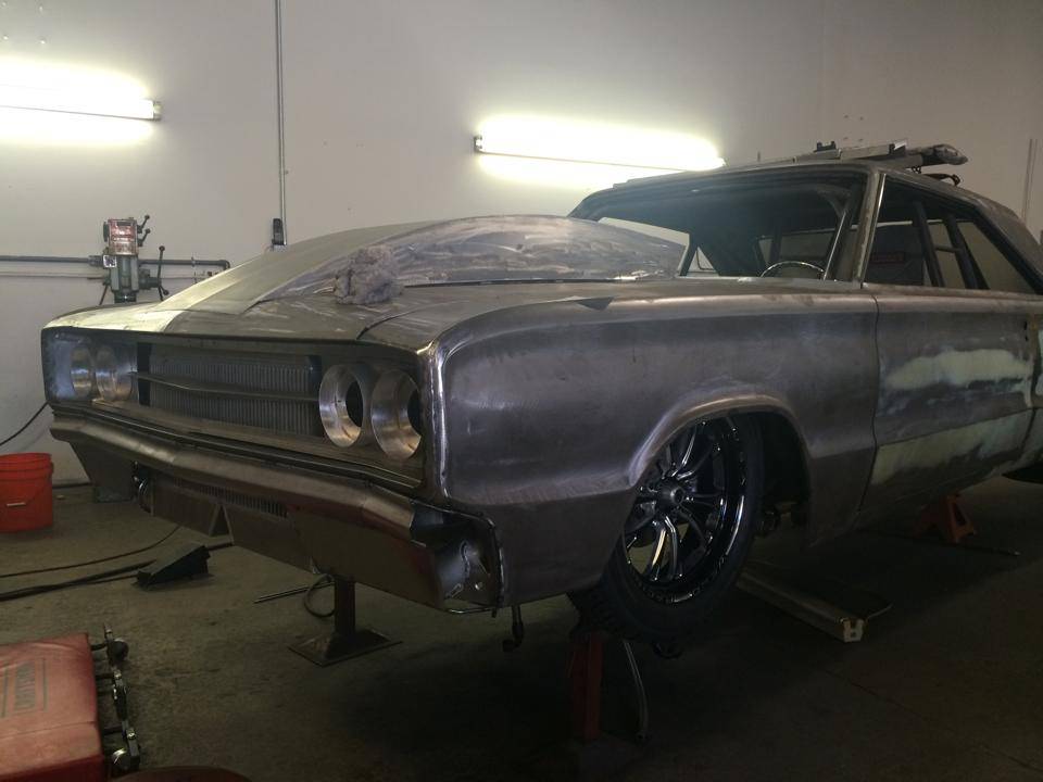

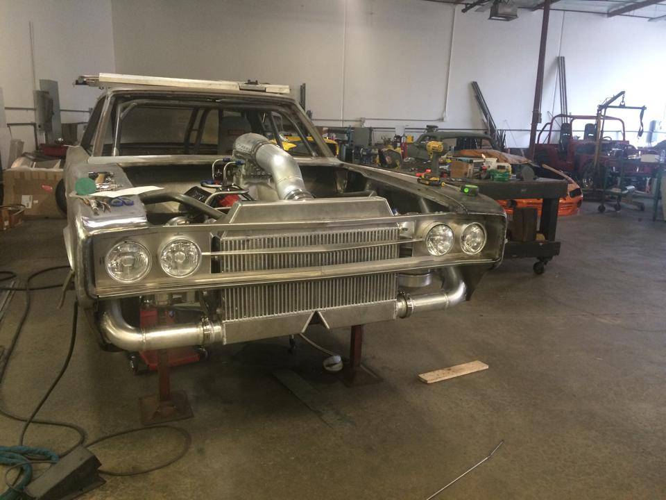

We decided to modify the front end completely
I will try to get more detailed pictures and descriptions. There are literally TONS of things that have been done but are not seen in these pictures.

Why the 30 gallon fuel cell if I may ask?
some amazing work there lp.really liking how clean the new turbo locations are.cant even imagine doing that much fab work and then changing it,nice.

We have intentions of doing drag week and it will be a car that will get driven on the street a lot. We also wanted to have enough capacity if we were to run e85. Should get pretty decent mileage on the highway but around town and stop and go traffic they do suck up fuel pretty badly.

The windows will be lexan... Optic Armor made them for me. I had to send the original front and rear glass to them to use as a mold. The sides will be getting stainless steel frames made to interlock the lexan in and help it all keep its shape and seal against the weatherstrip. The front and rear will be glued in like a new car.
it is going to be gm supersonic metallic blue that comes on the newer zr1 corvettes. The cage will be a silver color and interior will be black and be upholstered like a factory 60's muscle car just a lot nicer than factory stuff

Every machine in the shop has been on full tilt.....we joke about how many filler rods we have probably used on this car. We have even had to make a bunch of tools to get what we want out of stuff. All sorts of forming dies for the bumpers and grille stuff.
Wow!!!!!!!!!!!!!!!! I'm in love, that car is flat out wicked. I really like the exhaust exit too "super cool looking". The quality of your craftsmanship is off the charts and nothing looks untouched in some way or another, I'd be scared to race it when your done with all that work in it. Sweet
