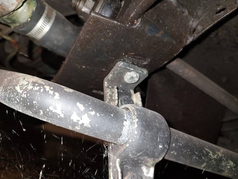

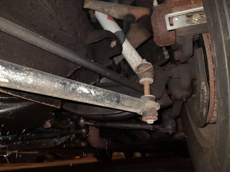

I mounted an aftermarket front anti-sway bar on my Coronet when I did the front disc conversion. Since my '66 (and the majority of others!) never had them, my bar is mounted odd. Pics posted below. Does anyone know the correct way to mount an incorrect bar? It's functional and all, it just looks like an afterthought. I may simply remove it, but after 20 years on the car, I don't want to leave it as-is. Either fix it so it looks and functions properly, or ditch it. IIRC, the bar that is on my car was for '67-'70 B-body.

I'll wait for pictures. It's hard to say as the information you provided tells me nothing. The 67-69 sway bar is easily done. A 70 sway bar cannot be done with your K frame.

The front mounts are the goofy thing here. I don't see a way to mount them like they should be. Any ideas?

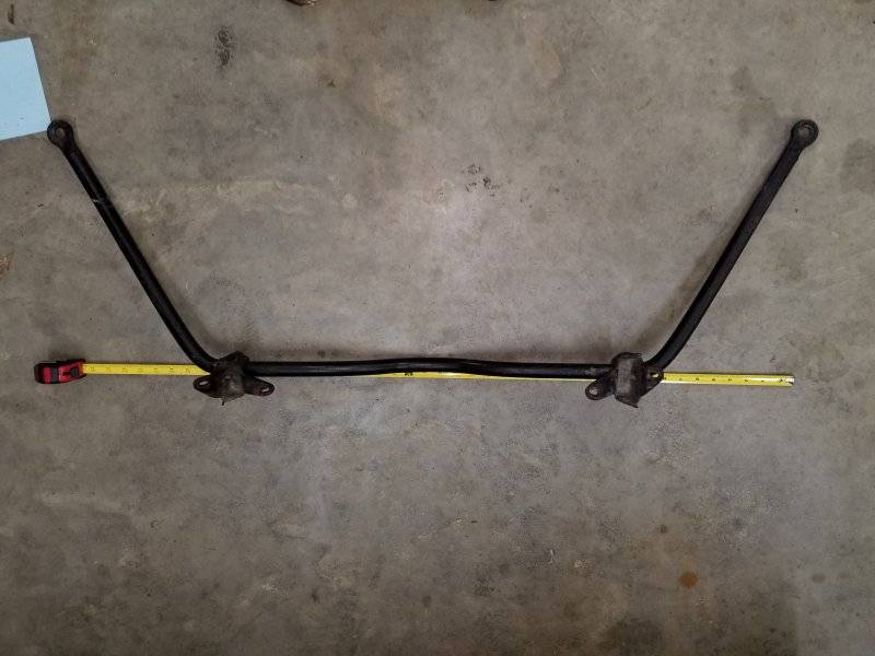

Here is a complete 67-69 sway bar with mounts. I cannot see the complete bar from your picture, but it seems that if you could locate the correct mounts and bushings that you may only have to drill two holes on each side of your K frame to mount it
correctly.
I agree with Jerry, go to a 67 arrangement.
The way its mounted currently, is not operating as a swaybar properly.
