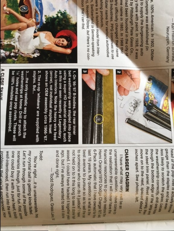

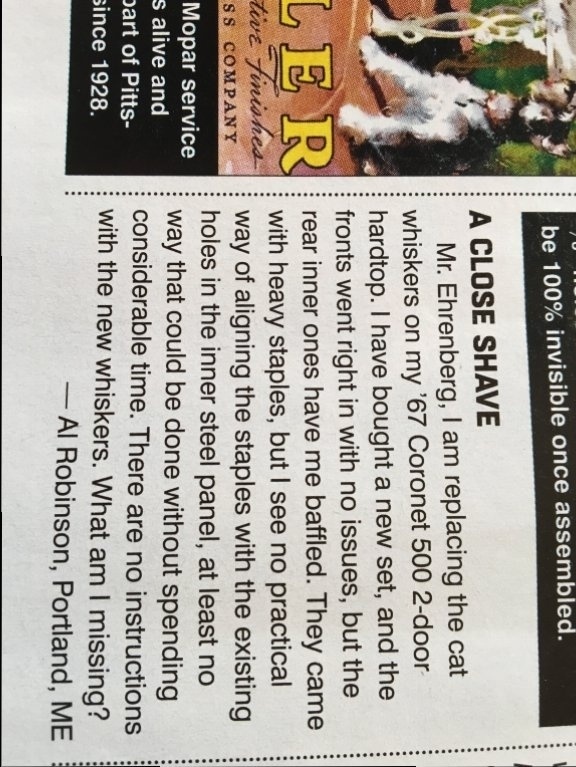

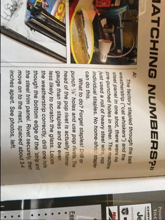

This months Mopar Action has a Q&A in their tech section about this same problem. August 2016 edition.
Do you have that issue? Can you send me a pic of the article? Thanks.
Here is the article.
Not sure how to spin them...tilt your head?
Right on man. I read it just fine, that makes sense now. I will have to pull off the metal on top and drill holes and screw on. Kind of a pain but it's gotta be done! Thanks again for the sharp eye on the article man!
