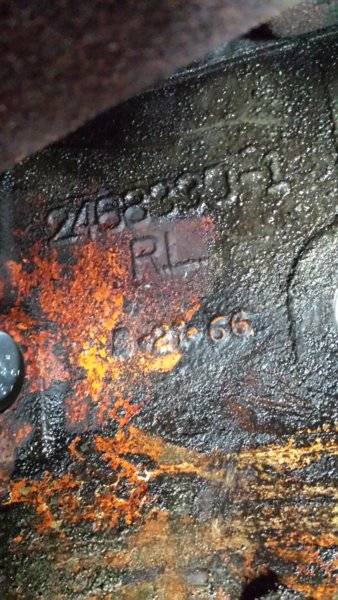

OK Thanks. Can anyone tell me where the casting no.s are located on the block?
Driver's side about even with the freeze plugs. This picture was taken with the engine in the car, so you can see it if you get under there. Hard to tell in the pic but my first number is 3 (March).

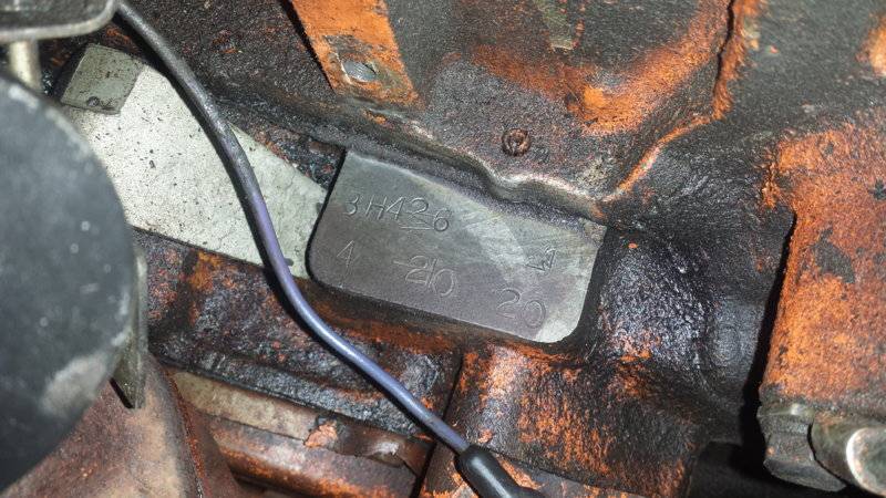

Where on the block is this pad?
The stamp pad is right on top in front of the intake manifold - driver's side of the center. On mine, the coil obstructs it somewhat. This picture was taken with the coil moved out of the way.
I'm not expert on reading pads BH is for 66 engine the 4 20 think assembly date April 20th. Note his cast date in post #4 3-21-66 is a month before engine assembly date.
