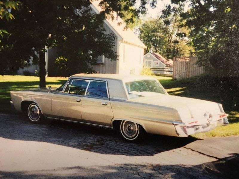

Twin post on my '66 Imperial, unrestored in 1996.
